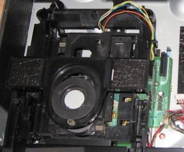

Sorry, i'm being dense. Where on the mech do you put the coin? I presume the extra weight damps the mechanism?
If the mechanism is a cdm12.* (is says on a label at the rear), In the clamping mechanism, there is a small magnetic disc visible on top. A 10p fits nicely on there with a bit of glue. Marantz actually did a service mod. on early models to cure some vibration issues.
On the picture, you can also see some damping material.

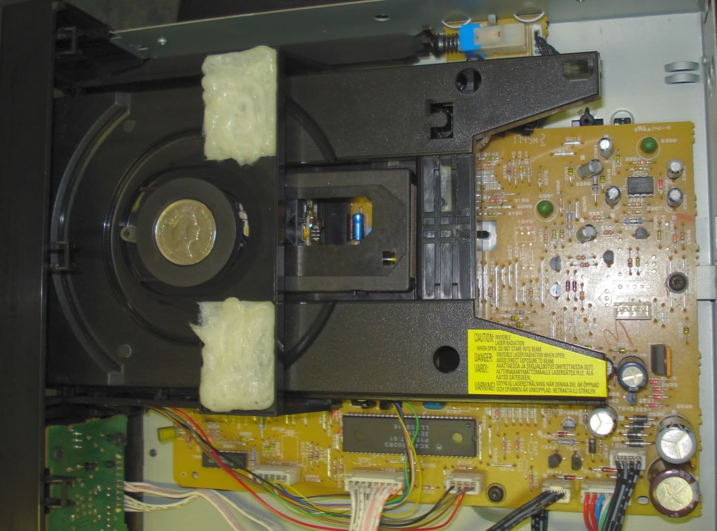

Well, I have had the top off and taken some pics, the problem is I couldn't find any op-amps! I fairly new to electronics but still, I expected to be able to spot an OpAmp at 100 yards. None of the components even vaguely resembled an opAmp.
I'll post a photo of the circuit later. It turned out it was the Philips transport earlier suggested as well.
For those interested, here is the main board in my CD-36. No other boards other than those with display/buttons on were present, and the only other item inside the case was the transformer. I can only see one item that looks op-amp-ish, but I'm not even convinced about that, especially as there is only one of them.
Sorry about the limited detail but photobucket wouldn't let me host it at full size, and I am also aware this is quite a big picture for a forum but I figured you needed to be able to recognise the components!
The opamp is the 8-pin black beastie in the top right of the photo.
I would guess that my previous guess at the DAC chip is accurate unless you want to dismantle it and look out the chip numbers??
As such it is not really worth spending too much on.
some of the car panel damping mentioned earlier would probably the limit
Andy
If that 4560 -- which is a dual OpAmp, ( it's a bit like a 4558 ) arghhh but with a bit more umpty for driving low impedances is the output buffer then it's worth swapping.
Can you trace from pins 1 and 7 which will be the left and right outputs if we are correct, back to the output sockets -- please tell me it has sockets, not captive leads 🙂 There will probably be a series cap on route and possibly a resistor or two.

This is what I would do. And it's not a duffer at all 🙂 See if the 4560 really is an output buffer- it looks to be though, I can see "pairs" of similar parts round about. Without pulling it apart you can do that by playing a CD at LOW volume and touch pin's 2 and 3 alternately with a metallic object eg screwdriver. One channel should click or buzz. Pins 5 and 6 for other channel.
If it does I would try a TL072 OpAmp ( or even a TL082 - same but slightly higher noise figure - you almost certainly wouldn't hear the difference here ) from Maplin. Sonically they are excellent -- yes there are better but the TL072 is ideal for this and costs around £0.60 or so. Should be a noticeable improvement. You can always fit an 8 DIL socket so you can try others easily as well.
