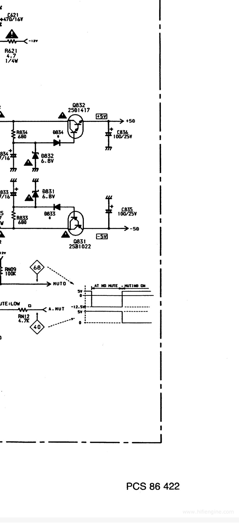

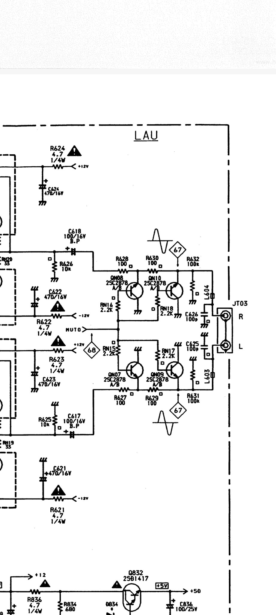

Checked the muting "signal" when the CD Is playing and It Is -11.5 volt. I read that 2sc2878 transistors used as Muting, could easily get destroyed/damage under certain conditions. It Is possibile that despite the signal NO MUTE (-11.5 V) the transistors (2sc2878) perhaps damage conduct a part of the sound to ground and therefore the output Is low ? Where could the fault be ? I don't have and oscilloscope. Sorry for my bad English. Thanks in advance tò anyone Who wants to help me. I am attach the cicuit diagram of the muting marantz CD 17. Hi Giorgio
