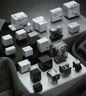

Hi, I have a 70's Marantz 2270 stereo receiver. Nice lil amp, but the right channel is a little fuzzy. I've found some info online about possible corrosion of the soft start relay contacts. Unfortuantely, I don't have a service manual for this amp, and I'm not sure where the relay is or what exactly it looks like. Can anyone help?

Attached is a picture of different kind of relays.
Do a search on google images and you'll find much more of these (nasty 🙂) devices
