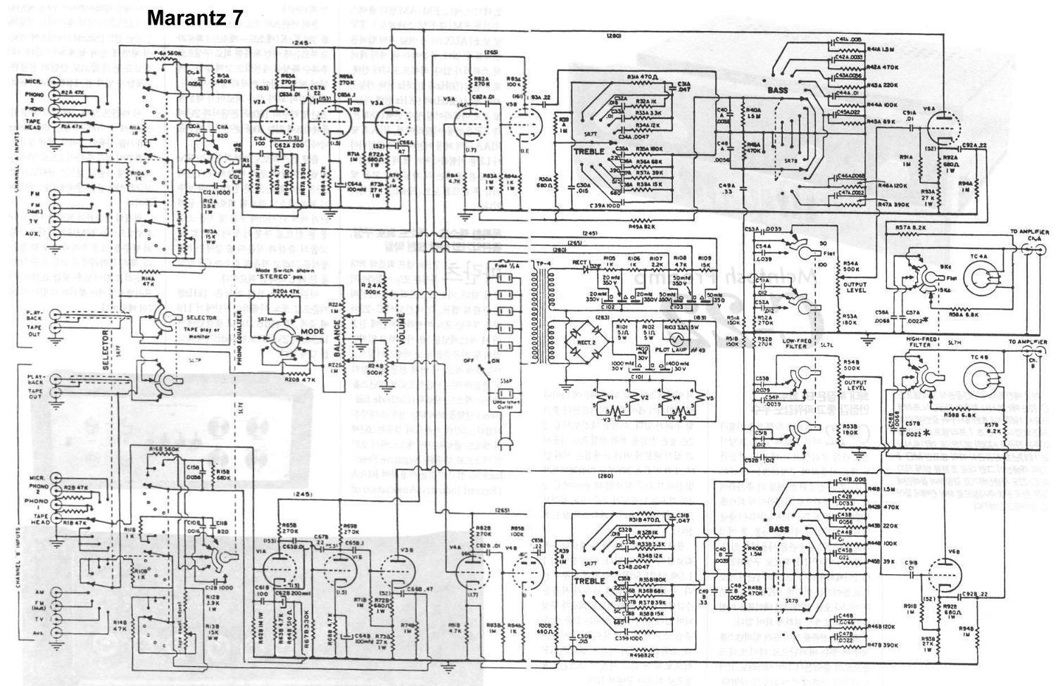

- to arrive at a close approximation of C7's "sound" - - study its power supply.
Half wave rectification, daisy chained RC filtering. Relatively "high" output impedance vs modern concerns of low Z and tight regulation.

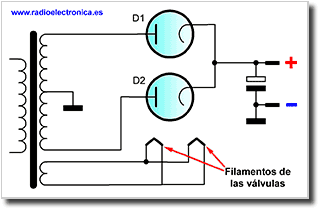

Hi freddi
I'm confused here ......
Full-wave rectification (with diodes) is seen in the full circuit attachment
And in the attachment with the description in Japanese ( link ), I also see full wave rectification, in this case with thermionic valves ... (double triode)
The first models were half wave? .....
