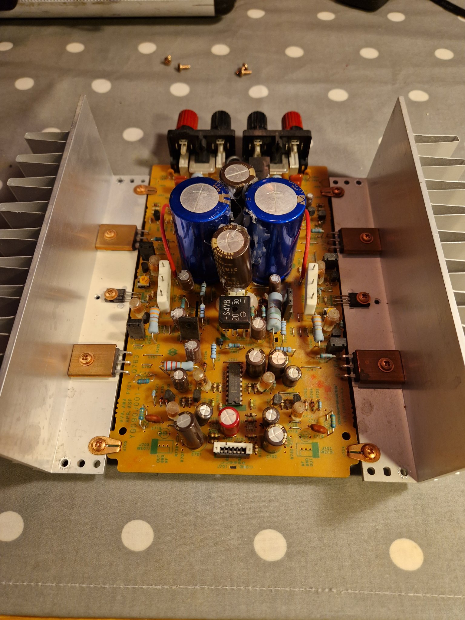

Looking for some advice recapping my Marantz 6010 OSE KI amplifier
The caps (C801 and C802) look like they're starting to bulge ever so slightly (no sound quality issues that I have noticed)

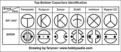

The cap part number doesn't bring anything up sarching in google - 12000μF 56V S56V12000UPM20B (I think they're Elna)
In the KI version there are caps in parrallel with these - 1000uf 50v but these look ok.
Any advice appreciated.

They are Elna

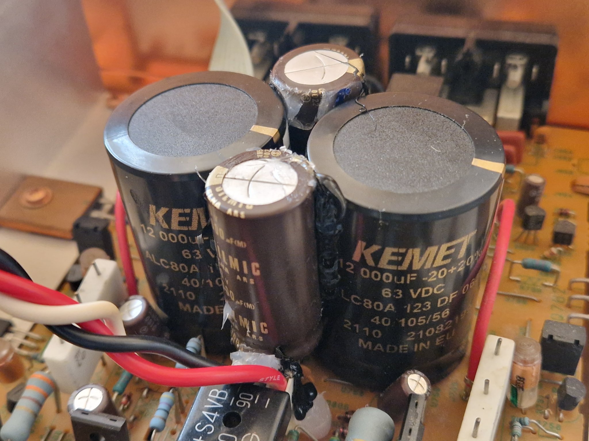

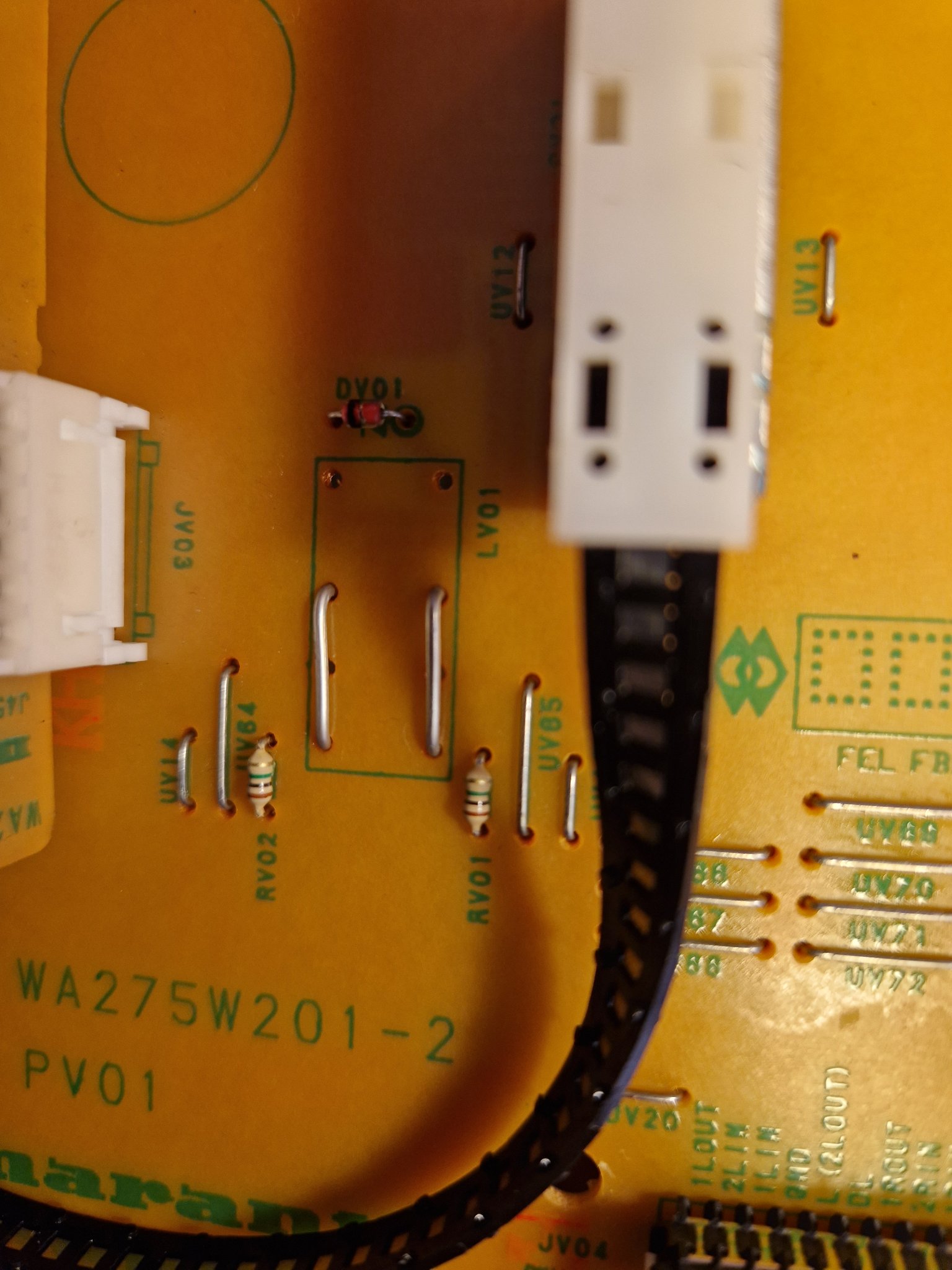

Finaly got around to replacing the power caps with Kemet alc80a123df063 and whilst I was at it I removed and bypassed the source/direct relay (component LV01).
Next job at some point will be to bypass the source/direct switch.
