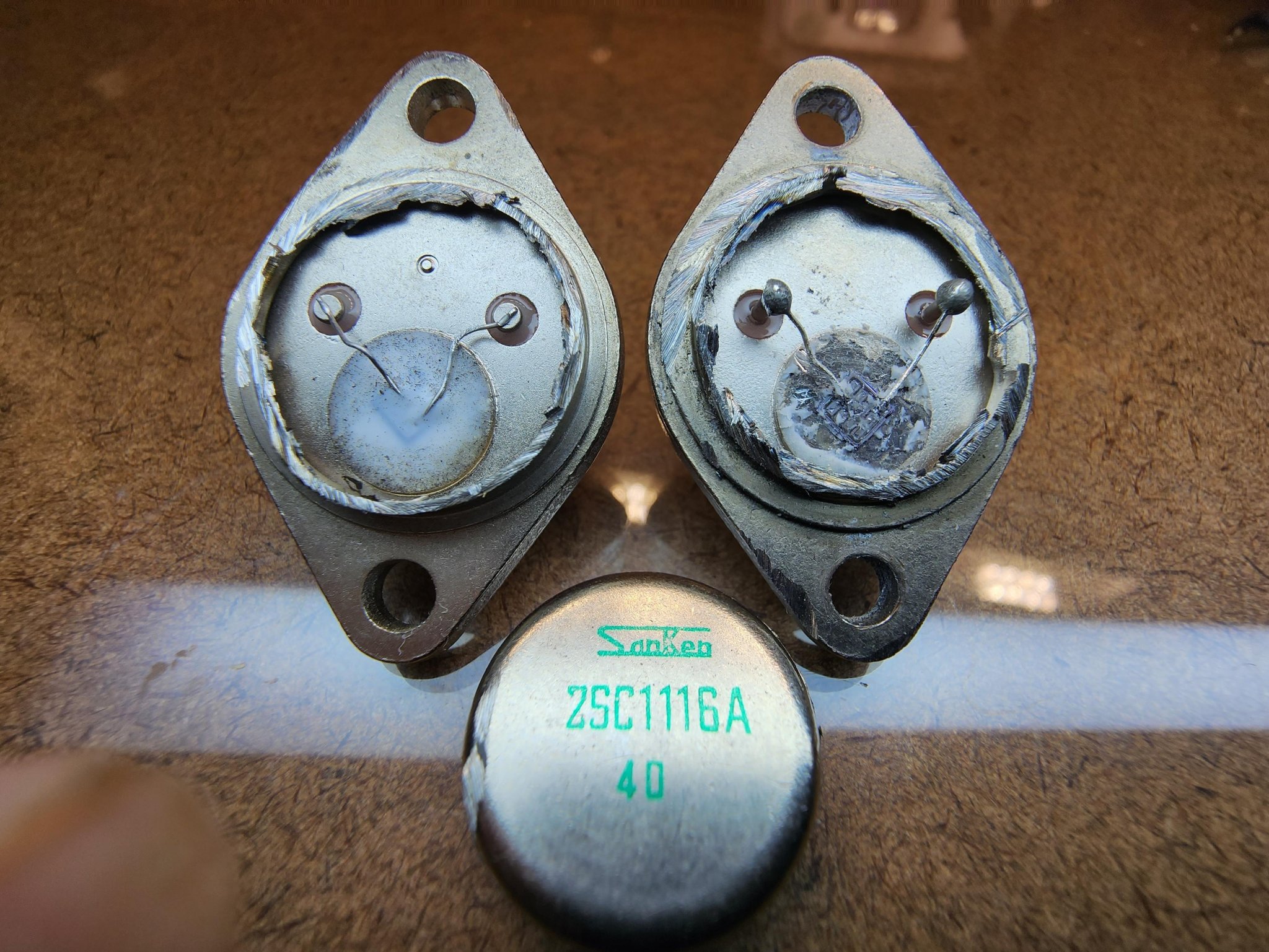

Yep!! Mr. Dremel and I did some 2SC1116 can opening earlier - will post pics tomorrow!!
They are labelled as Sankens (NOT!!). How the heck do you know you are not getting a knock-off anything nowadays?

Using the +/- 32 VDC current limited bench supply, each rail draws about 300 mA of current. Using it as a voltage amp with no load, I get 30 dB of gain and low THD of around .02% on my Tektronix SG505/AA501 test set. With this PS, it clips at 20 V RMS - 28 VP-P / about 50 watts RMS into 8 ohms (if I had a load connected)- sounds about right. This is with the 2SA707A/2SC1116A "questionable Chinese" BJT's. See attached teardown of 2 of the 2SC1116A's
Those actually don’t look fake. like I said, you might have gotten lucky. But, just because the NPNs are real doesn’t guarantee the PNPs are, either. Both would need to be tested.
Testing the whole amp board unloaded won’t necessarily tell you anything. You would have gotten the same result with “2N3055-inside” fakes. Full voltage, under load, poof. Why I suggested an SOA test on just the devices themselves. A junker will blow out if subjected to 50 volts at 4 amps - pretty much instantly. Real ones will take it as long as the case can be kept cool.
I didn't expect this no load test to tell me anything except that all the devices and circuit are operating in their linear ranges, which it does. I am just not set up right now to do a separate load test on the devices themselves - so I am going to go for it and run the amp into a non-inductive 8 or 4 ohm load (which I have), while monitoring things closely. I have replaced the 2 big 15mF 70V filter caps and all the caps on the PS Board too, BTW all the caps I have removed and replaced test good with low ESR's.
