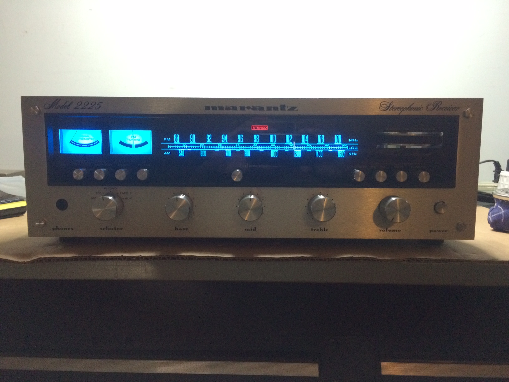

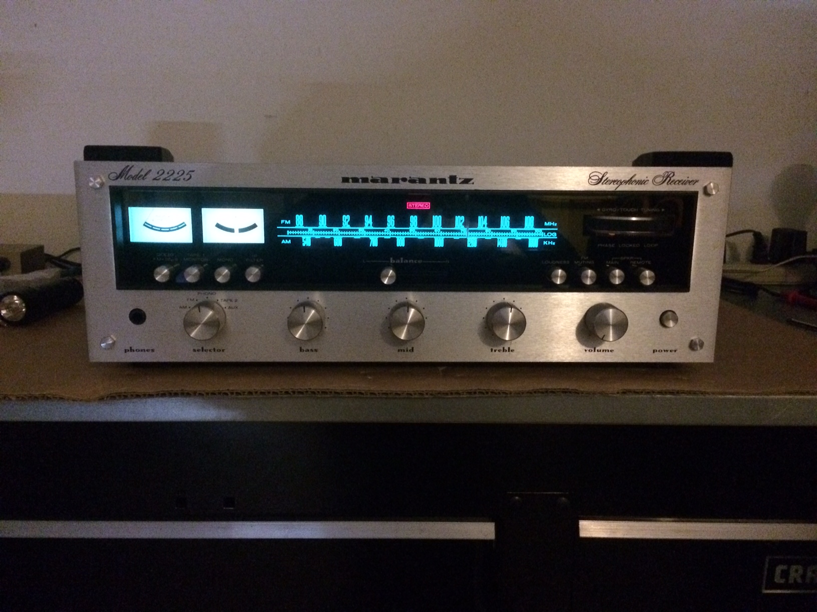

I picked up a nice, clean 2225 last month off CL and it plays/sounds great. Last night I replaced the dial and meter bulbs with blue LEDs from Parts Express. And that results turned out really nice. See before and after pix.
