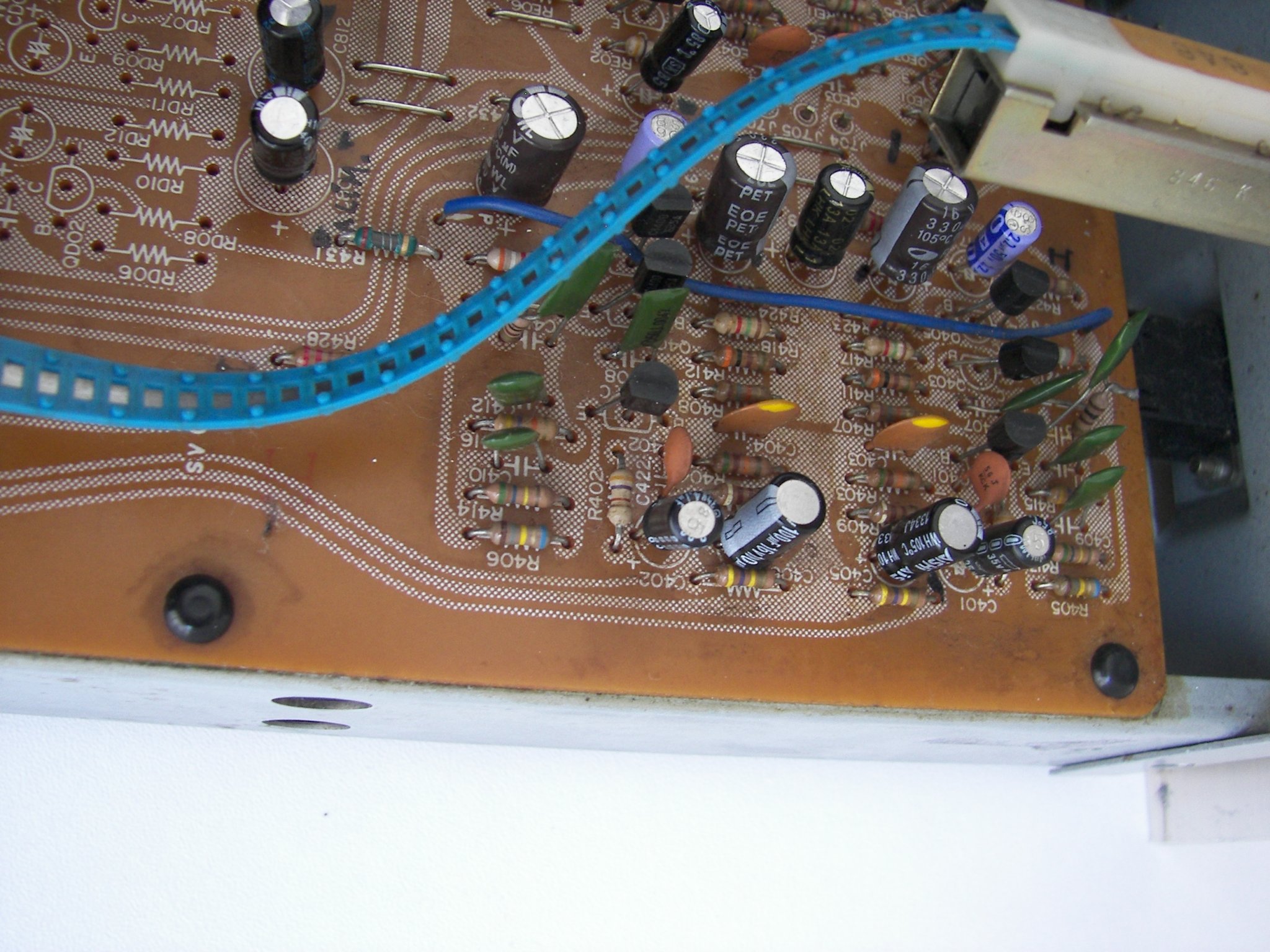

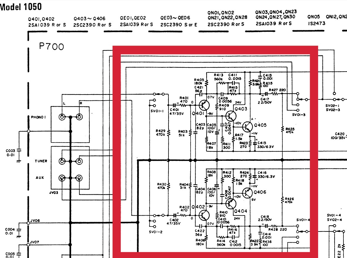

Problem solved 🙂. Those 24V. from the amplifier power supply are poorly filtered or their characteristics have been lost. I have connected the phono preamp to an external 12V power supply and it sounds wonderful, but with the main cord of the amplifier grounded. Now I only have to connect a power supply inside the amp only for the phono preamp. I don't even bother looking for the cause of the bad filtering of those 24 V.
Reactions: Bigun

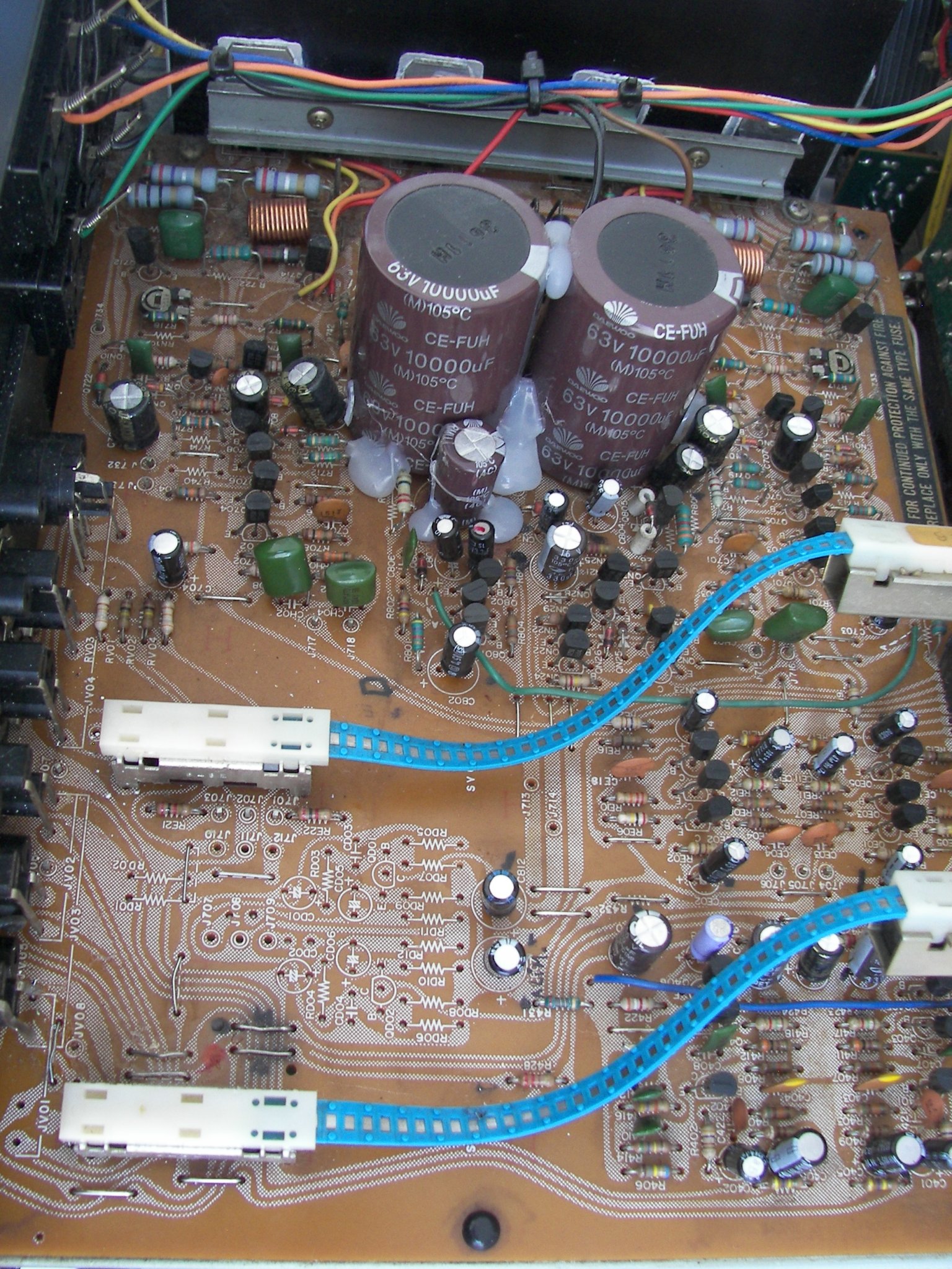

Final assembly. Disconnected R431 (24V amp. to phono stage) and installed a new 12V power supply inside amplifier, near main transformer.
