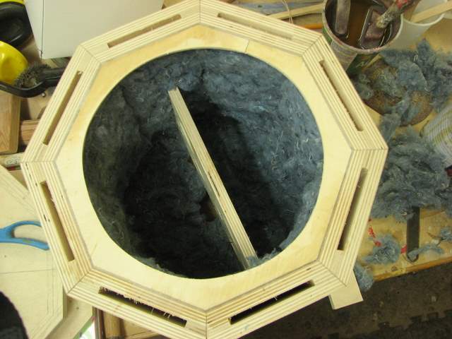

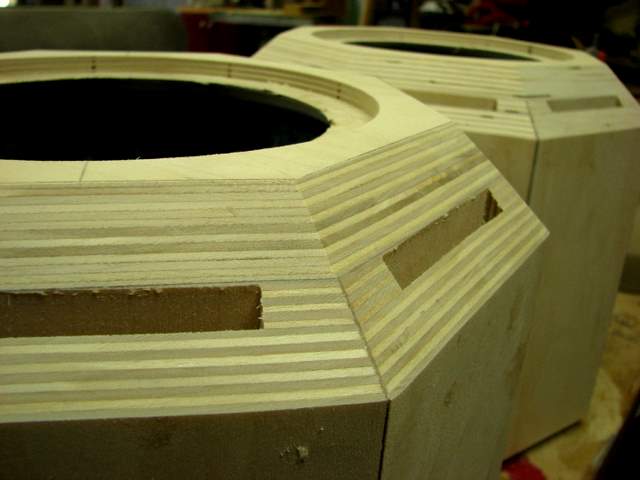

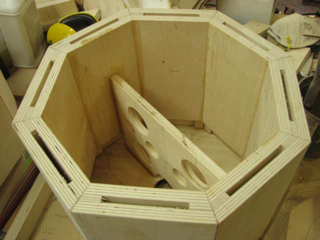

A quick question about this cabinet. For the damping/lining on the back panel. Does it go all of the way to the wall? or does it stop short in order to not block the vent?
don't occlude the vents
Thanks, Chris. I know to not block the vents. Very important!
However, the lining is supposed to be about 1/2" thick and there is much more than this distance from the back panel to the vent itself.
It may not be a big issue in the end, but it won't be easy to change later.

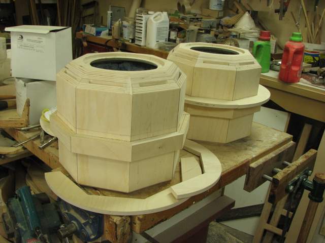

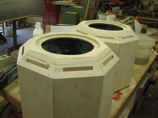

Lining and holey brace are in!

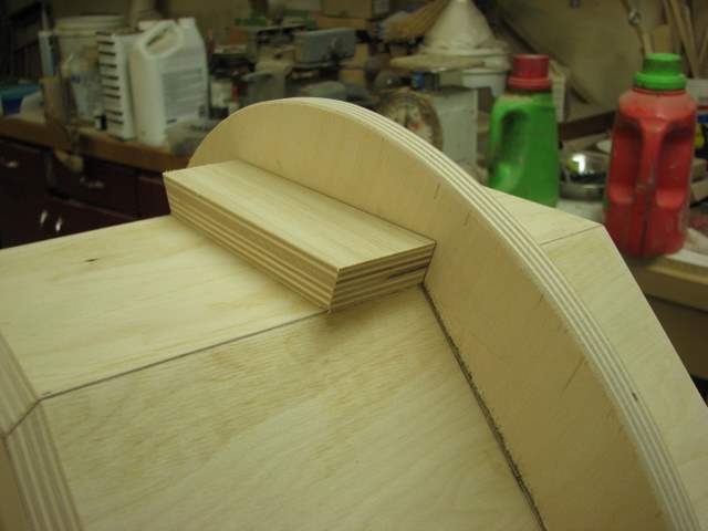

One small change to the plans that I did do was to add a small flange that sits just inside of the front edge of the sides. This provides more attachment surface for the front baffle, as half of the front baffle is removed here by the bevel I thought that some added stiffness couldn't hurt. It is significantly beveled to the back, so really, this flange just fills the corner between the front baffle and the sides.

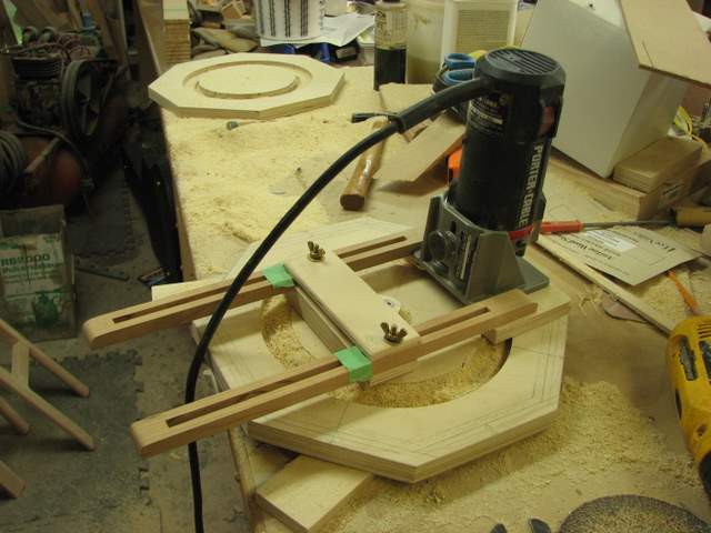

I prepared the front baffles to receive the drivers and got the glued on. I'll show some photos of that stage once I get some new photos. But I do have a shot of the circle gutting rig for my router.
Nicely done, Douglas!
I really enjoy seeing pics where the approach includes home-made jigs & lots of sawdust. I can relate!

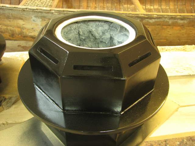

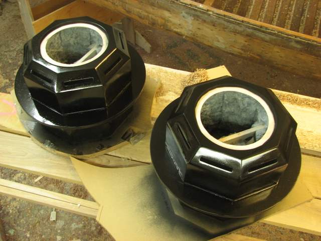

Got the flange on for mounting the cabinets in the globes, sanded everything nice and smooth, and got the first two coats of spray paint on. I'll be continuing to build the finish over the next few days.
I gotta say, they're looking kind of cool.
forgive the question if this has already been mentioned, but what type of product(s) and prep etc were used in the painting?
Chris,
I sanded the top portion, above the flange, to 220, then gave it a coat of epoxy to seal the wood grain. I used EAST System epoxy, but any brand like WEST, MAS, RAKA, etc would work fine.
After the epoxy cured I sanded it down to 220 and shot on a couple coats of rattle can spray paint. This will then be sanded smooth and repeated till I am satsified. The bottom section, below the flange, is just getting a couple coats of spray paint that will be declared good enough.

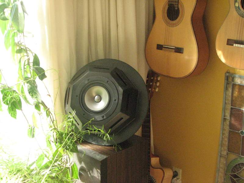

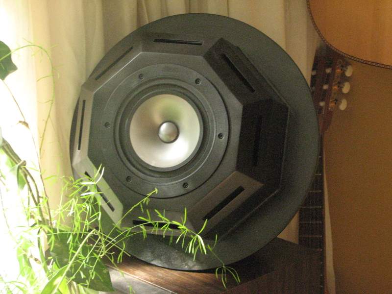

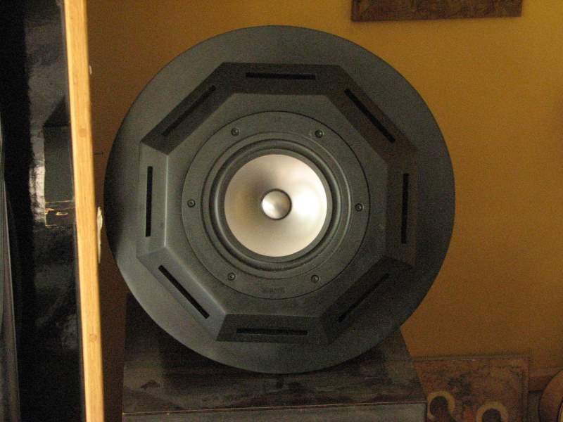

I am declaring these cabinets finished. I worked through the finishing process, refining the surfaces with each stage. In the end, I decided that I preferred the look of the paint rubbed out with 0000 steel wool, which gives a nice satin look. The high gloss was too glossy, and showed up every single imperfection!
The end result keeps reminding me of the Death Star from Star Wars. It is a very singular look.
I moved my Alpair drivers over to these last night and got them fired up. While the sound very good, there is a definite difference from the Pensil series Studio Reference Monitors which now sit forlorn and vacant.
First impressions are in line with what Dave had already indicated, that these new cabs don't have the bass extension of the Pensils, favouring bass precision over extension. The bass is there, just different. They also have a different sense of "air", or space, about them. I'm going to have to live with them for awhile to get a better read. I've been listening to the Pensils for quite awhile now and they have become my "normal".
