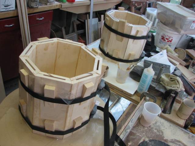

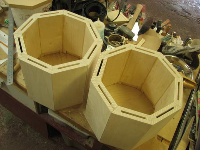

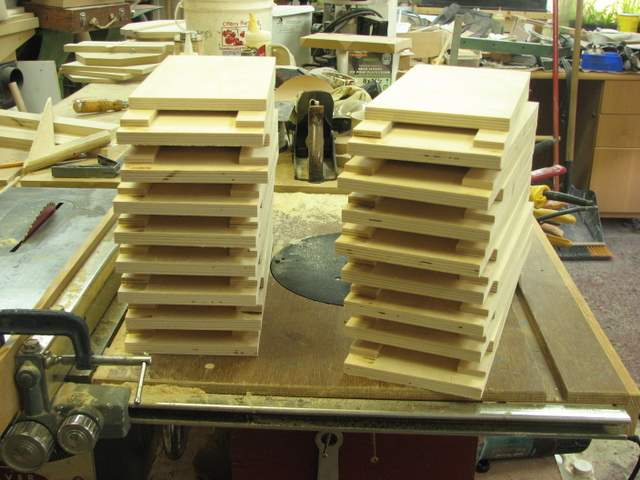

I'm looking forward very much to getting my Mar-Ken12's built! But they will be octagonal and hidden inside an 18" diameter globe. Oh, well...Drew them up full scale a couple of days ago and started making the mold for the globes.
Glad to know that they sound good. As long as they sound as good as my present Studio Reference Monitors I'll be happy.
Progress so far on my octagonal Mar-Ken 12s.
messy work area - I like it!
nice work Douglas
nice work Douglas
Thanks!
Beware a too clean shop...nothing is happening there.
