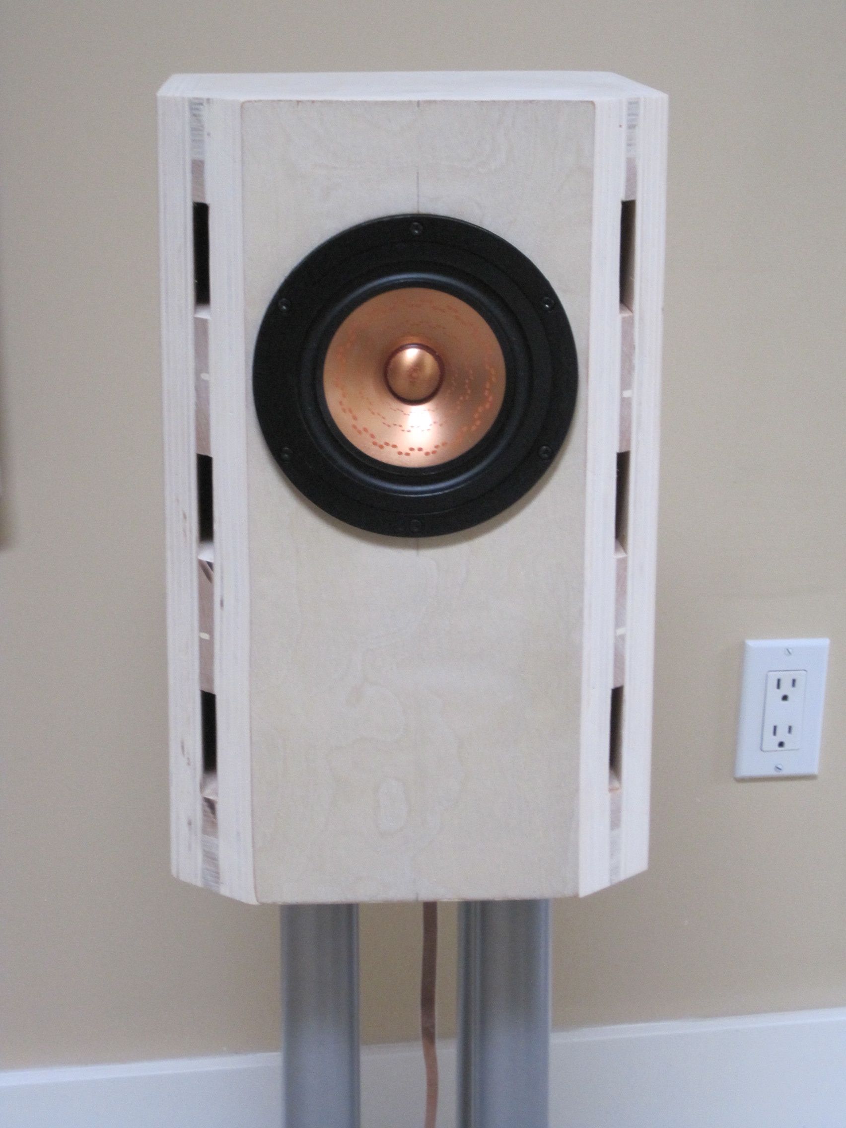

Mar-Ken's up and running.
Just had to give 'em a go prior to veneering--
They offer much promise, with a "weight & authority" that is hinted at, even at low volume.

I've not heard any miniOnken vrs Pensil comparos. We do have Pwnsil7 & dMar-Ken7 to do so sometime. Even when i do hear i don't know that i'll comment. As one of the designers it is not my place.
The 2 families have quite different design briefs. Pensil is designed to give good end-to-end performance & be simple to build.
miniOnken are targeted at extracting the maximum downward dynamic range (DDR), and to stay true to the maxim that most of the music is in the midrange.

Thank you to all who have offered some insight into the potential differences between these two cabinet designs.
Dave, I appreciate your position and admire you for it 🙂 Is it possible to give an estimate as to what the F6 or even F10 would be for the MarKen, please? I realise there are many factors at play here, not least the room. If you were to say somewhere in the 50's though, my mind would be make up 😉
By the grace of God or the Power of Greyskull, don't know which, I tracked down some Baltic Birch ply with a healthy count of 11 layers. I had to settle on 16mm as the 18mm didn't have the grain running the length but width of the board :/ All the same, I'm very happy to be able to try some nice ply instead of mdf... It's very easy to work but bloody horrible stuff. Besides, Birch is quite a lovely grain and colour.
Oh yeah, the plans suggest 18mm, I'm hoping 16 is ok.
I have to estimate from the sims i have. F3 somewhere under 60 Hz, F6 about 44 Hz, F10 gets another 10 Hz.
I had to settle on 16mm as the 18mm didn't have the grain running the length but width of the board...
A plan-set for you would include 16mm drawings. Baffle may be a tad thin, have to see, and if you can get A10.2 with the bezel cover loose, life would be easier (in NA they come loose -- at least all the ones i have)
dave
Jumping in...although I think I see the answer...what is the problem with the bezel covers? I don't think it's been specifically stated, and (although I didn't call) Madisound doesn't provide an option.
Formost the bezel covers create an annular ridge around the driver. Without the bezel cover the driver to baffle transition is essentially flat.
From a practical pov the bezel cover means that you need a wider, thicker baffle. On the Mar-Ken10.2 it can get dicey fitting the driver on the baffle without it sticking out.
Alpair 10.2 and some grey Alpair12 are/have been available from Madisound with loose bezel covers (you just hve to ask).
dave

And I thought why is the cover loose?
Dave,
If you recall I was struggling to get required depth for flush mounting my Alp 12s... my drivers were bought from Madisound and one of the boxes had "loose cover" written on it. It bothered me... why should the cover be loose? Now I know it's an option...
I still have around 1-1.5 mm of the driver (with cover) which is proud of the front baffle - easiest way to solve the problem is to the loose the cover? Here the cabs are Super Pensils.

You can only loose the bezel covers, if both drivers have loose ones, there is no-way to remove them once glued on.
dave
dave
dave
Oh... the other one had nothing written on the box - so not sure. Now both are fixed in the break in boxes so can't check now.
For final fixing if I decided to keep the bezel covers on, do I need to glue down the loose one? After turning the screws things look nice and tight.
-Zia
Yes the bezel cover needs gluing -- the screws do not hold it down (it is a tight fit thou -- care must be taken removing it). I used some spots of 5min epoxy (on a copper one that was not supposed to have a removable bezel cover -- gave me quite a fright when i 1st looked at it, as the holes were not aligned and i thot i was going to have to send it back).
