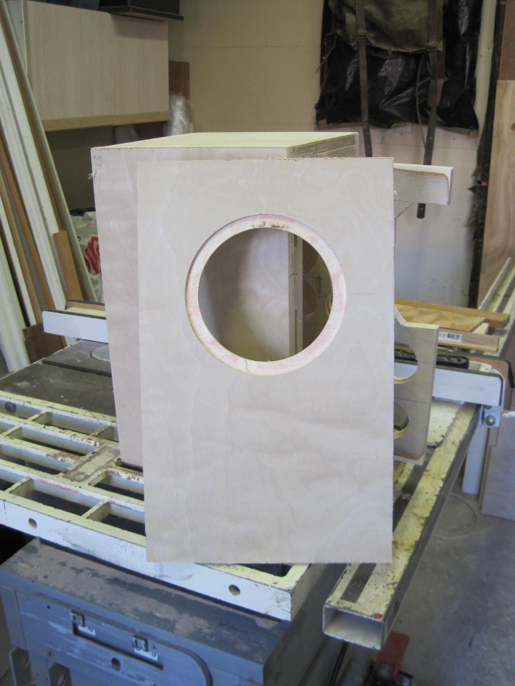

Hi grimmrok:
I'm currently doing a pair of Mar-ken cabs for some MA 10.2 eNA's.
I've not heard the driver in either cab, but that said, I love the results in it's smaller version, the Chr-Ken (chr70eNA).
I may do a pair of Pensil boxes as well, just to compare.
However, the Mar-Ken takes up less real estate which is a factor around here!

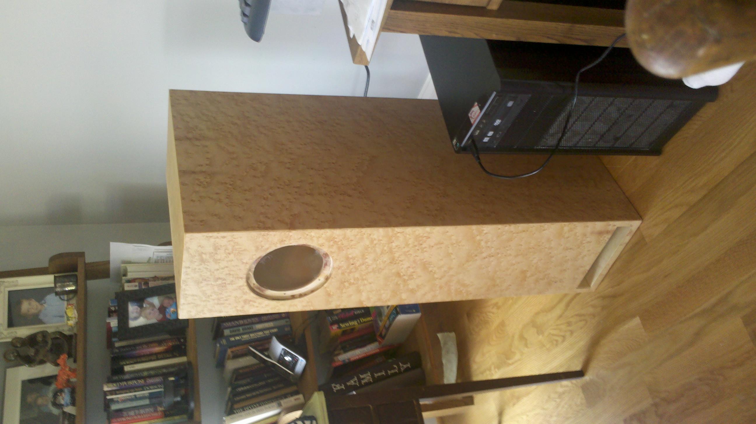

total cubic volume perhaps - but unless on a bookshelf, by the time you count the stands, how much greater is the foot-print of a floorstander? rhetorical question - answer is - often less
and a lot of builders could have a pair of Pensils finished in much less time than any of the prime -"Kens"
My impression, from a practical/build standpoint of a very novice woodworker, is that the *ken style designs are easier to modify to fit various size and shape requirements, but they're not so easy to build right unless you have access to some expensive tooling. The Pensil designs are really easy to build, but they can't really be modified.

Mar-Kens coming--View attachment 219900
Don
About the sound...wait a few weeks...I've got 20 A10.2 drivers waiting for their new homes.
Well, to elicit the best performance from each driver in the *kens takes more than simply changing the enclosure volume and driver cut-out - (i.e. care with vent tuning / aspect ratio to retain the intended near aperiodic resistive load).
and yup, it's very handy to have access to CNC router for rebated driver mounts, and big a$$ table saws to cut those chamfers after assembly.
The Pensils are absolutely an easier build - it'll likely take longer to veneer/paint/finish a pair than to build, but a few minutes listening to the *kens should tell whether what I think I've been hearing the latter doing that makes them worth the effort is just imaginary.
