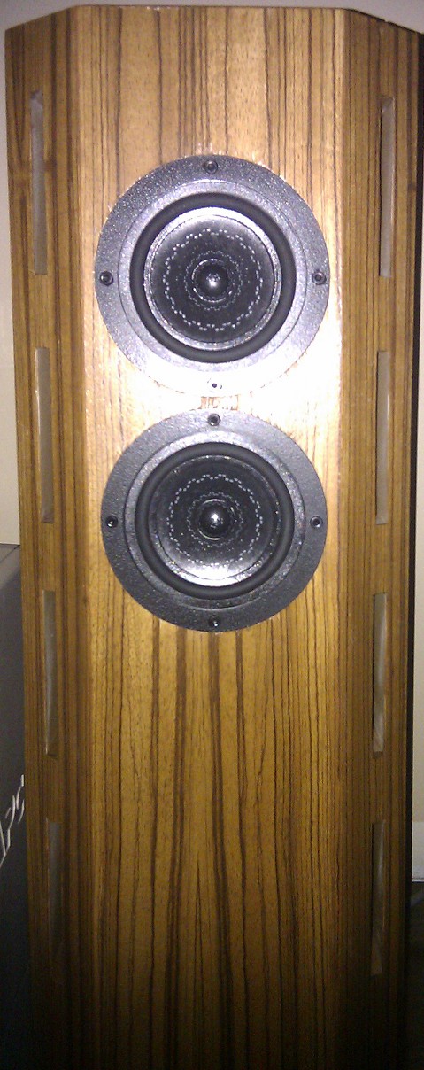

As mentioned yesterday, here is a picture of the finished speaker. For a first time project for speaker building, cabinetry, working with veneer, and not having done a lot of woodworking before, the results aren't terrible.
Lerg, nice job with finish! Speaker looks nice.

Well, what I have is a bit more of a honey colour, Zebrawood veneer with wood conditioner and fruitwood stain from Varathane. The top coat is a few coats of the water based satin clear coat form Varathane, the diamond finish. They don't look bad, but they aren't perfect, and I still have to build grills for them. Had I known how dark the Zebrawood would look after finishing I would have done another coat of stain on the interior to darken it up a bit more.
If I get a chance to disconnect them and take a few more pictures I will post them.
If you look closely to the left of the bottom driver, the corner is missing a bit of wood, between my inexperience and the seemingly fickle nature veneer, a couple small chunks of wood escaped on those bevels. Next time I will have to work on construction and finishing, not sure when I will attempt something else though.

yes, trimming out the veneer around the port slots is almost the trickiest part of the finishing process - well at least the most nerve wracking - if you rush it and mess up too badly, you need to strip the veneer and start all over again.
(how would he know?)
if there is a next time I'd suggest finishing the interior surfaces of port slots during assembly of the outer wall "sandwich"
nice job
I did the finishing of the interior surfaces before doing initial construction. If you shine a light in the port slots you will see that it is stained front to back, even the back panel is stained, there shouldn't be a single bit of unfinished surface visible from the outside. I was tempted to paint them black, but I wasn't sure that it would look right, so it was stained with the same color as the interior.
Basically, the veneer took the stain a bit darker than the actual Zebrawood that I had that I was testing finishes on.
I used a sharp knife for trimming the port slots, if I spent a bit more time doing it I wouldn't have shaved a slight bit of stained wood by the very front of the slots.
Either way, for a novice/beginner, the final finishing is a huge pain with veneer with those front bevels and port slots.

No slight intended - the veneer trimming on these boxes is a PITA detail job for anyone - nice work
No slight taken, I just know that due to a combination of the flash, the camera and the colour of the veneer it isn't obvious that the vents are stained completely.
I will admit that the next time I do something like this I am not looking forward to trimming veneer again.
I don't really take credit for them looking nice though, all of the credit for that goes to the Zebrawood and its interesting grain pattern.
