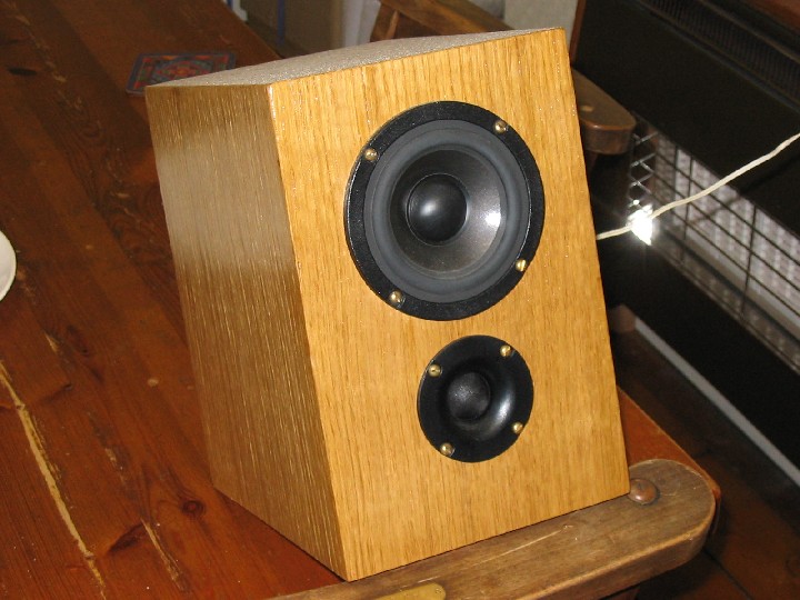

The are great little drivers! I use them in my computer speakers (around 3 liters sealed, active XO at 120Hz). They have good detail resolution and easy to work with, too.
I bought two (for £15 each - humph!) and the TS parameters I measured, using SpeakerWorkshop, were not too close to what Audax specify. I never determined if this due to my measurement error, a SW software error or Audax manufacturing error! Some details:

Great pictures you two!

Nice work Mr Element!
I originally planned to use that tweeter (actually the version with the truncated faceplate). I proceded to design and build the box only to find that... Maplin had discontinued it! The round facelate version was slightly too large so I re-used the 10mm dome tweets from another project. It means I have to run the AP100Z0 fairly high but the result is still quite impressive.

I use SW for all my speaker tweaking needs. The box underneath the speaker in my pic is the mic preamp/power amp. Cost about £20 to make, and the software is free.
