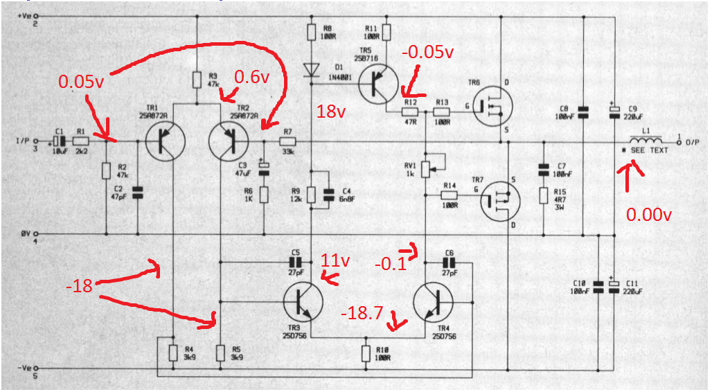

I have had a pair of GA28F boards that have worked well until I decided that after 30 years+ they needed an upgrade (when will I learn?)....
Upshot is that now one of them has a voltage across the speaker output that slowly rises toward VCC (using +-/- 19V to test). The other has 11mV on the speaker output but there is no current when adjusting RV1.
Is anyone familiar with these and can offer some support/help/suggestions on how to get them back working?
The are not blowing the 200mA fuses put in to test, so that's something. The K134's both switch in circuit using a DMM in diode mode to test, but that's not the perfect test. There are no shorts from the transistor cans to the heatsink.
I replaced all the electrolytic caps (all the right way round🙂 ..). Also replaced the gate stoppers, R15 and RV1 as the old ones were open type and the track was very 'jumpy' when adjusting, that was when I lost current to one of them and to add to the issue I forgot to detach the speakers before adjusting 😱 , so that might help tell what's going on here.
So, hoping the season of goodwill prevails and that someone might be able to help before New Years Eve....Please help if you can.

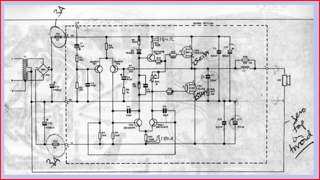

Schematic found here:
maplin 100w 150w mosfet amp ga28f Download page :: Schematics Unlimited
and another:
http://www.eastmarinedrive.com/contents/non-static/audiodgoodman-content.htm
If R15 in the zobel network gets hot, it is likely that the amplifier is oscillating. Stability is reportedly improved by increasing the gate resistors R13 & R14 to 220 or 270 ohms.
LOL I bagged myself a lot of these modules whist they were going for nothing on ebay a few years ago. Delightfully simple and effective, but need more output devices or doubled "-D" types for bridging and/or reasonable 4 ohm efficiency....however I wander slightly off topic.
Mr. Mosfet Madness, I do not see any list or schematic of the "upgrades" you have performed, can you enlighten us?
Mooley, your schematic contains some resistor value modifications, just curiosity - was that to maintain correct operation at higher voltages, it appears to make the values 3 times larger?
I've been studying the circuit and I suspect that the module with non adjustable current but low DC offset may well be OK. The current is hugely dependent on supply voltage and so running on -/+19 volts will indeed give no quiescent current in the outputs.
Important, for testing this module I would use full supply voltage but with the safety net of a bulb tester in the mains primary. Also begin with the preset on minimum resistance as that give minimum current.
I've no idea tbh, I've never built the amp. The circuit was just the one I had on my PC from years ago.
Someone had drawn the 180 ohm in at the top/bottom. Are any others different ?

R9, assuming say -/+45 volt supplies then that resistor sees around 60 volts across it. It needs to be at least 0.5 watt rating, preferably a 1 watt.
There should be no issues with any of the other mods you list.
The 19 volt test supply will not allow for any adjustment of current... I say none, you might see a few milliamps but no more. So as it stands this module could be all OK. You need to reset the preset back to zero ohms and test on full supply (with the bulb tester I mentioned... just solder a 100 watt mains filament bulb in series with the tranny primary).
Module 2. You should be seeing around 0.7 volts across D1 + R8. Make absolutely sure you have the FET's in correctly (not reversed 😀) and that there is continuity from the FET pins to the correct points on the board.
You can't really test resistors in circuit and the wildly different readings between modules don't ring any alarm bells at this stage.
Running this module on -/+19 volts you should see around these voltages give or take. We know your output settles at Vcc. How do the other voltages compare ? We are looking for a huge discrepancy that would point to a fault semiconductor (or other problem).

OK - Light bulb tester made and one module tested.
This is 'red dot' module as I have marked it to avoid confusion!
+/- 44.5V supplied to module, 200mA A/S fuses OK.
24mV across speaker output and ground OK.
turning RV1 results in no current increase (previously it was at 1/4 turn), no reading on a 300mA scale.
Tr4 has 44V approx across it.
D1/R8 has 0.66V
