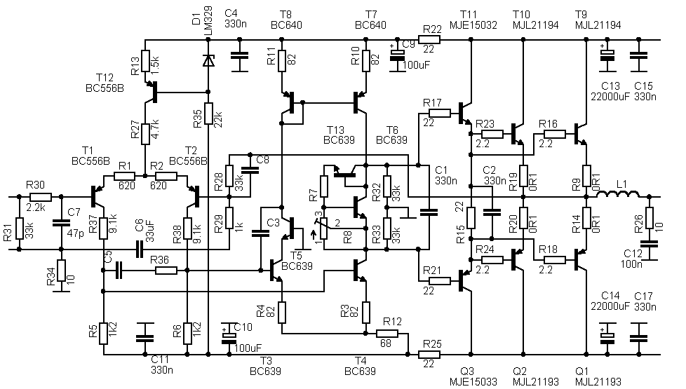

C9(47uF) forms an RC filter together with R14(33 Ohm).Hi all.
Someone could explain the function of C9. Improves sound?
This stops ripple and hum on negative rail to reach frontend of amp.
So, it keeps disturbance from power supply to get into the operation.

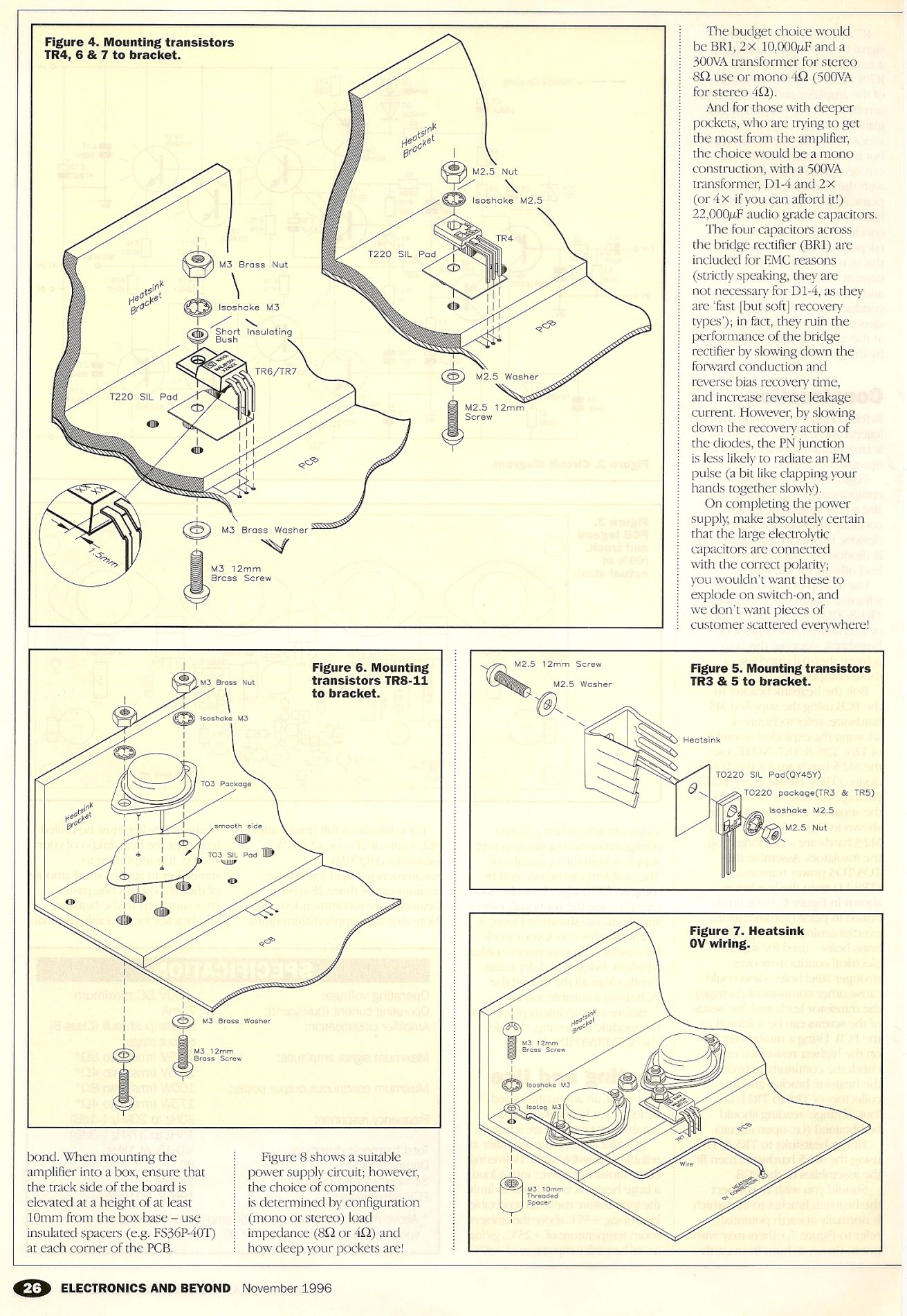

Here are the pages from the magazine article. Note, these are for the later (mk2) version of the amplifier. The original had a lot of wiring between the heatsink and the circuit board, as well as you had to drill the heatsink yourself. This version substitutes an L-shaped metal bracket similar to what the 50w bipolar and 150w MOSFET amps used.
