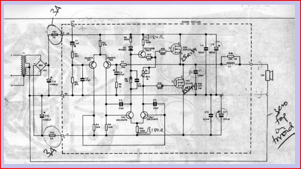

Other stability suggestions I have seen are that R15 (that's part the snubber?) should not be non-inductive so not wirewound; bypass R7 with 6.8nF; and C5 and C6 can be increased to 100pF
Be careful what you do.
Yes, the resistor the coil is wound around should be non inductive. A 10ohm 2 watt carbon or metal film is OK.
Bypassing R7 ? which circuit are you looking at ? Mine and the redrawn one you linked to have R6 and R7 reversed. Adding a 6.8nf across either would be a disaster. Across the 1k and the gain at hf would rise dramatically, across the 33k and the amp would probably self destruct as it would cause instability. Are you sure it wasn't 6.8 pf (pico) across the 33k ? That might help with stability issues but shouldn't as a matter of course be needed.
Changing the 27pf's to 100pf is an unknown, I wouldn't like to say without trying it for real and seeing what the effect was on a scope stability wise. I would leave them as they are for now.
I'm a wimp, remember 🙂. I won't attempt anything that doesn't have a clear basis - at my level of understanding So, increasing the gate stopper resistors; replacing R15 in what I would call the Zobel network (but I think johnnyx referred to as a snubber) with the same value (4R7) but not wirewound, and taking 0v line back to the power supply from a point away from the input signal's 0v was it.
Your kind link to the earthing discussion was a good reminder - long ago I was fortunate enough to know a very skilled and practical audio engineer (though too young to realise just how fortunate) who gave great emphasis to a star layout. To give due credit to Dave Goodman the accompanying leaflet did recommend using a single earth point - even though the PCB subverts that by leading the builder to use the same pin for Power 0v and the input signal earth.
Increasing the gate stoppers to 220ohm will certainly do no harm. The 4.7 ohm (value not really critical and can be in the 4.7 to 10 ohm range) must be a non inductive part. Unless you are sine wave testing the amp at full power a 2 watt component is fine.
That's very convenient... I made a mess of the first resistor I used to wind the coil around and in replacing it I have several 10R 1W left over. Two in parallel for each Zobel will give them a useful home.

The 10 ohms in parallel will be fine. This lateral FET amp will give many of todays amps a run for their money, and subjectively quite possibly better a lot too.

Hi.. I realise, now, that I should have replaced them - there's only four per board.
However, as mentioned above, the 47uF one I unsoldered (just days after I built it!) measured 49uF so I just put it back. I only had the kits in my "box of treasures" so the PSU caps are all new anyway.
Measuring cap values isn't always a definitive test. In the same way a battery can still read OK voltage wise even though its discharged, so caps can read OK value wise when in fact they are no good. What happens with caps is that the E.S.R. (equivalent series resistance) rises as they age and dry out. So you can have a 47uf cap that reads OK but its a bit as if there were a high value resistor in series with it.

Reading about this amplifier over the internet, it was emphasised to have
high beta and low capacitance transistors in the second stage driving the
mosfets. Unfortunately, the original transistors specified in this position
are unobtainium. My question is, is it possible to modify the circuit such
as to use Sziklai pairs in the second stage ? Would I be altering too many
parameters by doing so?

Using Sziklai pairs would certainly change the whole operation and stability margins of the amp needing a redesign.
I doubt the original design is that critical on driver type and there will be modern replacements. The 2SC2910 comes to mind. Also Nikko Electronics list the Hitachi originals as available at £1.09 each.

I seem to remember the driver transistors being some quite beefy parts in extra-tall TO92 packages. Something like the KSC3503 would probably be a good substitute if you can get it.
