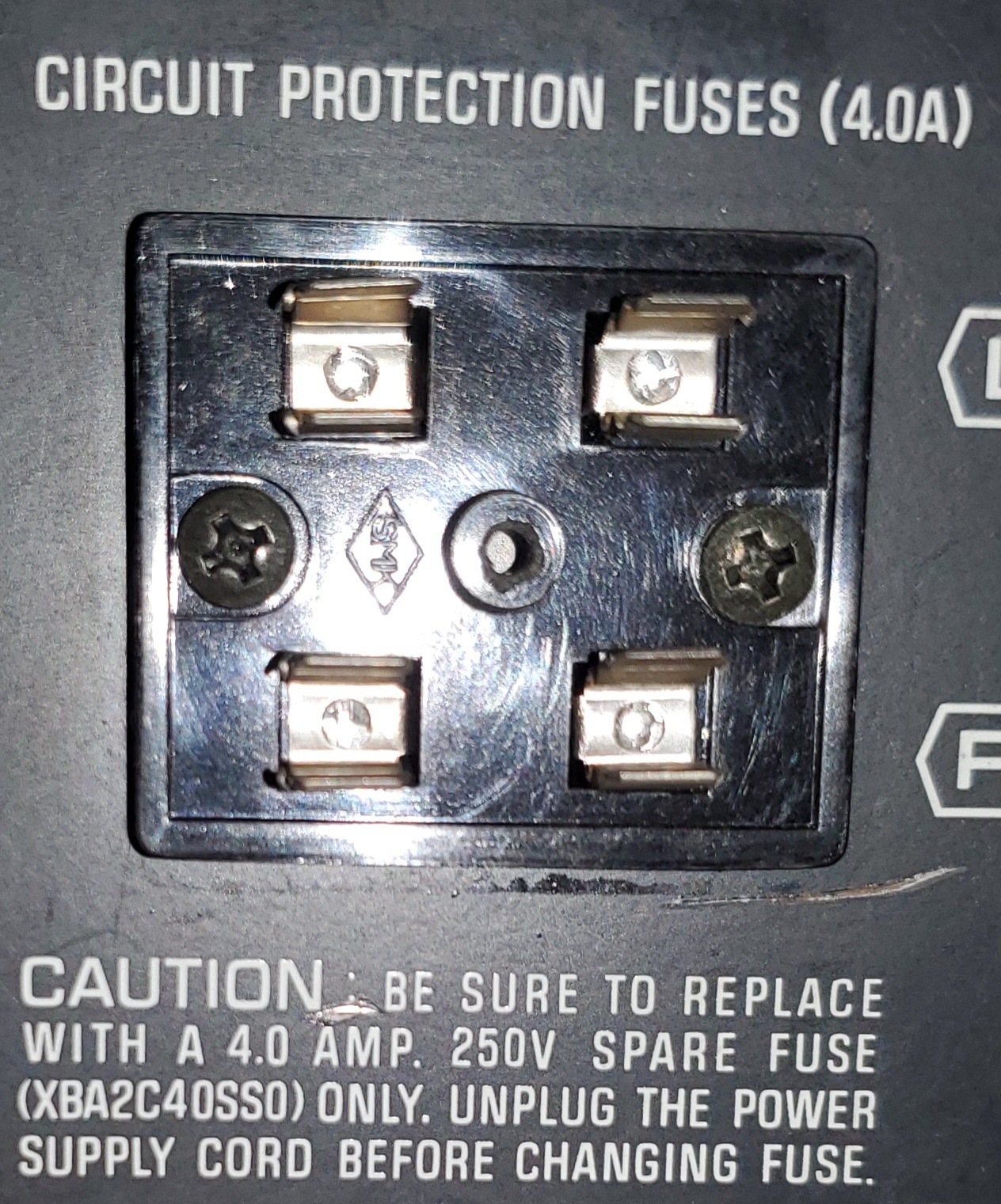

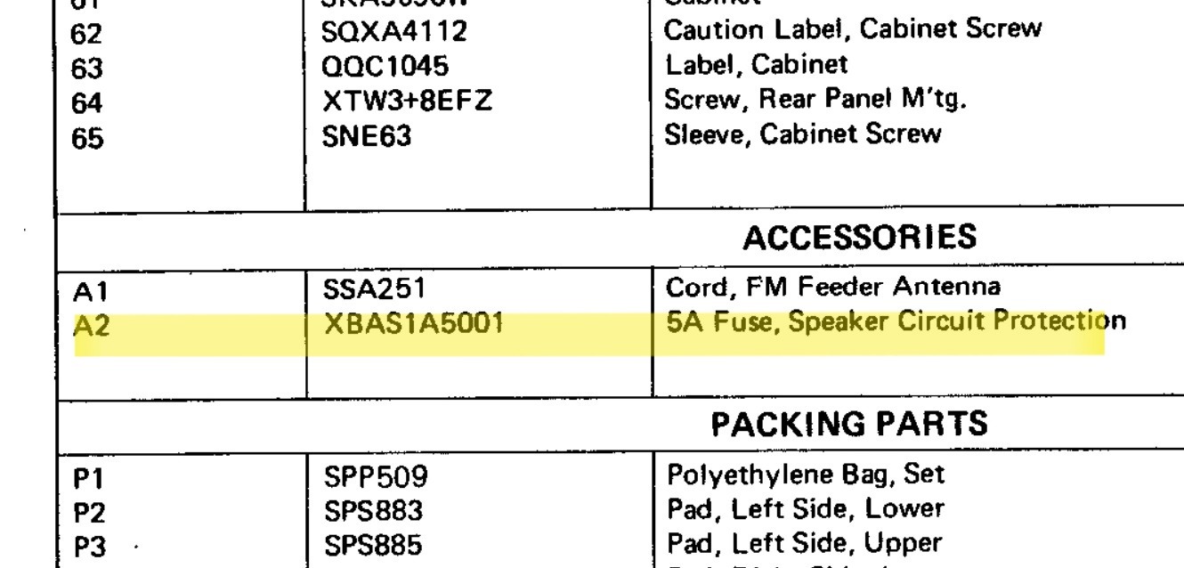

I recently purchased Technics SA-5570 and have slowly been bringing it back up to par. Today both fuses on the back of the unit blew and after further inspection, I found out they were only 1A and on the back of the unit it clearly states 4.0A 250V. Well I remember I recently came across this in the service manual and recall seeing 5A for the speaker fuses. I've included pictures of the manufacturers little contradiction. Now the real question is what fuse should I put in there?
