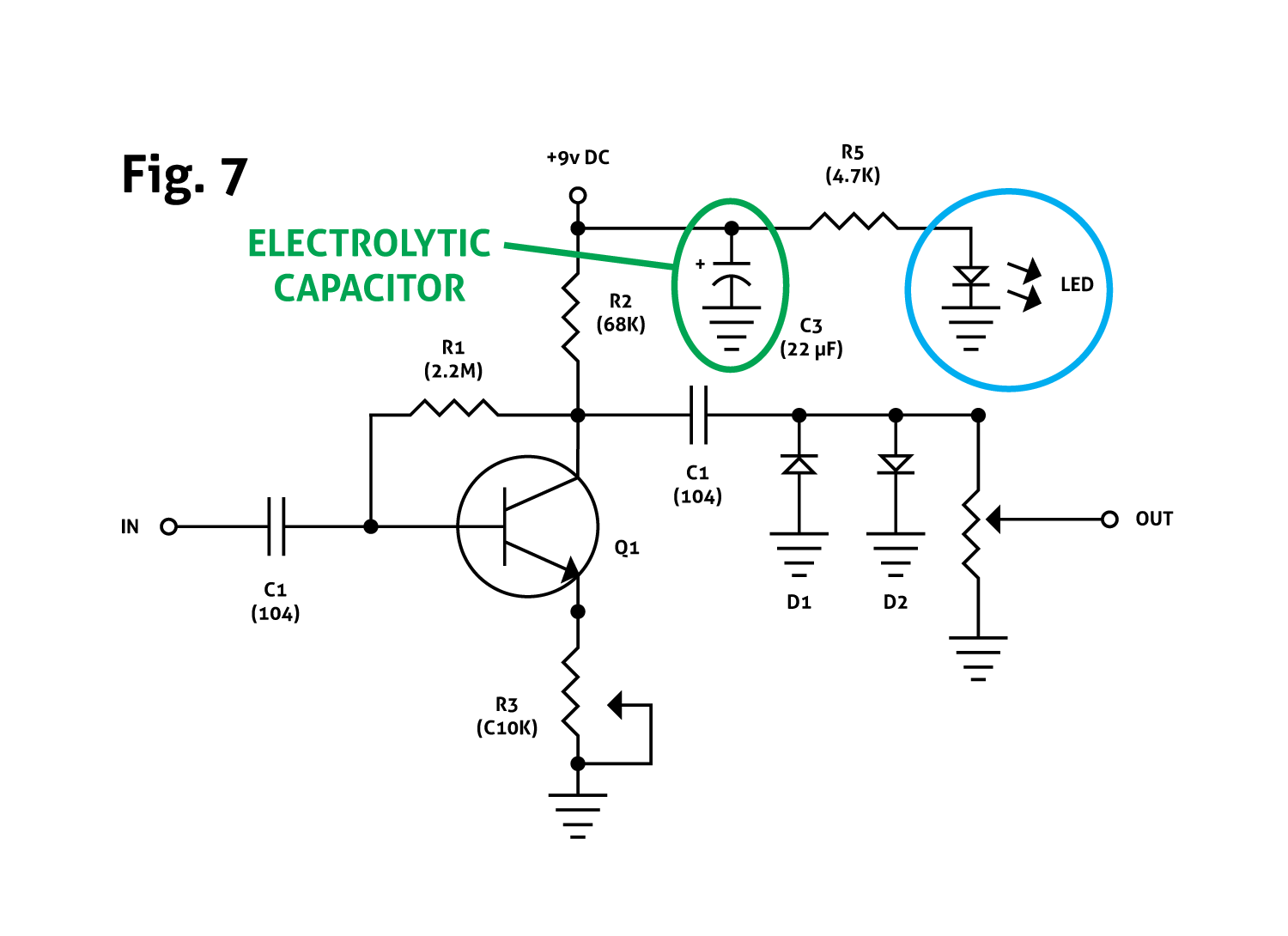

I am working on a guitar effect that uses a single transistor. A number of transistors have been tested in the circuit and three in particular are producing good results, each with significantly different gain factors.
I am exploring the possibility of building another circuit based on this one but having all three transistors on board and allowing the user to select with a toggle or slide switch. I am currently under the assumption that the only current flow I need to control is that to the base, possibly using pull down resistors to ensure that transistors that are supposed to be off are off. If this is so I would also think a triple throw switch should fit the bill (on-on-on).
Thoughts? Anything I'm missing/overlooking?
Thanks in advance.

Here is the final schematic from the article from which I am drawing this project.
If one wants to see the whole project with breadboard walkthrough and build instructions the PDF is available here:
http://www.premierguitar.com/ext/resources/files/DIY-PDFs/Oct14_PGDistortion_BuildGuide_Final_R2.pdf
My thoughts are to break the circuit between the junction of the input capacitor and feedback resistor and the pertinent transistor base. All transistors would share the single common collector and feedback resistors.

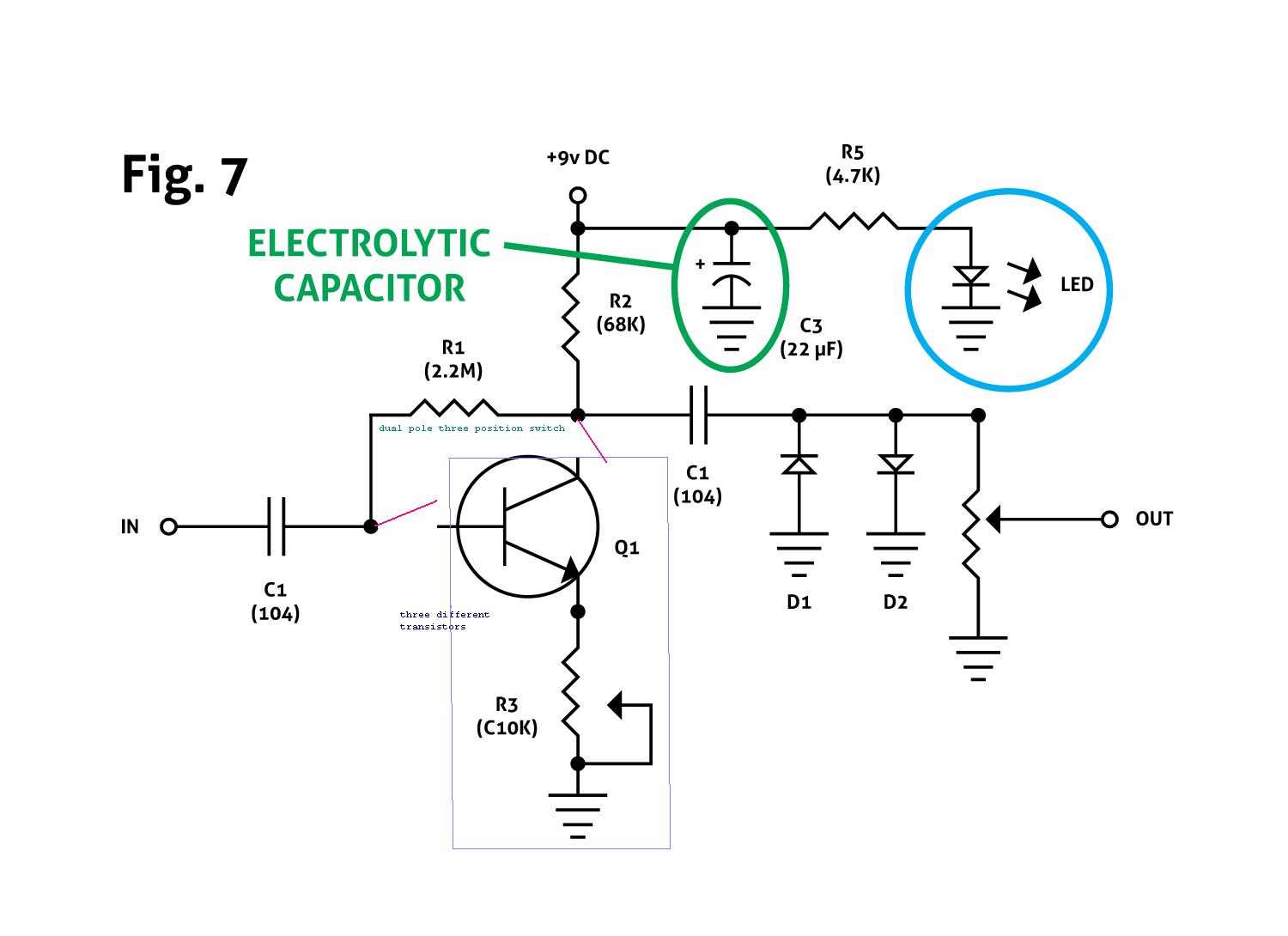

perhaps with a dual pole 3 position rotary switch or sowhat..........
I'm leaning toward a toggle switch if I can. It is usually a smaller footprint and requires less space to operate within. I have some TC Electronics pedals and they postion a three-way toggle switch in the middle of a square defined by four control knobs.
And thank you for the amended circuit. A rotary knob is in consideration but that would be along with a modification that would allow the user to switch between different diode pairings and solely for the purpose of selecting between the pairings.

1) the basic circuit is fine, and is somewhat "self adjusting" , because the biasing resistor is connected to the collector.
That said, I've used thousands of those circuits as general purpose gain blocks, I've published Guitar Magazine articles using them from active guitar preamps to 6/8 channel mixers, go figure.
And I often meet Musicians who tell me "hey Juan, I built your mixer 20 years ago ... it's still working like the first day !!!" 🙂
That said, back to practical construction:
1) any switch you add there will be larger than the electronic parts.
2) "all transistors sound the same", they will differ just by gain, which is random within a certain range , factory usually says "between 200 and 500" or something like that, just read the datasheets, so in practice if sound is the same (it is) and only gain varies, that will be accomodated by setting the gain pot , as Enzo said, from 4 to 7 or whatever is needed.
Easier and more finely adjustable than switching transistors in/out
3) now about switching different type diodes in/out , yes, that does bring important changes and is justified.
4) that distortion circuit has very low input impedance, so be certain to use true bypass switching to pull it fully out of the way when not used.
5) any switching involving DC will loudly thump or at least pop.
That gain pot carries DC and will scratch when adjusted.
All this said with the best intention to help, many of us have been along that exact same path .... and we're still here, so it sometimes hurts but never kills 🙂
