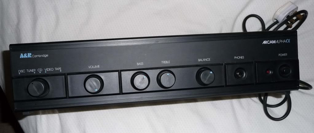

Manual for Arcam Alpha Amp
Anyone know where I can find spec for this amp at all?
iirc I thinks it's 30w per channel, could be wrong.
It's stamped 1984 inside
You won't find specs in the service manual covering Alpha 1-3 models. A couple of reviews quote 35W/8 ohms and this would agree with the limit imposed by nominal +/-33V power rails. The Arcam owner manual specifies 30W/8R (both channels) or 40W/8R (single channel ) or 60W/4R (single channel) which says that the transformer is a bit small for continuous sinewave testing.
