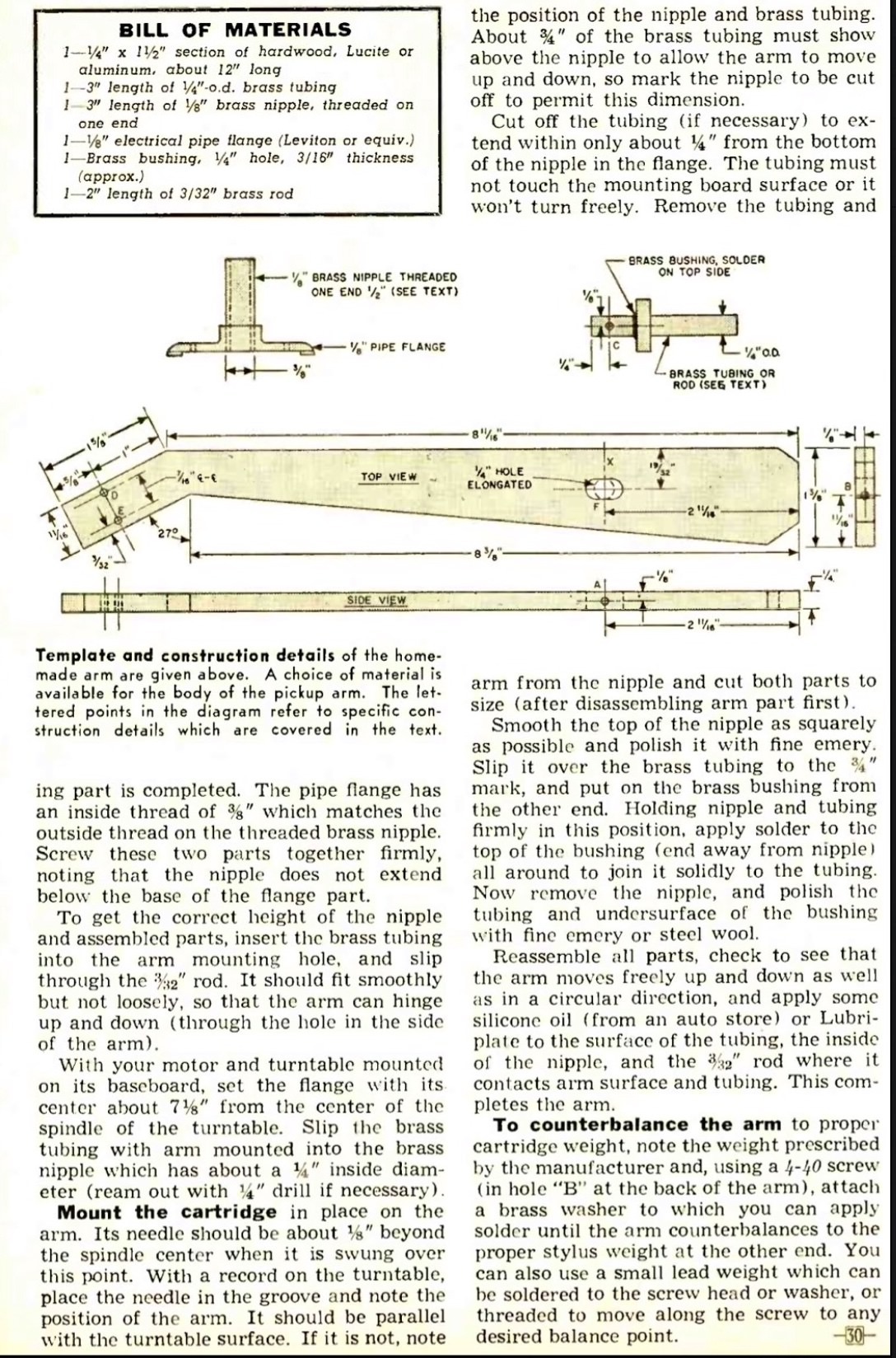

RS232 ... great find, every bit of that type helps.

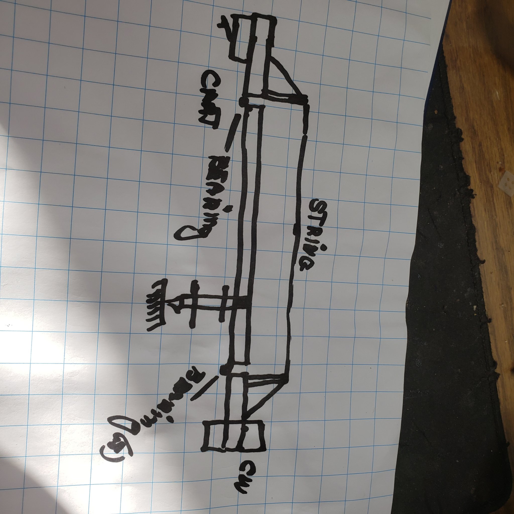

I think I can build with no total arm counterweight.
