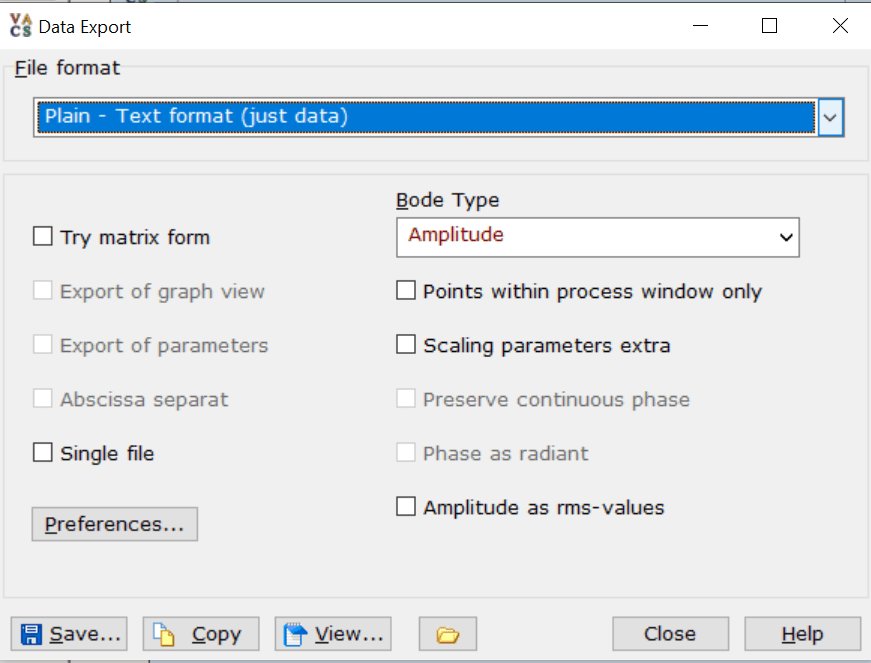

I have a question; On slide 33 there is a plot of the cardioid subwoofer dispersion with a LP filter on the rear driver. Is that filter linear phase in the simulation? (if so, how do you know how to simulate linear phase filters in AKABAK?)

Yes, it is linear phase.I have a question; On slide 33 there is a plot of the cardioid subwoofer dispersion with a LP filter on the rear driver. Is that filter linear phase in the simulation?
Creating a linear-phase filter is not that easy in ABEC (I guess it is the same in AKABAK). The curve file shall not contain any phase information. To create such a curve file I did the following in the past (maybe there is an easier way today):
- Create a FIR filter with RePhase and export it as WAV
- Import the WAV in to VACS
- Fourier transform it to get the frequency domain (Processing -> Fourier response)
- Normalize it to "curve max amplitude"
- Export it as curve file (F7) with amplitude only
Then use that in ABEC/AKABAK as curve file and you have your linear-phase filter.
Thanks so much! I wanted to use linear phase filters in AKABAC to sim a cardioid speaker but I didn't know how. Great help 🙂
