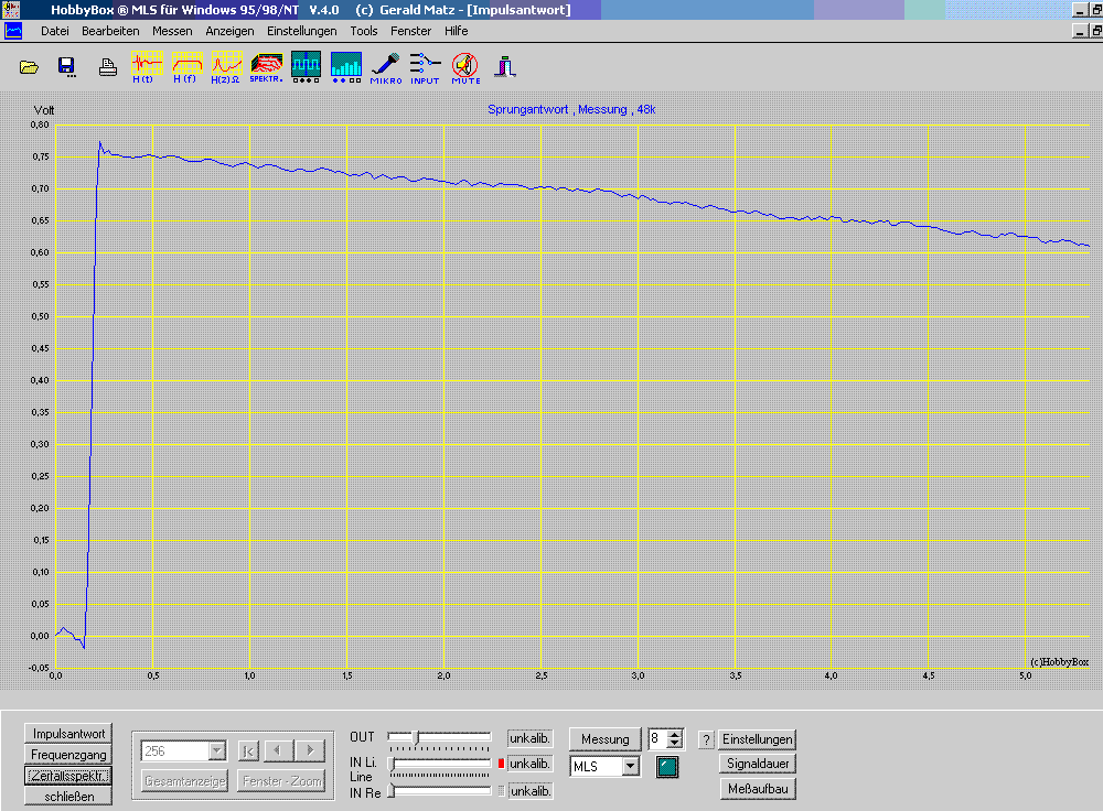

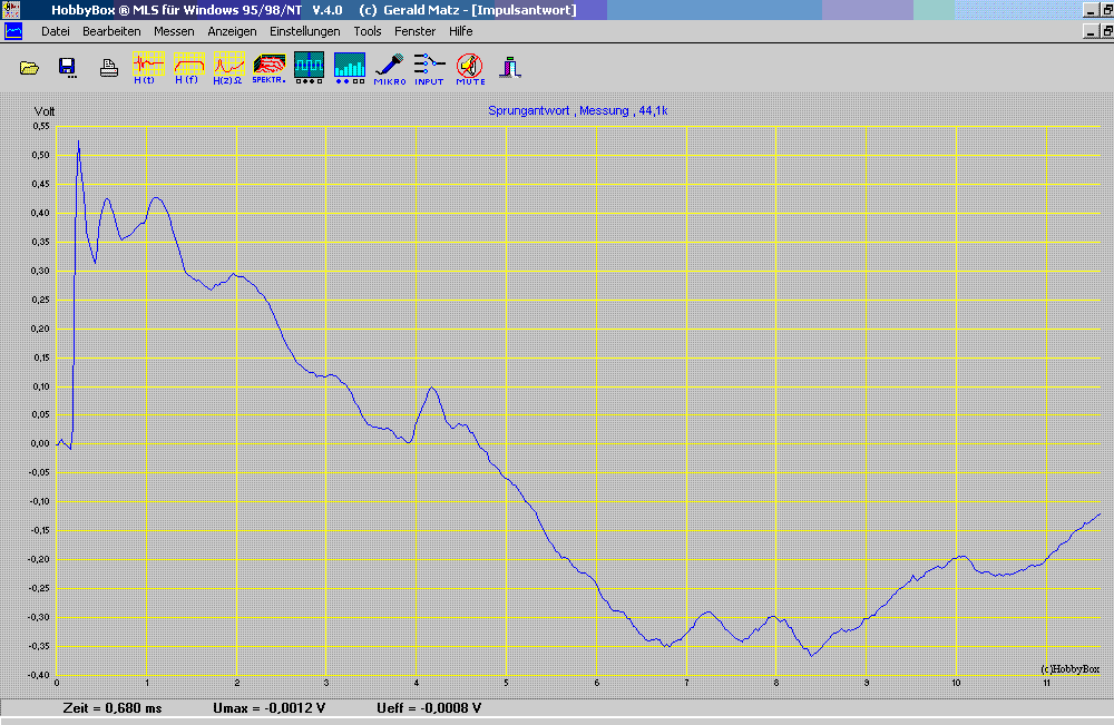

Well, since I am a grass-widower currently our living room has been changed into a speaker-testing lab. I am currently experimenting with a crossover topology that is a variant of this one:
http://www.diyaudio.com/forums/showthread.php?postid=292789#post292789
Attached you can see the in-room measurement of the step-response. You'll have to note that the room is very reverberant, the "echo" at 4ms approx is most probably floor-bounce since it correlates quite well with the path-difference divided by c.

So many reads since my last post and no one objected !!! Or did everyone notice the date of the posting ?
If I really had a simple analog solution to achieve such a step-response from a multiway system it would make many people workless !
Regards
Charles
P.S. The Step response is form the soundcard alone. 😉
Regards
Charles
