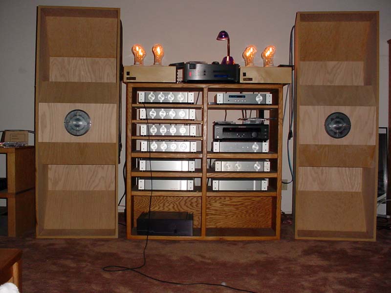

Having spent a lot of time with the Mangers, I say that they can
be considered a full range speaker if you don't push them
too hard, and that pretty much means that a single pole of
crossover filter will do the job at any reasonable frequency.
Electronic crossovers are definitely preferred, but for the Mangers
you can accomplish this with a simple cap and potentiometer
before theamp. Be prepared to fool around with it at length,
and use your years, not the textbook. 😎

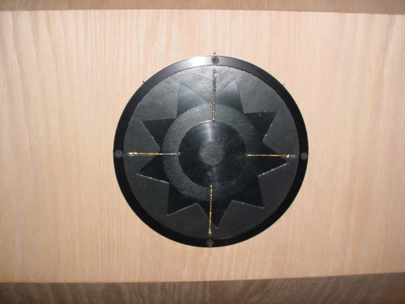

Nelson,
Thankyou for all the information!
+ In the specs for the Manger, they show it producing output to 35Khz. In your manger4.gif, the output is down 60dB at 20Khz. Was that a limitation of the testing equipment?
+ In manger2.jpg you have the Manger orientated with the spring wires vertically and horizontally. Was this arbitrary? Other builds seem to have the springs in a X shape.
Antony

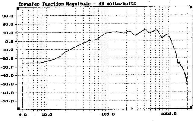

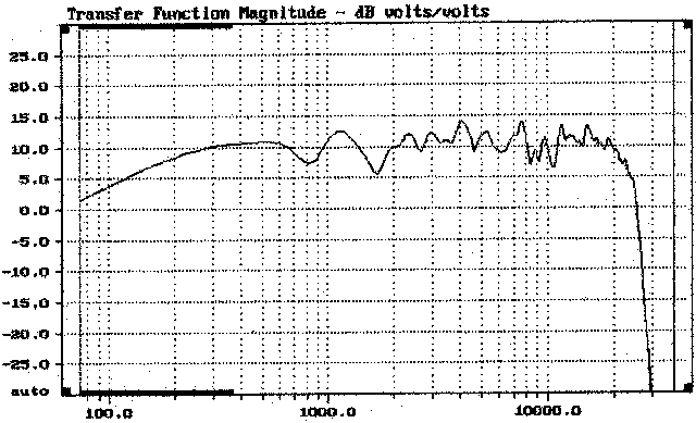

aj_newman said:+ In the specs for the Manger, they show it producing output to 35Khz. In your manger4.gif, the output is down 60dB at 20Khz. Was that a limitation of the testing equipment?
1) That curve manger4, was noted as 1 KHz bandwidth, so that
we are only looking at the bottom end up to about 300 Hz or
so
2) manger5 showed the response with 25 KHz bandwidth, so it
could go to 35K without me seeing it.
3) I did not discern that there would be any difference in
orientation. It was arbitrary.
Regarding the question about sound, this is of course very
subjective. I used them full range, without woofers or tweeters,
and I found the speakers neutral and pleasant. At the same
time, my personal preference is a bit toward the more lively
quality of something like the Lowthers DX55's, in spite of all the
extra treatment they require. Both products are engineering
masterpieces. Take your pick: they seem to cost about the same.

Nelson,
Thats for the clarifcation on the graphs!
You have amassed a Polar response of the Mangers in your empirical data?
I guess I'm now wondering if the Mangers Beam at Hi Frequencies, and this being the reason that they use 3 Mangers in the HF section of the ZeroBox.
Have you have any fun mounting the Manger in a Spherical enclosure like Cabasse?
http://www.cabasse.com/english/artistc22/index.htm
Antony
