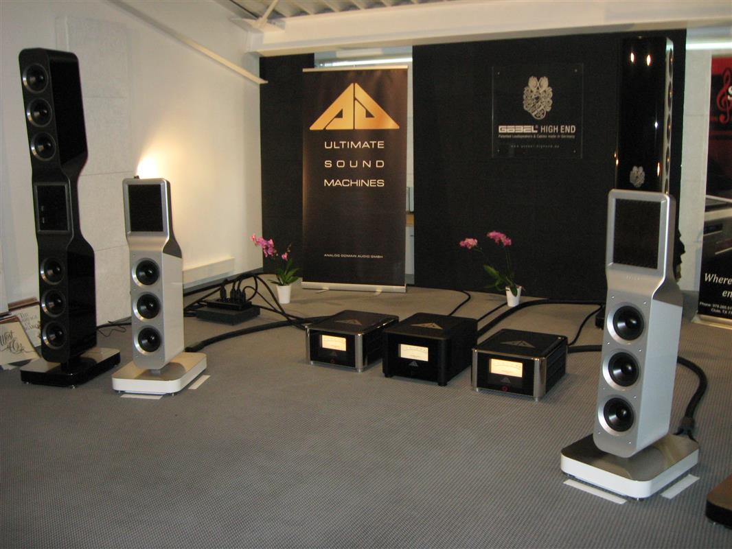

The bass was well integrated when I listened to them at the Munich show. I listened to the smallest version.
Most likely you heard room modes.
They are not very dynamic though but the cohesiveness is awesome and thus a great vocal presentation is certaintly present.

I listened to the silver ones in your picture in Göbel's own demo room. They sounded very coherent with recordings without much bass content like some percussion or voices when most of the frequency range was above 160 Hz when they work only through their bending wave driver.
A spherical baffle sounds like a good idea. It would avoid the problems of box resonances. Btw, that driver looks great. 🙂 It would be really interesting to hear it.
