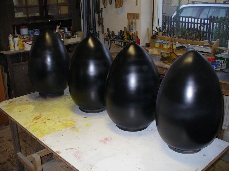

jirka said:For everyone who would like to try Manger but hate more directional designs:
The directionality of mids is better than from some conventional midwoofers. The directionality of frequencies from 6kHz and up is the weak point.
THE CURE IS SOUND DEFLECTOR
With somethink like Holoprofile you get the dispersion like from small tweeter.
The cure is worse than the disease though.
You effect phase and frequency response by placing such an object in the path of the loudspeaker. Call me a purist but I don't think that's the way to go about it.
There is no opposite point of the voice coil or membrane, thus the horizontal dispersion is excellent. The vertical dispersion is also a little better and usable.
Original Holoprofile is good for 2-way application of MSW and it is also easy to DIY.
Maybe you affect phase and frequency response a little but I dont hear any change to worse. Everythink is a little more focused, more detailed and real.
What I dont like is that there are less effects of sound reflected from both sides of the listener but maybe that is one of the things for improved imaging (which does not need improving).
