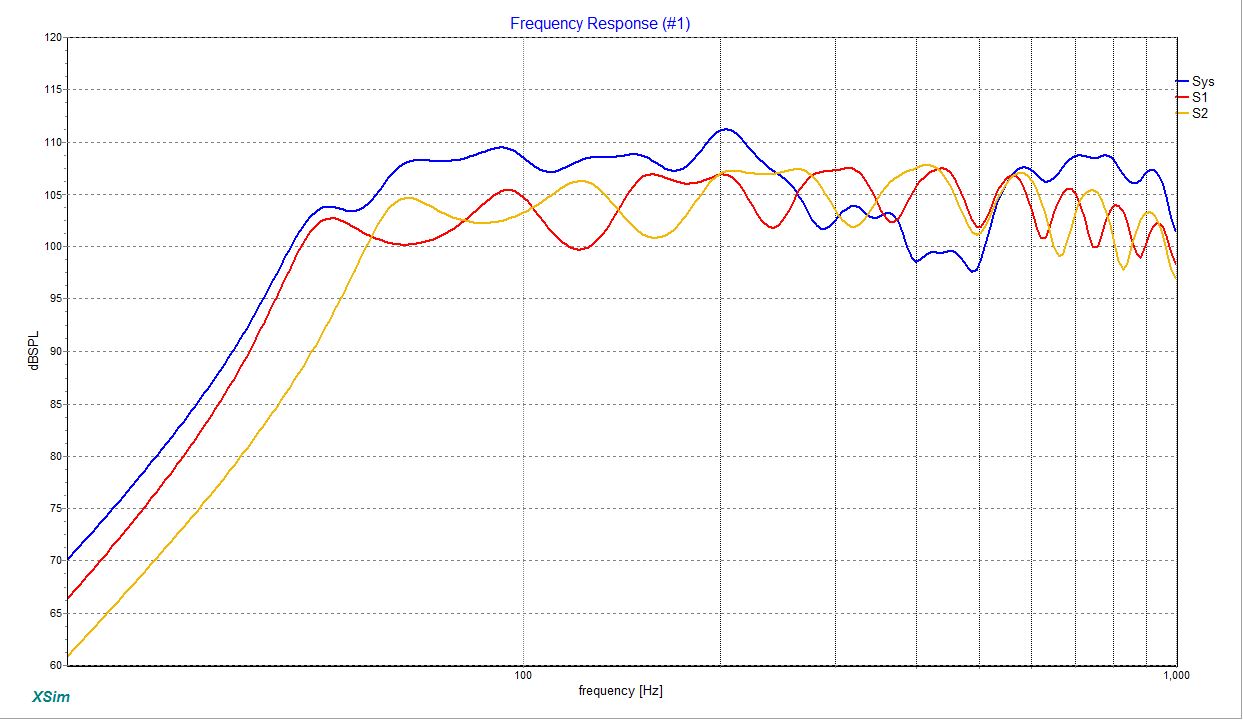

Edit: I just tried to do a quick test - default horn driver, horn lengths 270 cm and 202,5 (3/4 - not sure if that is the correct ratio). One horn is the red one, the other one yellow, combined is blue, done in XSim.
Edit2: This is combined output of two horns and two drivers. Maybe it is not really the correct way of doing it, but could serve as a first guess.
The double horn are actually two separate horns of different length, each with its own driver. I think these could be simulated separately in Hornresp, and then add the FRs properly in another program. On this however I have not seen the horn lenghts listed, maybe Horst himself can answer that question. Then, they could be aproximated with exponential horns to have an idea how that may work.
It should be definitely possible in Aakabak and maybe ABEC, but that is way out of my skills.

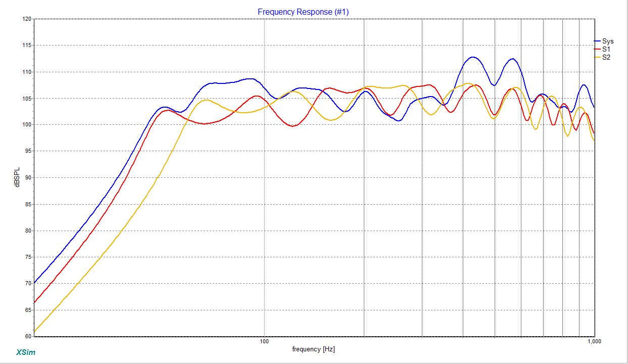

Here is the FR with 5 inch and 10 inch spacing between the two drivers/horns.
Again, not sure that all I am doing is correct, but it seems that the double horn should work in principle (I did not doubt about that, this is just a small proof to me).
