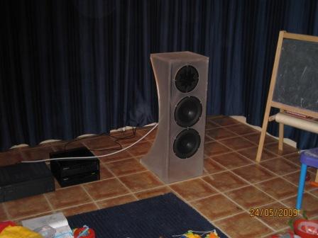

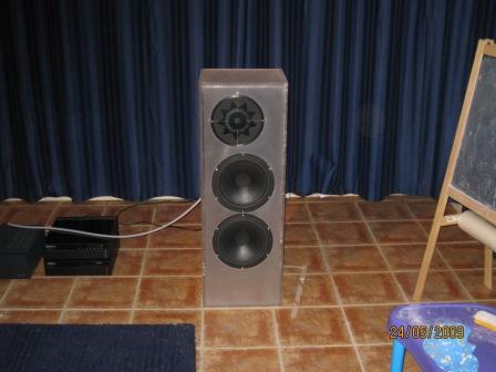

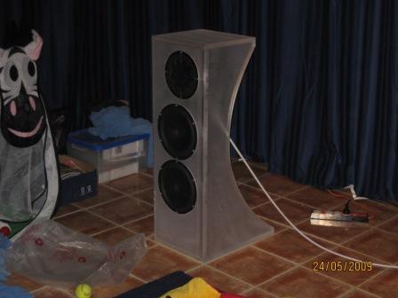

hi derek
heres the design im thinking of feel free to pick it apart if its not workable
i already have the drivers so i cant change them
2x scanspeak 25w8565-01 per cab crossed to the mangers at 350hz
ob in the same design as your angel in clear acrylic
baffle 350mm wide by 1100mm high
baffle is 20mm acrylic as are the wings ,top and bottom panels
bottom panel will be 500mm long top will be 300mm long with your vpl curve in between
manger will be mounted at the top 50mm down and offsett to one side instead of centre
id like to mount the 2x ss bass drivers as close to the mangers as possible but central on the baffle (side to side) not top to bottom
i realise this will compromise bass though as its better to have them closer to the floor rather than up higher just under the manger
which do you feel is the lesser evil ?
do i have to put a divider in to seperate the manger from the bass drivers or is it ok to have them sharing the same vpl cab and baffle
the above will be run active with my 2x pass f5 and maybe a groundsound crossover
any help advice you could give on the above would be very much appreciated
regards sheafer
Definitely !!!
Regards
Charles

Acrylic Angel cabinets.
Hi Sheafer and AJ,
Sorry about the delay in replying (my house move is going badly!) but by the end of the month I should be back online more often.
Re the Angel cabinets:
(1) twin Scan Speak Hi Sheafer and AJ,10 inch drivers per side running up to 350Hz should be very nice indeed.
(2) I may be too late with this comment but it’s important to separate and isolate the Manger from the bass cabinet because the bass drivers will transmit a lot of mechanical energy into the Manger if all drivers are bolted to the same baffle.
This will be even more important in an open baffle as the Manger really digs deep with amazing low level detail and sublime imaging that I never heard with any sealed cabinets. Heavy bass mechanical vibrations will mask this musically essential information.
(3) I used a 25mm thick Sorbothane pad custom molded to lock on to the underside of the teardrop shaped eggs ("Prey") which I used to house the Mangers.
I would recommend 700mm to 800mm tall bass / mid cabinets with a separate (sitting on a 10mm to 20mm thick Sorbothane pad)trapezoid open baffle VPL Manger cabinet. The Manger cabinet only need to be 400mm to 500mm tall with the Manger located off centre and approx two thirds of the way up the baffle.
10mm and 12 mm acrylic is fine for the Manger cabinet.
(4) Mounting the bass drivers high up will be fine, the trade off is more low end Vs better driver integration. It’s really personal taste and aesthetics at the end of the day.
(5) Try to avoid adding too much bass boost below 80Hz as this will gobble up the Xmax of the bass drivers. I set the bass / low midrange Vs Manger levels on the DEQX crossover with the bass/low mid about 8dB too high. This then enabled me to EQ the balance correctly with subtractive (troughs) of EQ rather than additive (peaks).
The twin Seas Excel drivers responded really well to this.
For any UK based guy's I still have two pairs of original Angel cabinets in the garage (one pair still has the Seas Excel drivers installed), I am open to reasonable offers....!
Please remember the VPL design needs some EQ' ing as I always use the DEQX crossover (or a PC with Smart Live or similar) and you need to spend some time measuring and setting it all up. Once its set up correctly it’s unbelievable, people can’t believe that all that bass and Manger magic come out of no box.....!
All the best and good luck.
Derek.

hi all
as promised heres some pics
ive only ran them with the manger full range so far as i still have not got a crossover so i have not heard the bass drivers as yet
they are in a frosted finish instead of clear
the finish looks uneven in the pics but its just the light and my grotty finger marks all over them
