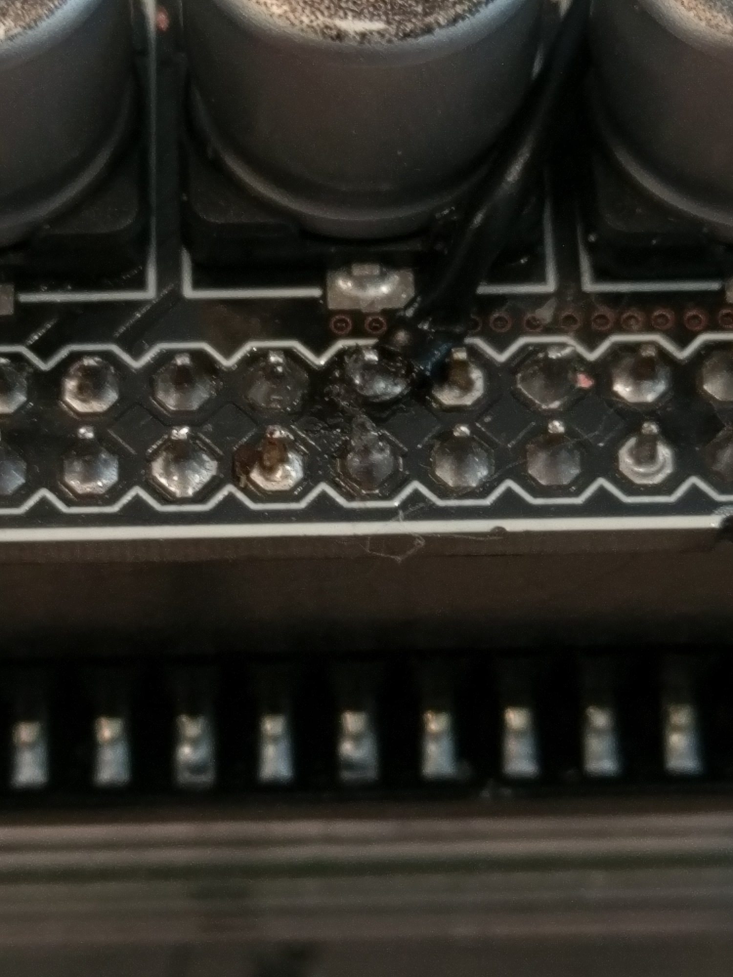

So.

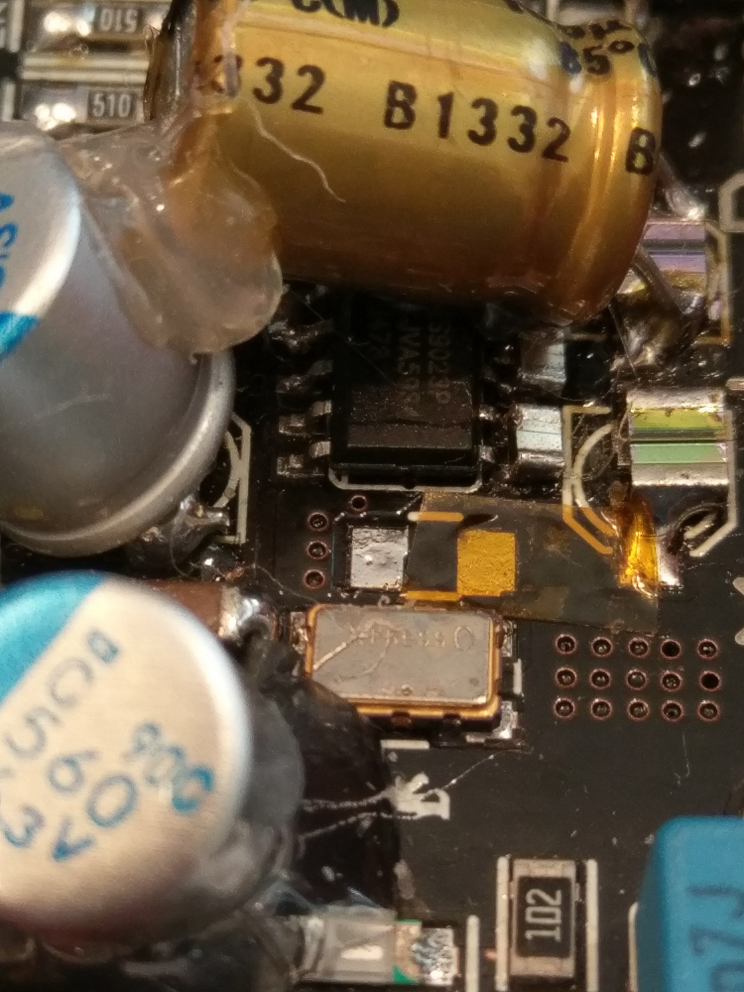

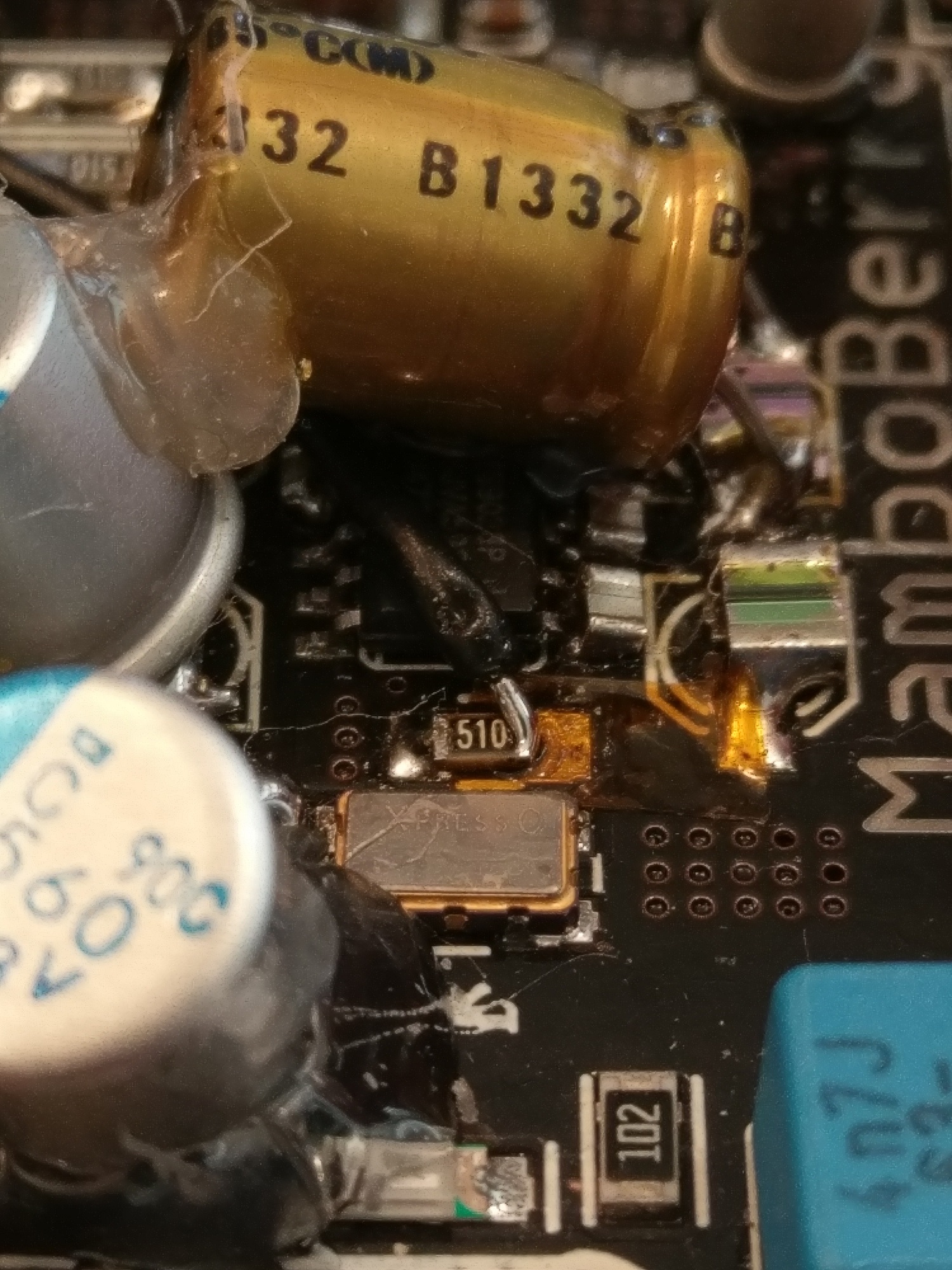

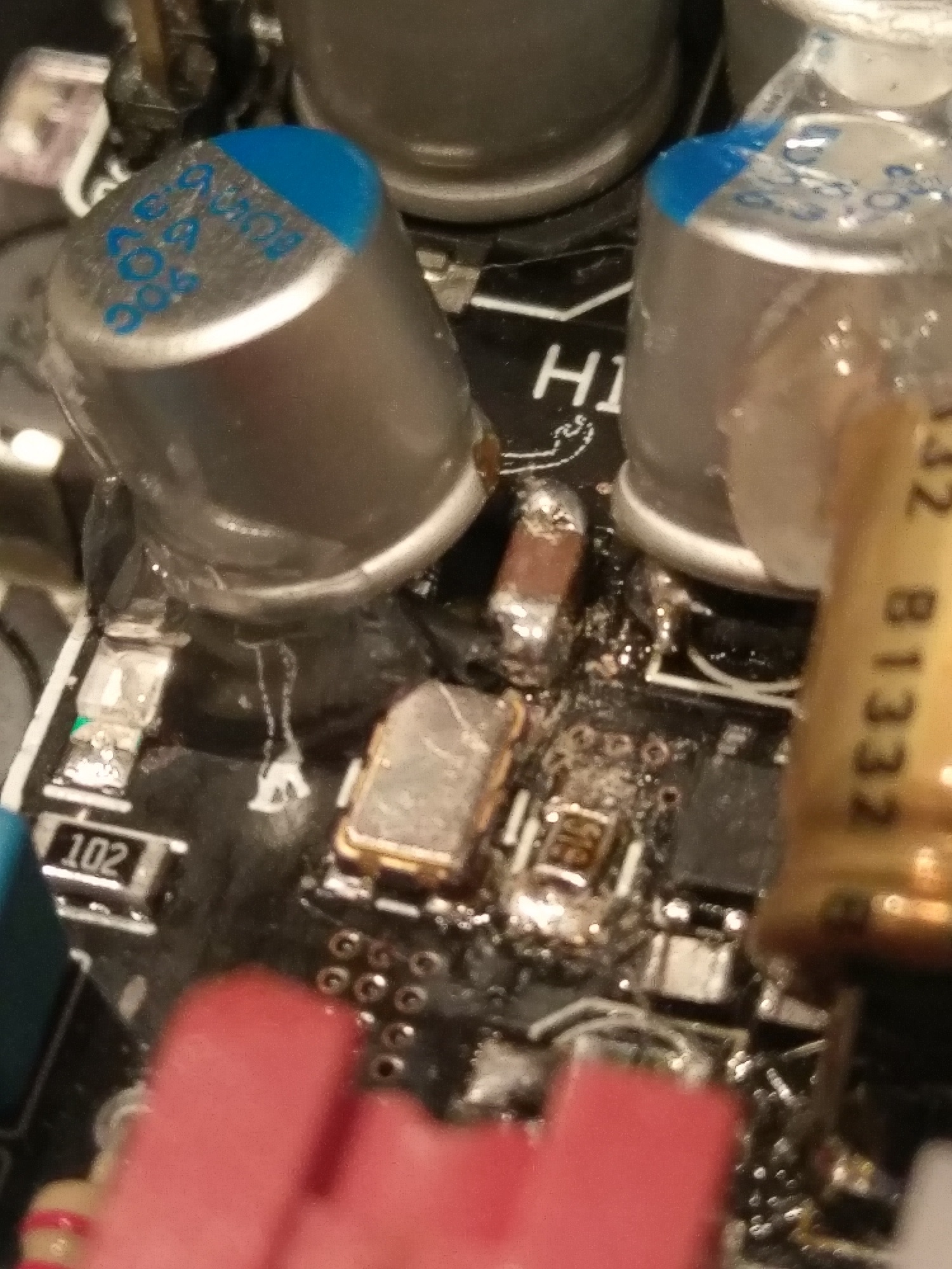

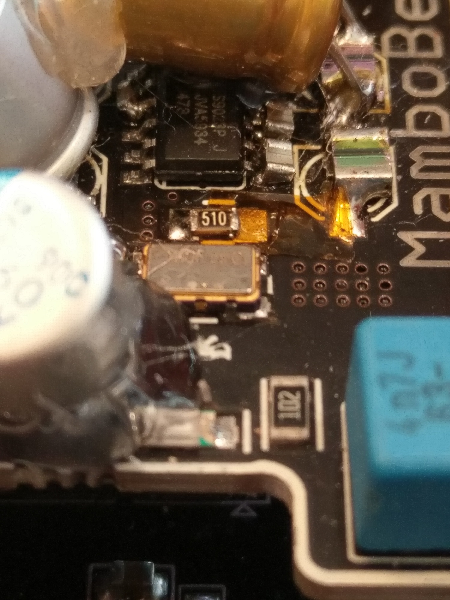

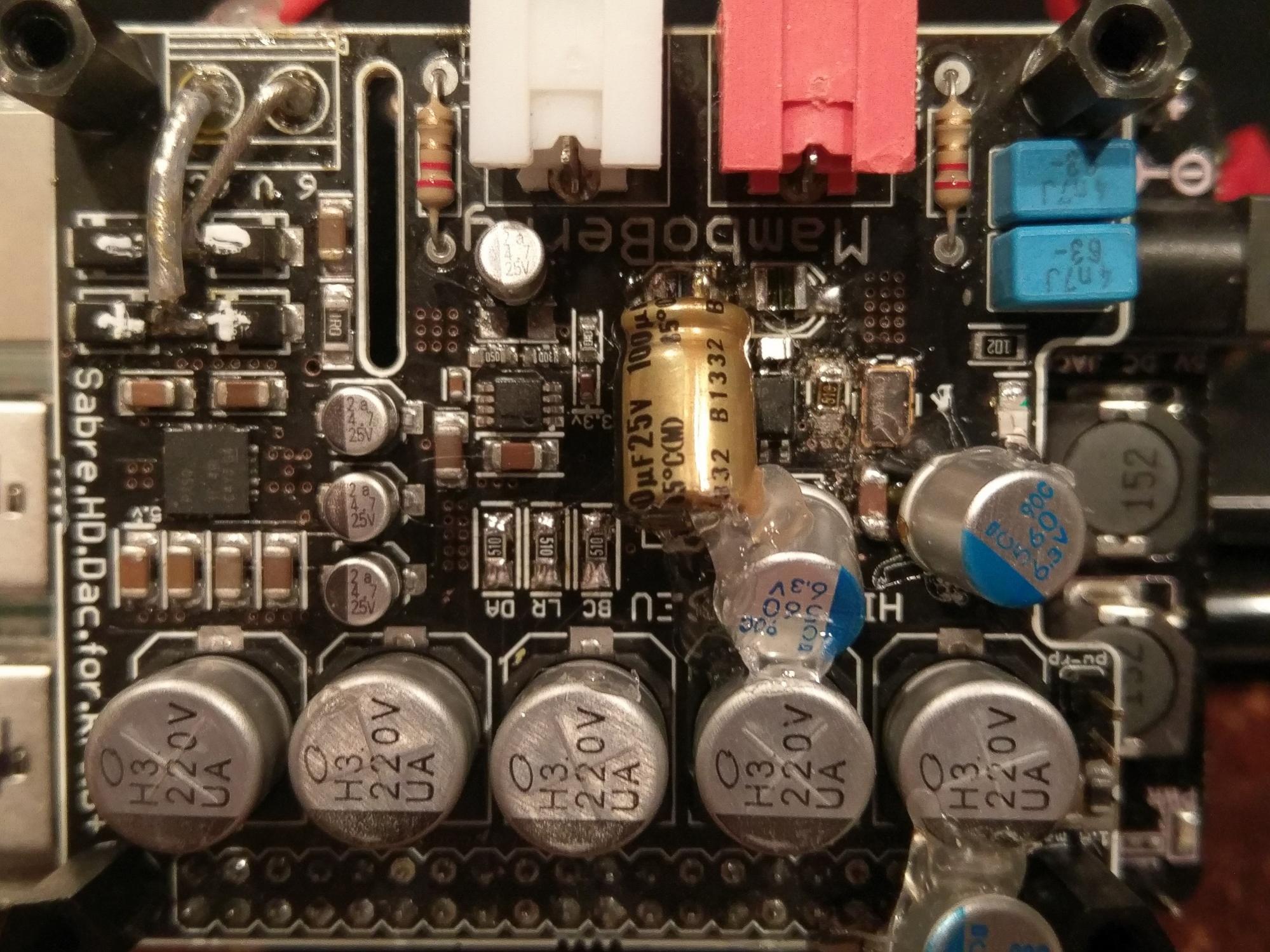

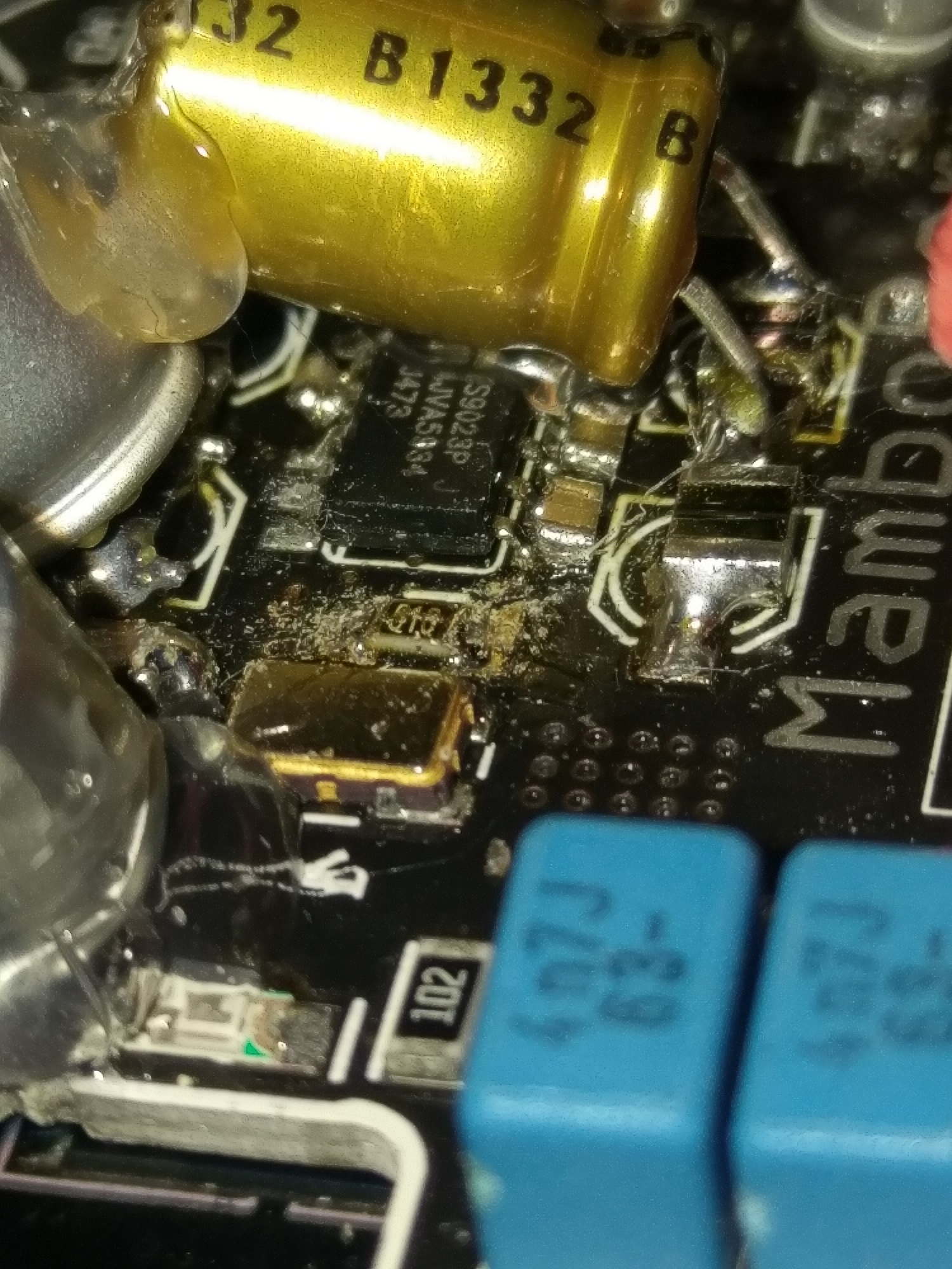

I also did the sync-MCLK-mod surgery. 😱
1. relocated the 51R ( I cut the trace that connected to pin 27 - this way viases 29/27 make some nice pads for the 51R )
2. removed the clock LDO
3. used a 3-wire ribbon (gnd-clock-gnd) for the time being
4. Against earlier plans I'm using the old 51R pad to inject the clock.
5. I bent the ribbon away from the other I2S lines. (routing is not as shown on the image)
Now it's heating up.
PS1: Sorry Vasilis, Not much left of the MamboBerry. 🙄
PS2: What you see on top of the caps are NOT my old chewing gums. 😀
@Soundcheck,
Good on the cap damping, I will do that on mine at some point.
Your pictures reminded me I have not posted any of my work on the MB...
Here's some of my sync mode setup.
As on yours, I had too much treble emphasis too with mine and a 51R series R. Try 100R.
Also try it on the other end of the line.
I suspect the u.fl will be better than the ribbon. I just used a single wire, worse choice, but it worked ok once I fiddled with the series R value.
Greg in Mississippi
P.S. You can see the PPS caps I used on the CP-CN and NEG-GRND pins pretty clearly here along with the ones replacing the small electrolytics. AND please excuse the goopy clear stuff, that is hot glue making sure the caps are well secured and won't accidentally tear off pads.
P.P.S Also try a couple of good 10R metal film (Vishay-Dale or PRP) for the output R's!
