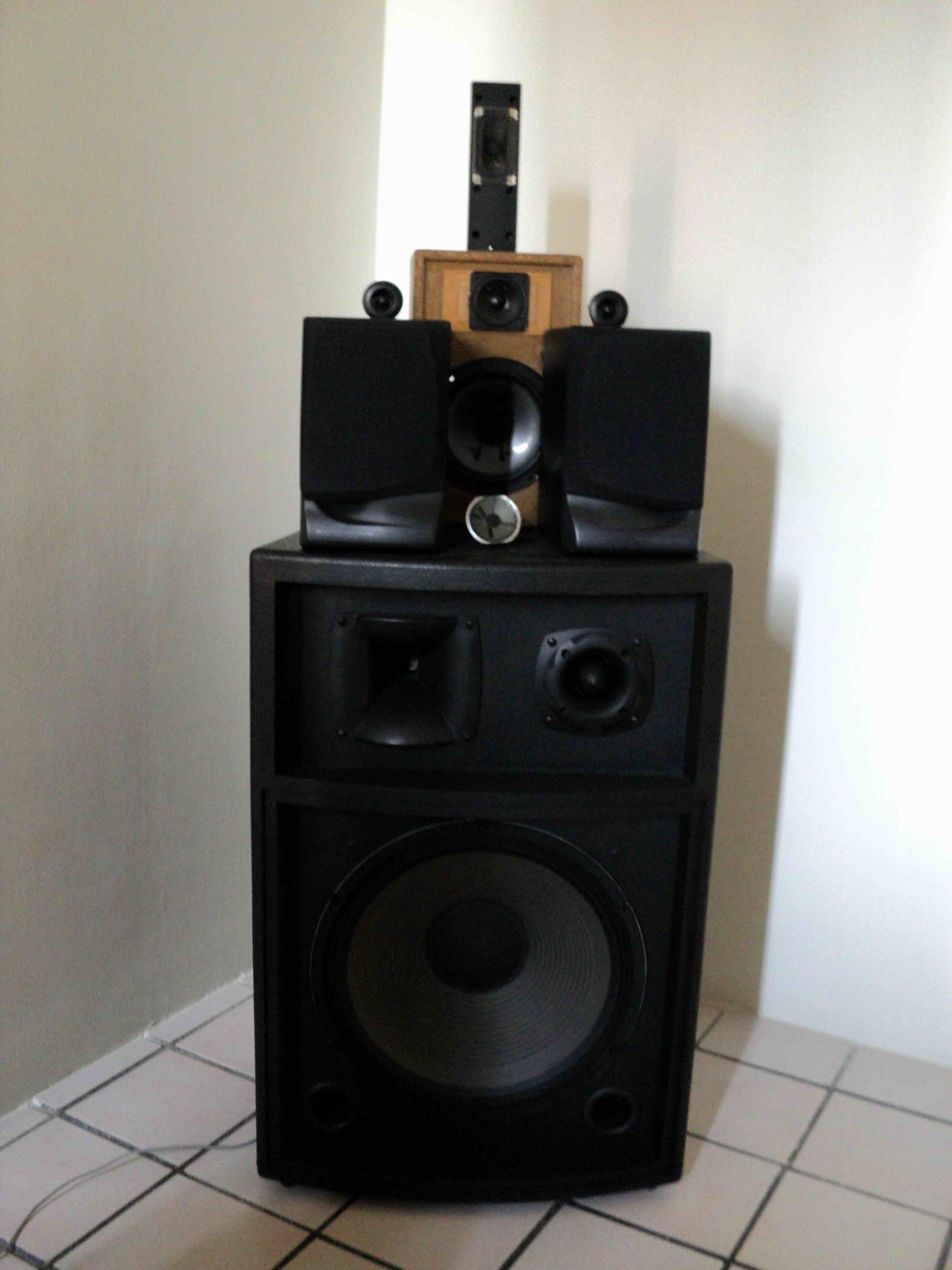

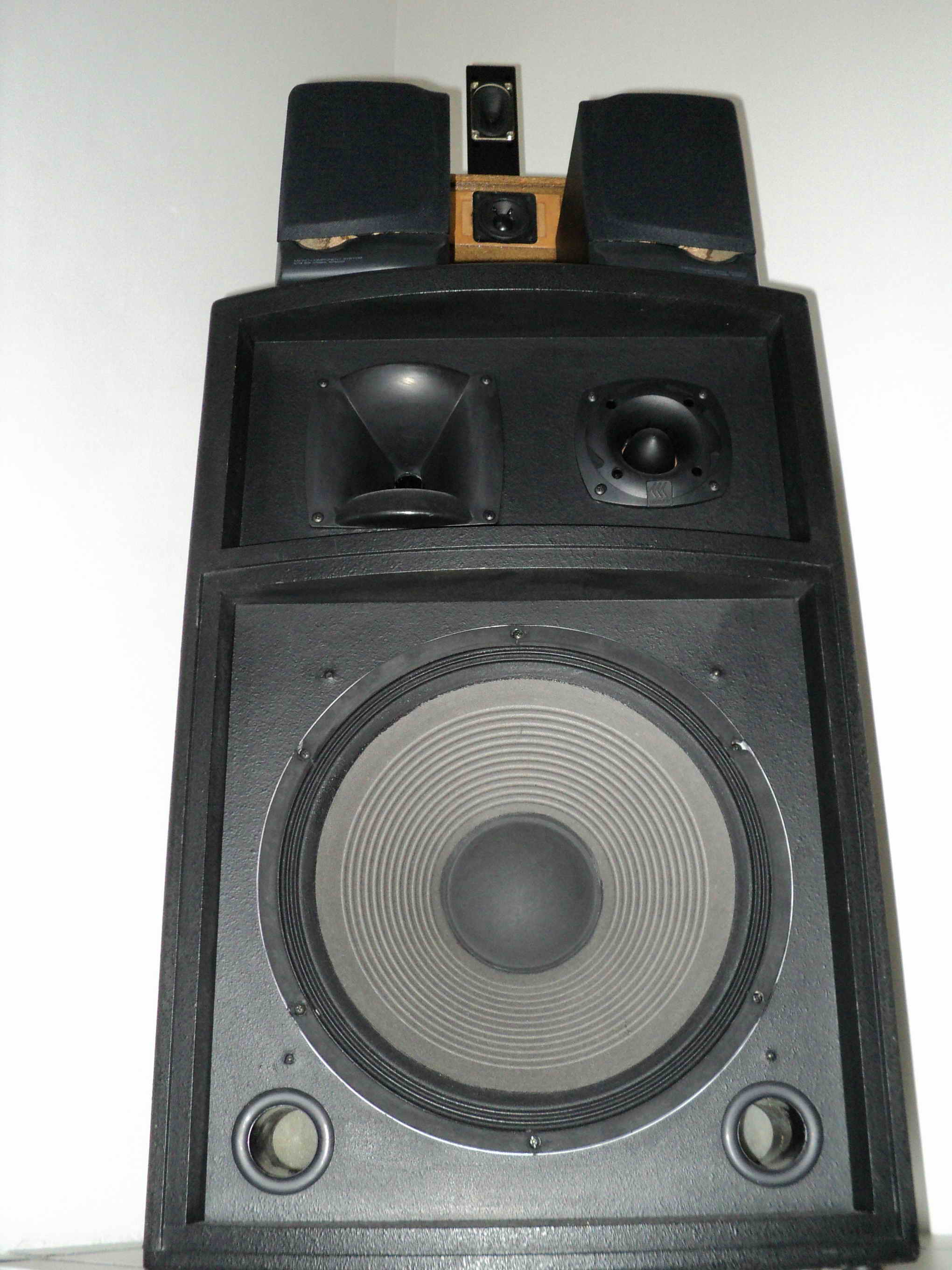

Crank you Dx Blame ST or Supercharged full volume
and enjoy Symphonic from Australia.... i am plugged into youtube.
you should do the same if you can.
Speaker crossover is my design and uses 7 bands

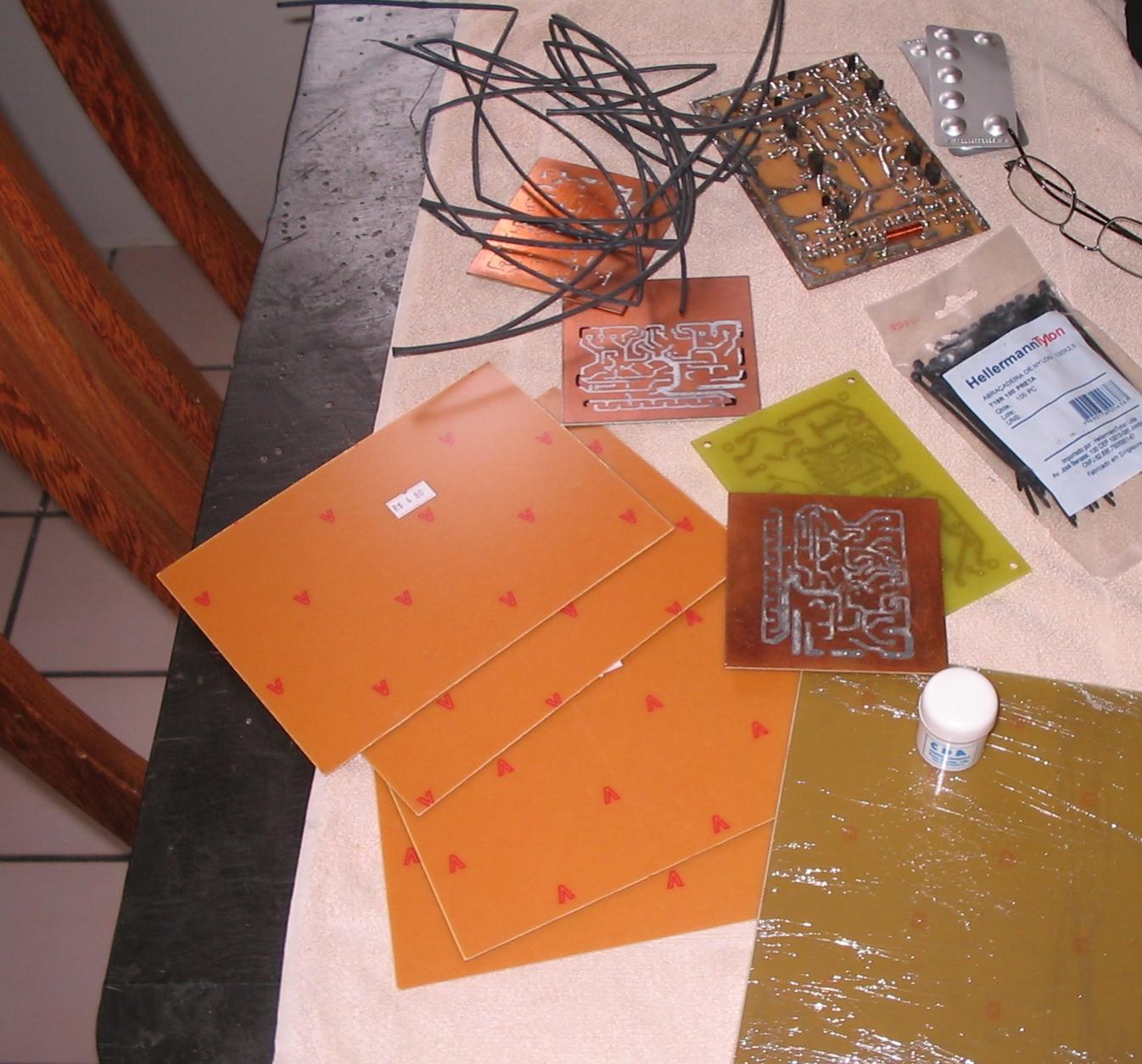

Today i have received gift from Renatovsky Kalishinikova Kaput Stalingrad .... the picture shows some gifts and one more MAKO prototype on the run.
Fenolite boards are 8 inches by 6 inches.... 1.6 Brazilian Reais value is 1 USD.... so, each board cost was 3 USD... small pot is thermal grease, the white one....good gift... tubes are heatschrink tubes...the rest is obvious... you see..cheap gift but very usefull to uncle charlie.
The board partially assembled is one MAKO prototype...but i am doing it slowly as i am having pains in my kidney..the hell stone is still there bothering a lot...i use to apply injections in my bely, legs and everywhere, from 3 to 3 hours to control the pain.... the pain is so big that i cannot feel injections...sometimes if forget and walk with injection still applied into my upper leg....pain is to cry or scream...i control myself saying ship and other words as in my culture man is not allowable to cry... the word ship, if you can understand the real meaning, may be because pain is alike a ship smashing us.😉

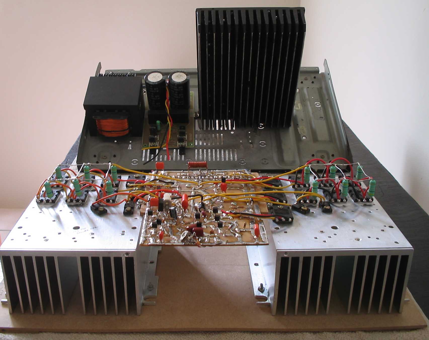

MAKO was tested at 350 Watts RMS - 4 ohms
I have to test it at 500 Watts RMS - 4 ohms and distortion smaller (THD) than 0.004%.
You see, wiring is the most crazy possible...length is too much.... wires too much close one to the other... long wires interconnecting drivers bases ...all crazy things done and no oscilation or signal of unstability....so.... passed this way will be super stable in a decent pcboard Alex mm will produce.
I will install another supply in paralel...maybe another transformer only..to be able to check it at 500 watts continuously...because short therm peaks i already have.
The real amplifier will have 12 pairs in the output...all them huge transistors and heatsink will be at least twice the size you see... also fan blower will be used as auxiliary cooling system.
This will turn the amplifier able to face very low impedance loads..and supply may be a SMPS ...a 7 Kilowatts supply or two 3.5 kilowatts units
Well...this is for monster users... as they can install a very low impedance in the output (several speakers) and the amplifier must survive.
I am slowly building as i am busy... having students learning audio electronics inside my home everyday.
