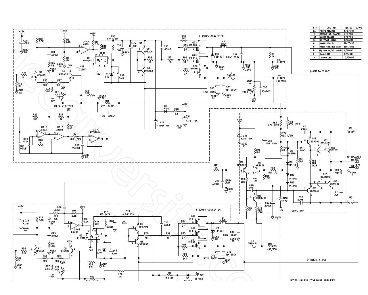

Carlos , my friend .... why not really depart from the norm. Did you know that with just 2 or 3 pair outputs and a "tracking down converter" (below 1) , a "hyper powered" 500w+ amp can be made with a standard EF2. 90% efficiency , the converter can be made small (to-220 mosfets). This one has not been built (yet). Also , it would still be a linear class AB amp
(not D) as the power supply "tracks" the higher power transients. Notice the simple bootstrap amp with standard 2 pair Japanese 4302/4281 outputs in the middle.

You don't understand , substitute any DX amp for the one in the schema. With the added converters , you more than double the amps efficiency and power output. NO new topology , just a super fancy "smart" power supply.

That is NOT a SMPS . It uses a +/- 90-130vdc standard supply. When the signal is small it "down converts" to run the amp at +/- 20V. It then will "follow" a high power signal only raising the rail voltages enough to allow for that signal.
Since the outputs are normally running at a very low voltage , the SOA is much higher , allowing 2 pair to be rated as 5-6 pair would normally be. Quite a unique technique.
twice as good as a class H design , which uses 2 npn / 2 pnp in series w/ 2 power supplies (+/- 45 AND +/- 90V) - splitting the CE voltage , therefore doubling the SOA.

You also could use a SMPS as the main supply (+ - 90V) , feed it in to the "smart" down convertors. Have a 4 output device amp that would be 1/2 KW.

The sliding power supply is an excellent idea, OS is 100% right. And since you are moving the collector voltage up and down to improve SOAR, you are also reducing output device distortion because Early effect is greatly reduced.
But you still lose efficiency in the up/down converters as they must drop voltage, making it about the same efficiency as a stock AB amp.
Yes I see, a switching power amp, Class D can make it good also, years ago I did some digital signal processing DSP filtering (TMS320C30 32bits 50MFLOPS), it's very suitable at audio ranges for very high power 'mako' class D, replace your PCM with a DSP, software control on distortion and other nifty effects.
