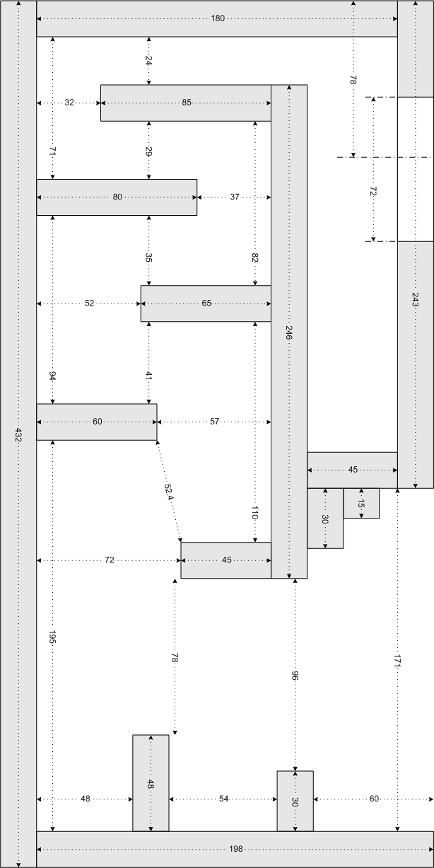

Here is the plan.
There appears to be two small pieces located in the upper mouth of the horn. I see them in finished enclosures, but they do not appear on the plan. Does anyone know the dimensions of these two pieces? I'm guessing that one is about 30mm tall, and the other is about 16mm.

I suspect the width of the front of the enclosure is 156mm, and the width of the all pieces that go between the sides is 124mm. This is slightly wider than some of the other guesses mentioned above. I'm basing my suspicions on several photos of the front of completed units, but it's difficult to find a good photo which is not skewed by camera angle. My suspicion is further confirmed by the distance of the center of the driver opening in relation to the top of the cabinet. The drawings I have seen indicate the driver center is 78mm from the top. It seems reasonable to me that the center would also be equidistant from the sides of the box, which would make the whole thing 156mm wide. I'm assuming the plywood used is supposed to be 16mm thick. Can anyone confirm or deny this? Does this tiny bit of extra width really make any appreciable difference in the tuning of the enclosure?

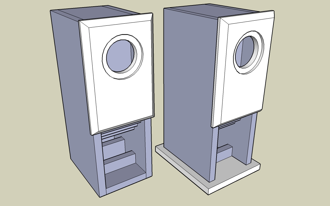

I sketched up a new dimensional drawing of the side of the enclosure. It is based primary on the drawing found earlier in this thread. I've also set out a possible layout for a single 2' x 6' piece of plywood. Perhaps if I am sufficiently inspired, I'll try to cut one of these out this weekend.

According to the Sketchup model posted earlier in the thread, the internal width is 120mm.

I keep going back to the design shown in post #6. Does it seem curious that the cross sectional area of the top piece (39mm x 120mm) is larger than the piece just below it (30mm x 120mm)?
I'm wondering if maybe all the pieces forming the resonator cavities should be shifted upwards by about 15~16mm. This would be the 85, 80, 65, 60, 45, and the 238mm pieces. In other words, the "39" measurement should be from the top side of the top piece. As it is shown, the "39" is drawn from the bottom side of the top piece.

Another thing - I'd really like to rescale the drawing to use 3/4" (~18mm) plywood instead of 5/8" (~15mm). Around here, it's very difficult to find finish grade plywood in 5/8" without resorting to mail order.
Which dimensions are critical to the design? I'll assume the front compression chamber needs to remain at the same 1085 cm^3 that it is now. What measurement is important in the resonators? Is it the 80mm/93mm/110mm that defines how the system responds? I could simply lengthen the 238mm center piece by 6mm to account for the added thickness of the ply and keep those spacings the same, but it will result in an increase of the overall volume of the back section of the enclosure. What is the significance of the length of the 85/80/65/60/45mm partitions? Would their lengths need to change? And how about the spacing between the center piece and the back wall? Should I increase the overall front-to-back distance of the enclosure to keep that spacing the same as it is now?

In my not-so-professional but semi-experienced opinion, rescaling for 3/4" material doesn't have to be as painful as your making it. When drawing it just add 1/4" to overall depth for every vertical panel, and again to height for every horizontal panel. The extra length and volume added should be insignificant. If going through the trouble of scaling and re-drawing, make the CC bigger while you're at it. I have found lots of success in varying the size of CCs through experimentation, and I can always decrease the volume if I begin a little big, but not the other way around. Hell, my interest in this little guy makes me want to re-draw it. I'll whip one up quick and post it in a bit...
Here's my re-scaled version. No fair peeking until you've posted yours - I want to compare unbiased results.

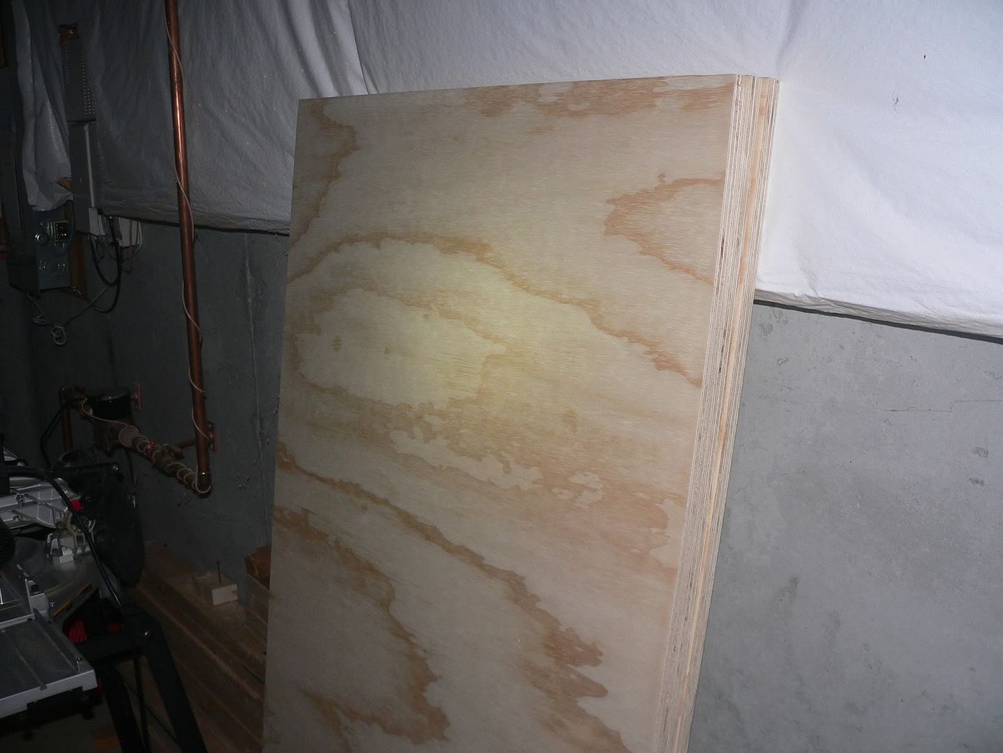

The plywood is waiting. I've got one full sheet, cut into thirds. It should be enough to build three pair of enclosures. I'm not sure what kind of wood, but it looks nice, rated AC and S2S. There doesn't seem to be much in the way of voids, either. The saw is hungry.
