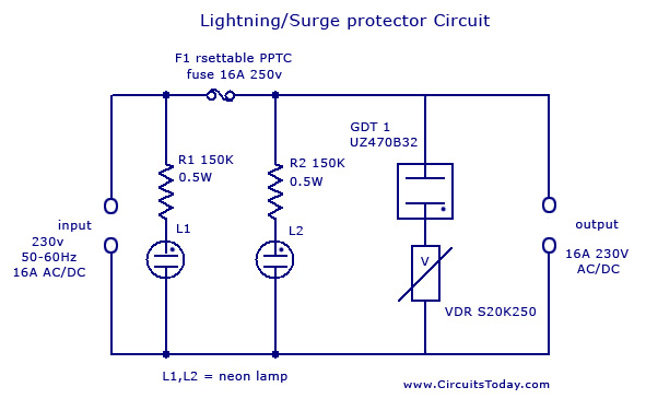

Considering that lightning season is upon us here in Australia I've decided to make my own lightning arrestor using expresspcb and some copper pcbs using the toner transfer method and an online project:
Lightning/Surge Protector Circuit Using Gas Discharge Tube (GDT)
Was wondering if there is anyway that I can improve the circuit to make it stronger and last longer or if its good enough as it is. I thought that the S20K250 MOV was rated a bit low? Any thoughts?
This circuit is designed for a 240v mains.
You are on a 240v system, right? The improved circuit you linked was for 120v systems in the USA. In our system we have neutral and hot. The neutral is bonded to earth in the service panel at the building power entry. So unless there is a fault, neutral is essentially ground. That is why they got away with a MOV across and only a spark-gap to earth.
If I am not mistaken, your 240v system has neither leg tied to earth. So two hots. Yes? So you need not only the MOV across, but I would think still protection to ground from each leg.

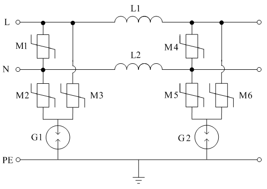

Right. I'm in 240v land.
I'm considering copying this design and using 250v rated components from the first schematic (GDT UZ470B & S20K250) that I posted in the first post. Let me know if there is any issues with doing this.
If anyone has a better circuit then please post it here.

A GDT alone should never be used Line-Line. Once triggered they are effectively a short.
An MOV has the nasty habit of catching fire when hit with a big surge. You need to use a thermal fuse in series or have a way of isolating the MOV from anything flammable.
Most surge protectors are junk. Even the average whole house type and even many "Industrial" Surge Protectors. The MOV they use are fairly wimpy and cannot handle the surge. One big surge and they die.
