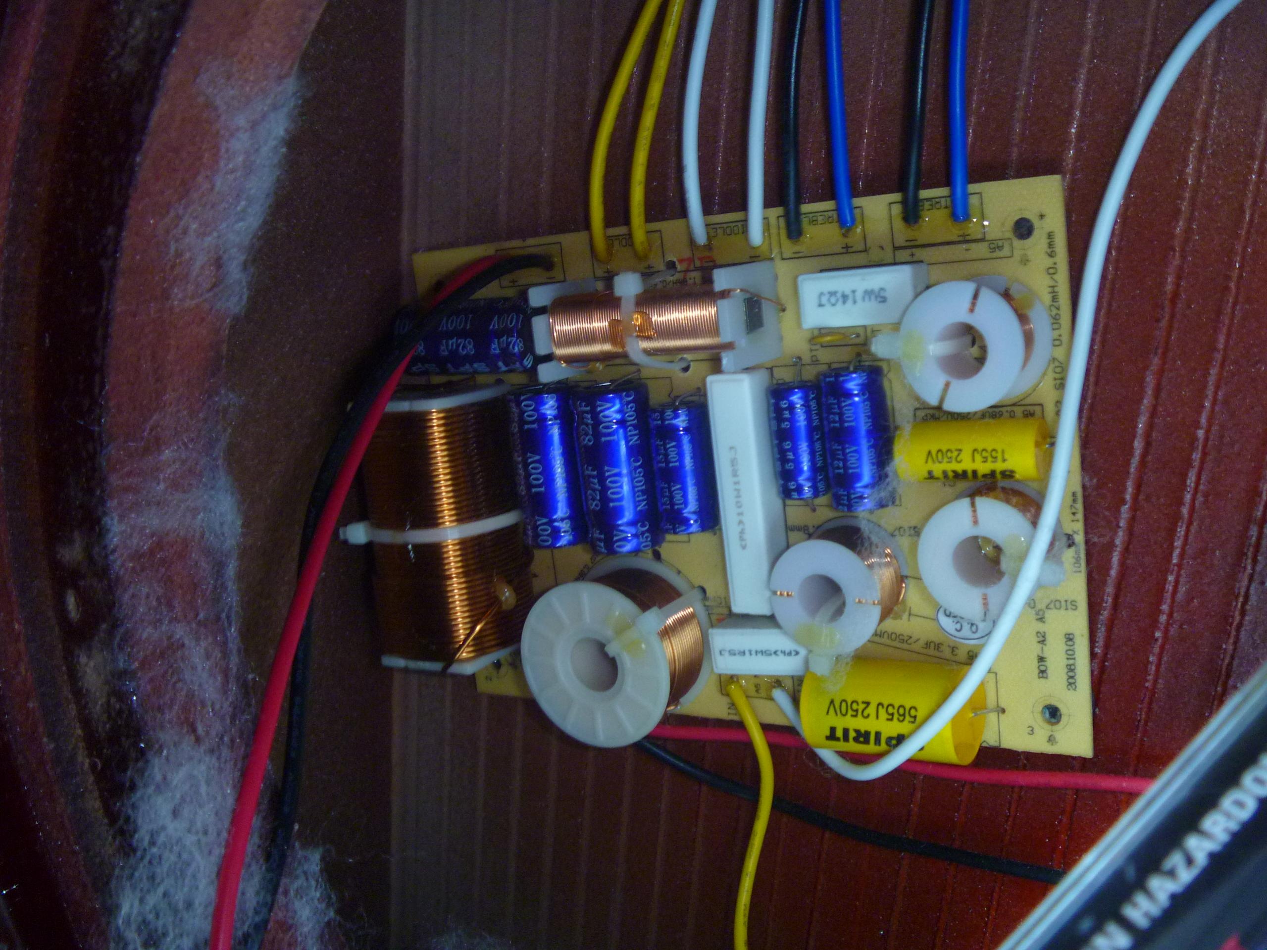

Good to finally be here after decades of Audio,I was wondering if i could get some input on making either the Ribbon or the UHF of this schematic play a little louder,they are somewhat laid back as of this set up,Thanks very much for any info,Regards, Michael
you can try removing R1, or bypass with a wire, or parallel with similar resistor

You would simply need to use a lower value for R1 or R2 to bring that driver level up. Dont really see how you could mess with the UHF, changing a cap or coil will mess with the crossover point and phase alignment.
You could even try removing the UHF altogether, and removing the LP side of the HF driver (L2/C2). Without measuring things you are going to have to experiment a lot.

What is the result after you shunt R1???? (experiment #1) Keep a series of good quality resistors of small value (< 1R5) for this test in case you need a smaller valu between 1R5 and 0 and the tweeter is to bright.
Another thing, R2 is there just for protection after the PTC fails nothing else. PTC also have small resistance in PTC mode and high resistence in protection mode, you don't need to know this, since you didn't try experiment #1 yet.
Should not be that difficult, after all, you have that 1R5 resistance in the way to play with.Good luck.

Gentlemen;I really appreciate the dedication and passion you have for the personal perfection of sound,One has to sit back and know the mod and certainly the equalizer will definately make some kind of difference,being a GM electrical specialist for 35 years,and being someone who can never let things left alone,I might do the resistor mod first,being it is simple and very easily reverseable.I do know that when i used EQ years back when recording vinyl to cassette-Yeah i know !- I believe it was a 10 band Teac then,It made an incredible difference,as some albums were very flat and some were very dynamic,to record the flat ones through EQ,it was my own mixed perfect reproduction,Same as today,many of my SACD's and HiRez tracks are cut to the mixers' tastes.and do need some kind of EQ. I can say for sure though the EQ. Art and Weltersys suggested, would surely give lots of control everywhere,Ill report back with results,Thank You for the info. Regards, Michael
R-1 Mod done

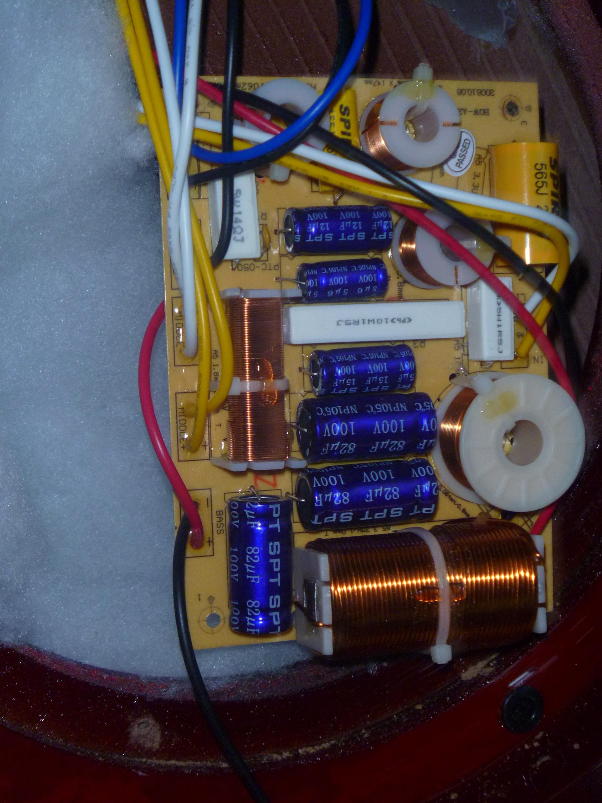

R1 was jumpered on opososing ct. board side,This made a significant improvement,subtle, yet,it now sounds like the ribbon disperses very wide now,no hissing or ringing.Just a wider 180 degree dispersion.The snap of snare drums sound way defined as the acoustical notes and decays.Let me know what you think of this Xover. I have used many of RBH sound components before,this set up looks interesting.On ELP's "From The Beginning"HiRez Flac.Is nothing short of stunning now,I can see how when listening to music as we go up in quality of components,musical instruments now become localized,as you can point what each musician is doing instead of a wall of sound.Very happy until i venture back w/EQ ,Thanks so much,Regards, Michael
R1 was jumpered on opososing ct. board side,This made a significant improvement...

So you just ran a wire from the + side of R1 to the L2 .084mH Inductor... Is this correct? And that is all that was done?
