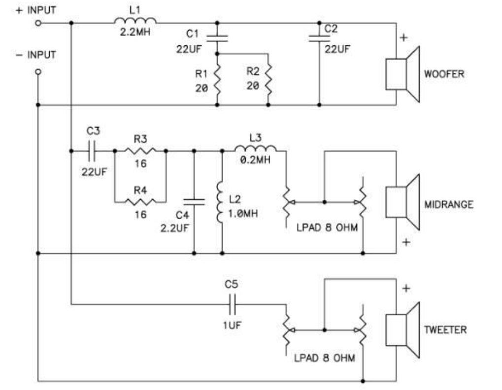

G'day Russell,
Yes - That's what I did. I made the crossovers based on that article and since installing them have noticed a much better soundstage, with voices coming from between the speakers instead of from them (if you get my drift! :-0) however there's something going on in the lower mid regiin that has them sounding a little 'cold'... IE; not 'warm' haha.
I'm going to try adding zobel networkd to the woofer and midrange horn, and if that doesn't give the result I'm after, I'll disconnect the 22uf filter cap in the low range network and see if the resulting broadening curve fixes the problem.

I know what you mean! I too have the same problem. I find its clear and all but the mid bass isn't right too cold.. If I go analogue it fixes it but still should be adressed.
What I am using is the nelson pass passive for mid and 077 tweeter and an electronic crossover for the 136a for sub. M6 electronic crossover is a tdm sledgehammer 24cx-2 which is a 24db slope I believe and I cross it at 1200hz which is what I am supposed to do I guess??? right? but......the nelson I believe is a 12db slope. Is that a problem for me?? do I need a new electronic crossover?

schematic
so here is a quick diagram. I also have 2 tweeters one for ambiance(back fireing) I just need to make sure if its 800hz or 1200hz. I know 800hz is stock but I think 1200hz is what I am supposed to use so the sub blends in with the passive mids/highs better. Or....should I just set it half way at 1050hz?
Im pretty sure I just need a 12db active xo which mine cant do
