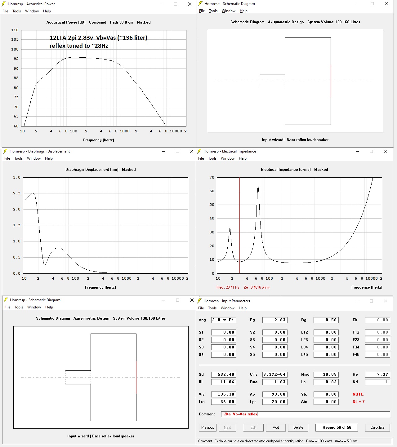

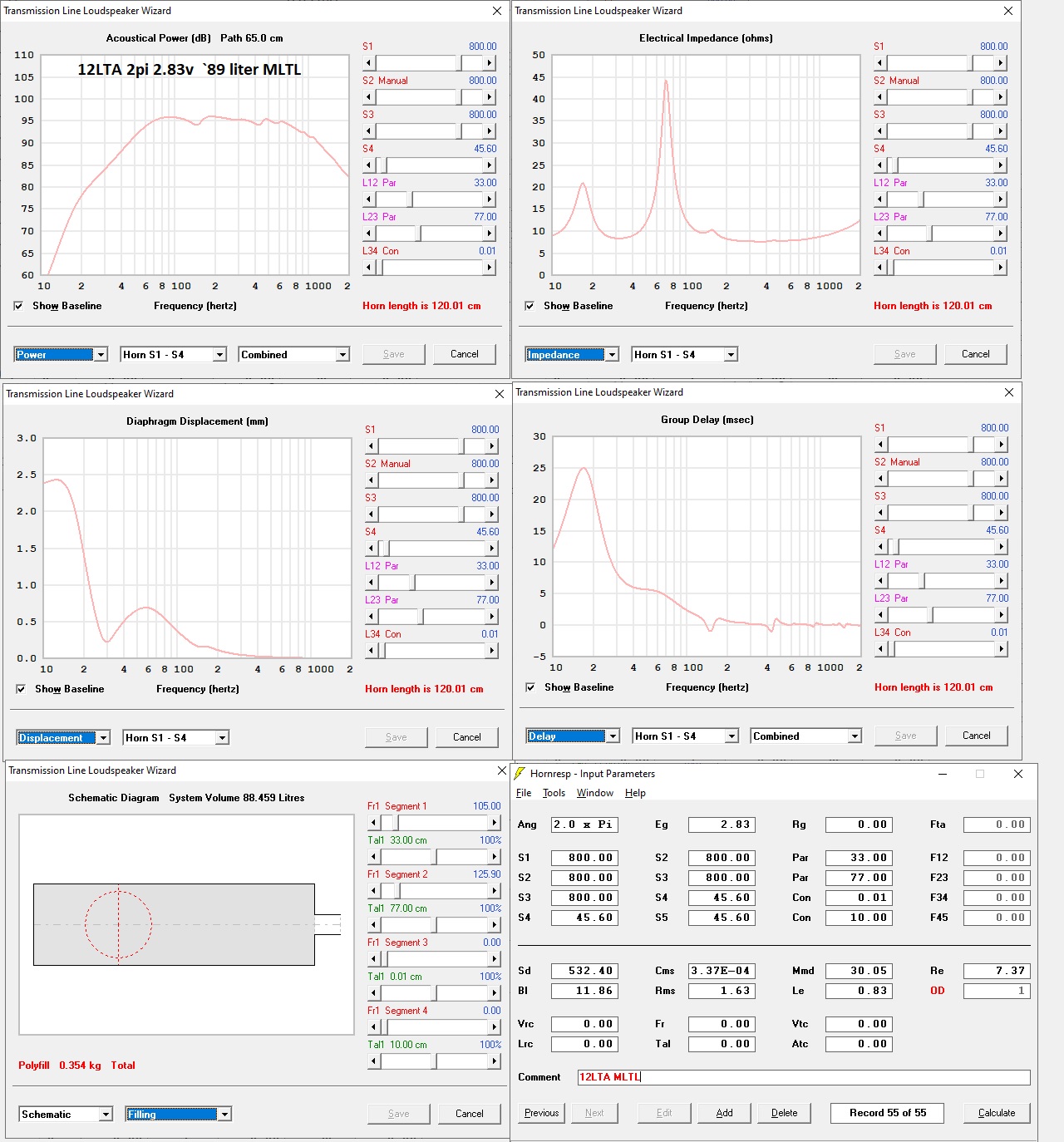

Hi guys, I'm going to be building a pair of big vented cabinets using the beta 12ltas, the Eminence ADS100Ss. I already have a tweeter cap and a notch filter for the 12ltas. What I've been struggling to find is any examples of the cabinets to use as a starting point. I know these speakers are not the best for bass, but from what I've read, they can sound good in the bass arena using a larger ported or vented cabinet. Could someone please point me in the right direction? Thanks... Bob
- couple of examples - 28Hz tuned Bass reflex = Vas (136.3 liters), then a 4 foot tall MLTL (think" Druid") of about 90 liter air space

Thanks so much! The druids are exactly what I'm trying to copy, soundwise, as I am a huge Zu audio fan. Is there any other info available or pictures, built cabinets / finished projects that used this 90l druid design? I'd love to see what was done before I design my cabinets. Thanks again!

My take on a mltl is you double the area needed for a standard 4th ported, but it has to be long based on transmission line theory.
I don't think I'm right though.
My 2x15's, i had them in a box half as small as it should be still porting at recommended 4th (30hz), worked fine.
12" full range wide open, you can get nice deep bass, just don't expect overall to be too loud without warbling. .
(Hammer had the same feeble magnet as stock 12LTA) re:88 liter - just something I would build 4ft tall and with Zu style. Dunno if a gaped base would tune to 28Hz but maybe (?)
There was no fill in this pipe so more ripple than would be if properly damped. The bottom of the column is fully open - the full cross sectional area letting the base do the tuning.
