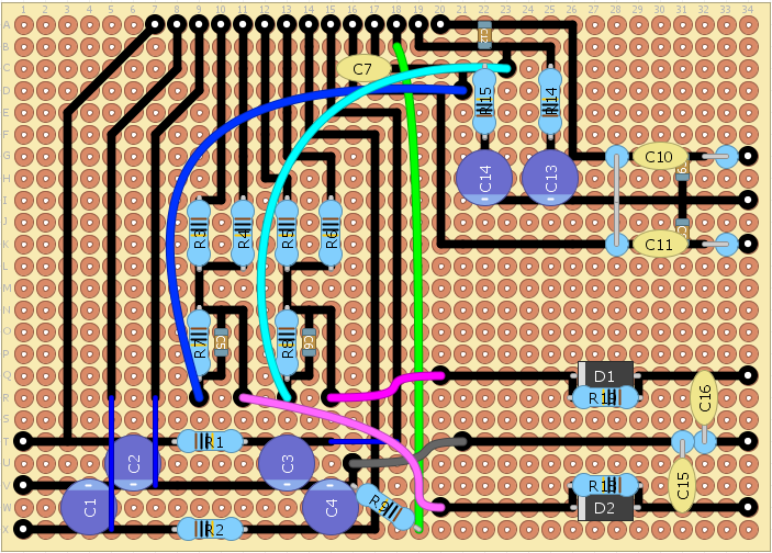

I design circuits for protoboards in Windows software called DIY Layout Creator, it`s a free software and I would recommend it to anyone that is looking for protoboard designer. I mastered it very fast.

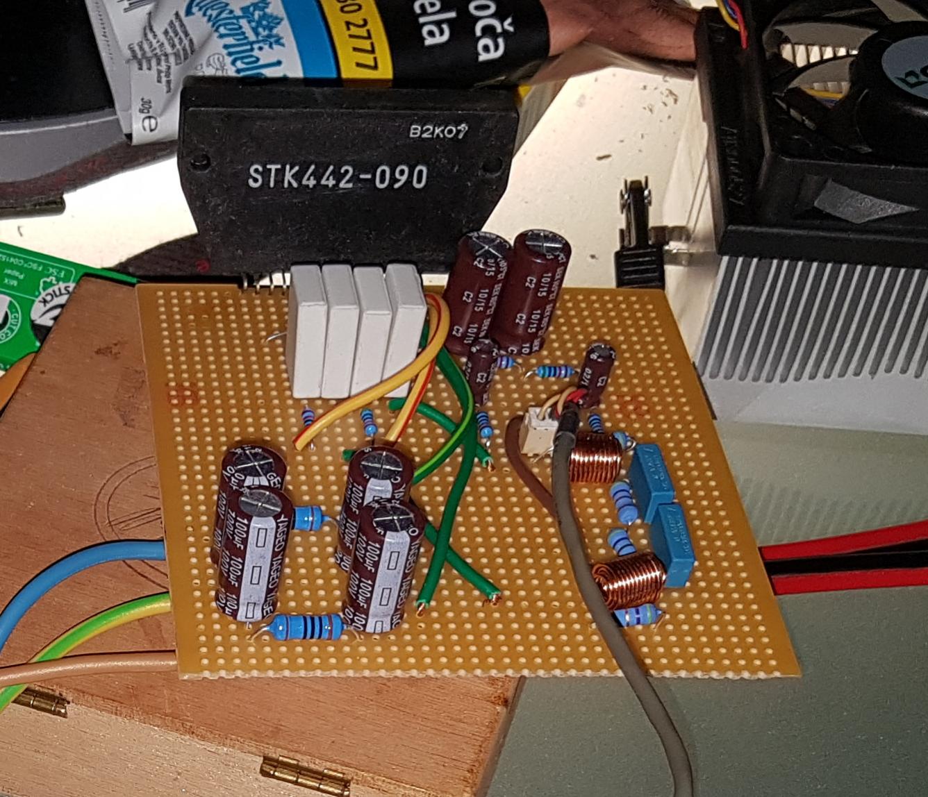

Here is the layout that I created for STK442-090 amplifier:
At first I tought that this schematic is way to complicated and that I will need to make pcb layout and create or order a pcb. After discovering this software and spending some time, creating and perfecting the board I called it job done. This was my first "big" project on protoboard.

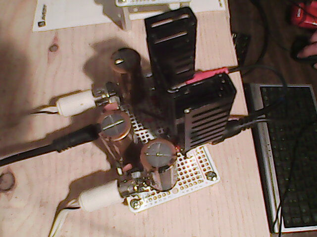

Here is the finished product (sorry but I don˙t have photos of underside of the board and it`s already mounted and finished in the enclosure):

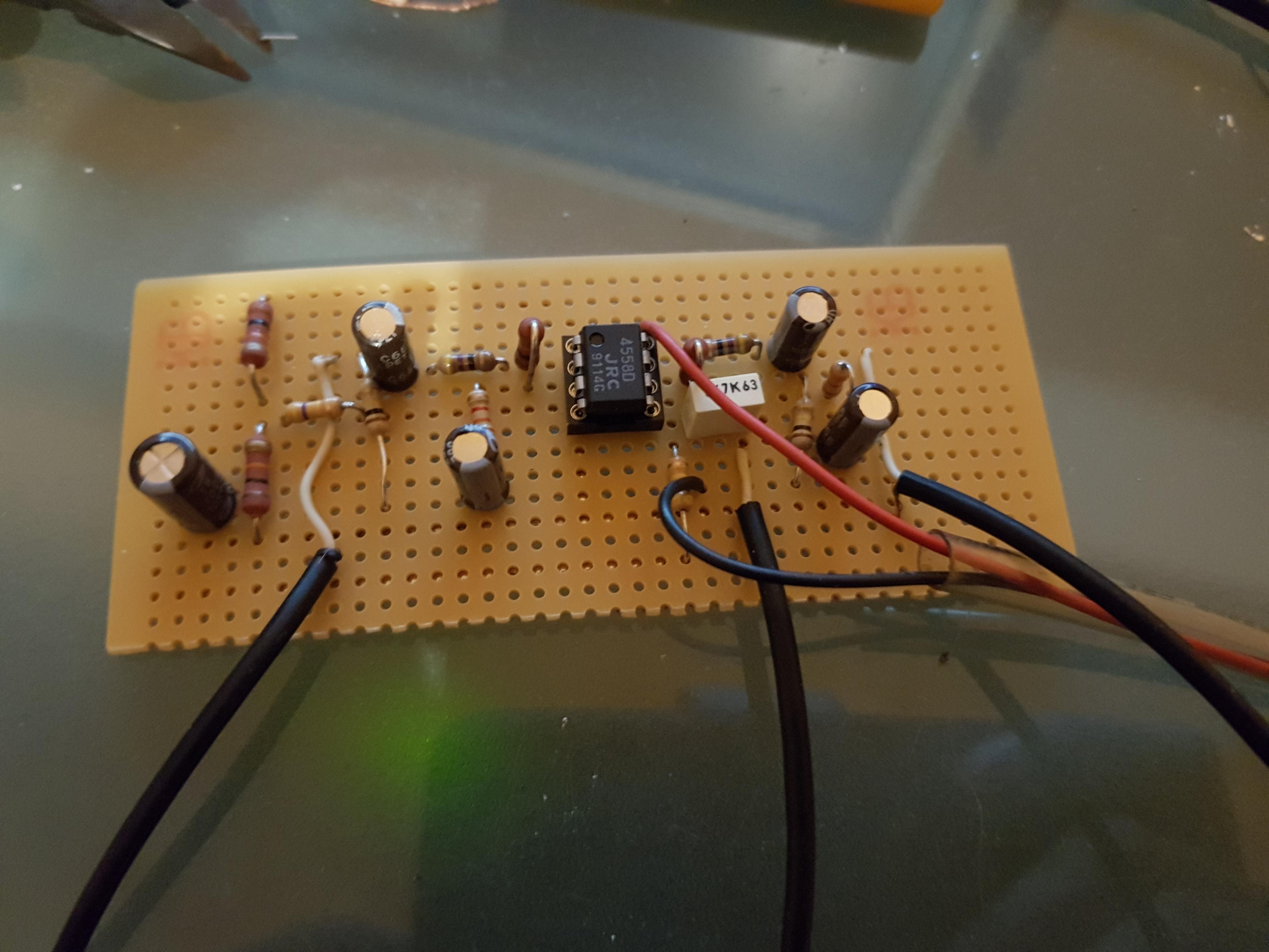

Here is another one, it`s a preamplifier (used to match consumer audio level to pro audio level, sorry I don`t have picture of underside of that either):
I will post pictures of traces on the underside in my first next project, I promise. I think that it will be 5band stereo EQ with gain control, low pass filter and bass boost, so this will be quite a lot.

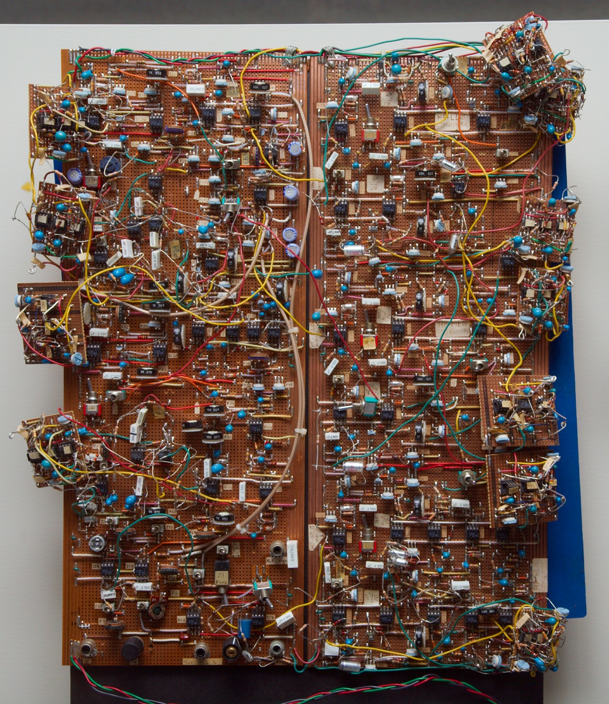

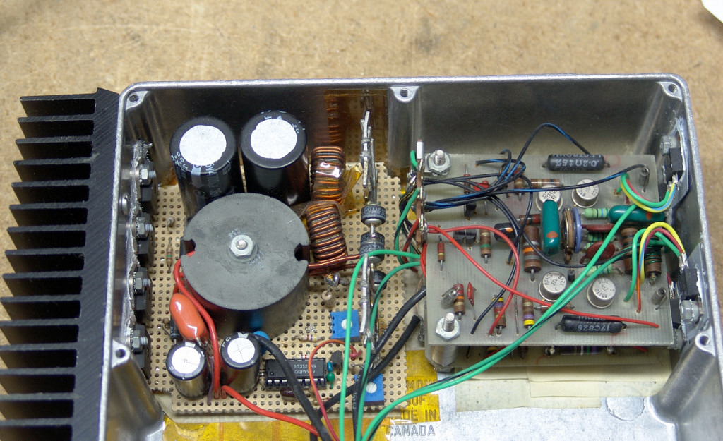

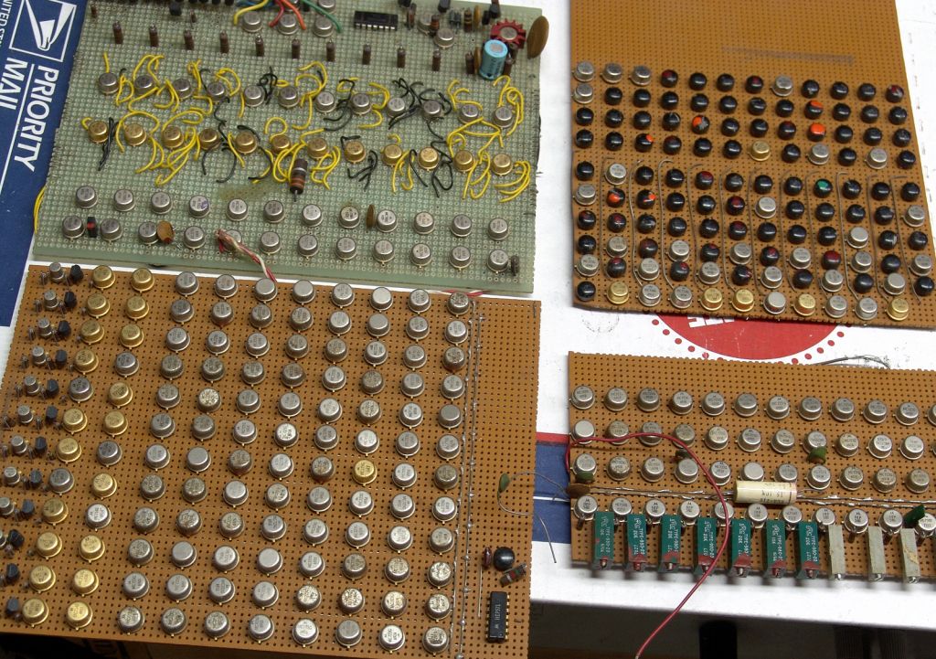

As PRR showed, nearly anything is possible on perf / proto board. It all depends on the builders level of patience. The first picture is of a digital music synthesizer I built around 1971. This used all RTL logic chips which contain a single gate or flip flop in an 8 pin can. There are over 300 such chips and 30 or so transistors all wired up with wire reclaimed fro some junk equipment. Could I do this today? No way!

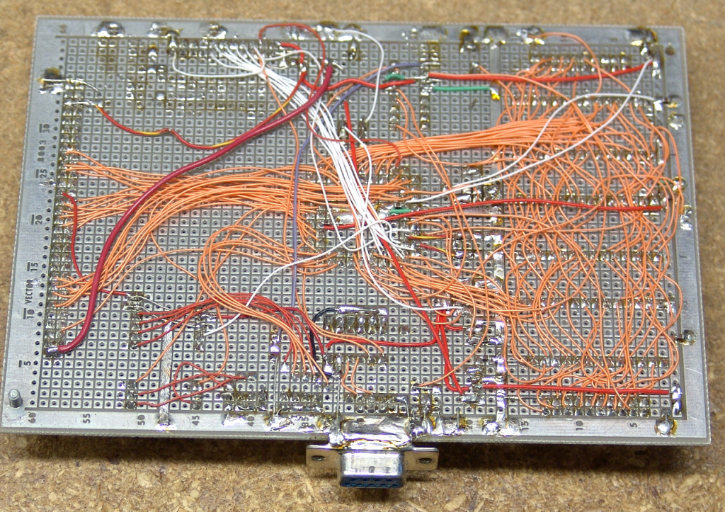

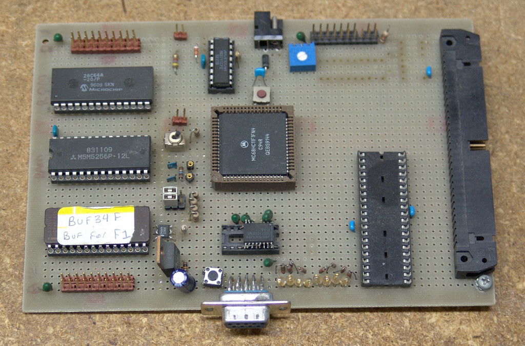

The 2nd and 3rd pictures are of a MC68HC11 SBC that I designed and built in the early 1990s. It was used to learn the "C" programming language as applied in an embedded controller environment. The higher quality perf board and high temp (Kynar I believe) wire wrap wire made this far easier than it looks.
The experience gained led to the EFI boost controller design (4th pic) used on a high performance car to "fake out" the on board electronics in order to make mor power by turning up the turbo boost.

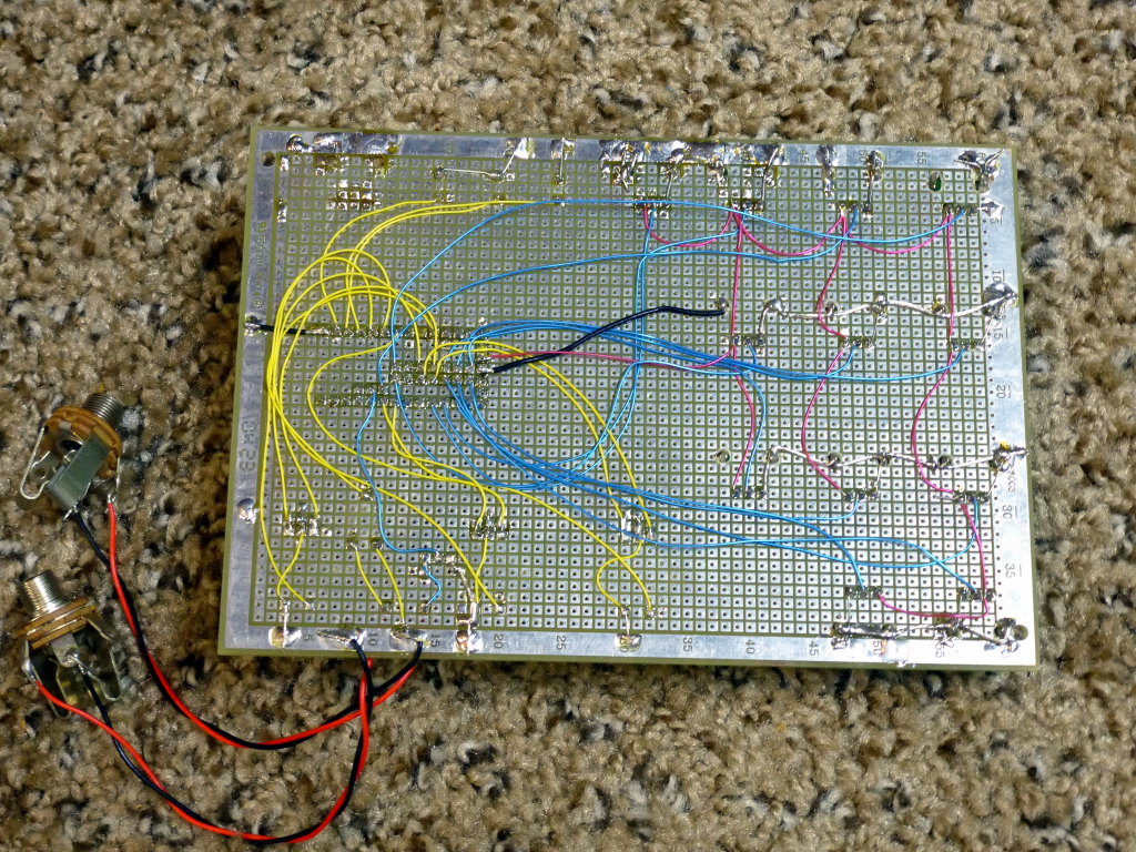

The 5th picture shows an early SMPS boost converter that used an SG3525 controller chip and 4 fat mosfets to make +/- 40 volts to run 4 X Plastic Tiger boards for the main outputs and 1 X Universal Tiger for the subwoofer in a car stereo amp. Only 2 X Plastic Tiger boards are in place when this picture was made.
This was built for my class project when I went to college at age 40. Surrounded by young students the teacher asked us to come up with a project, state its design goals and measurement criteria early in the class. Our grade would be determined by how well we met the goals. I stated that I was going to build a loud car stereo, and the teacher's head would hit the roof of my car when I turned it on........I got an "A".

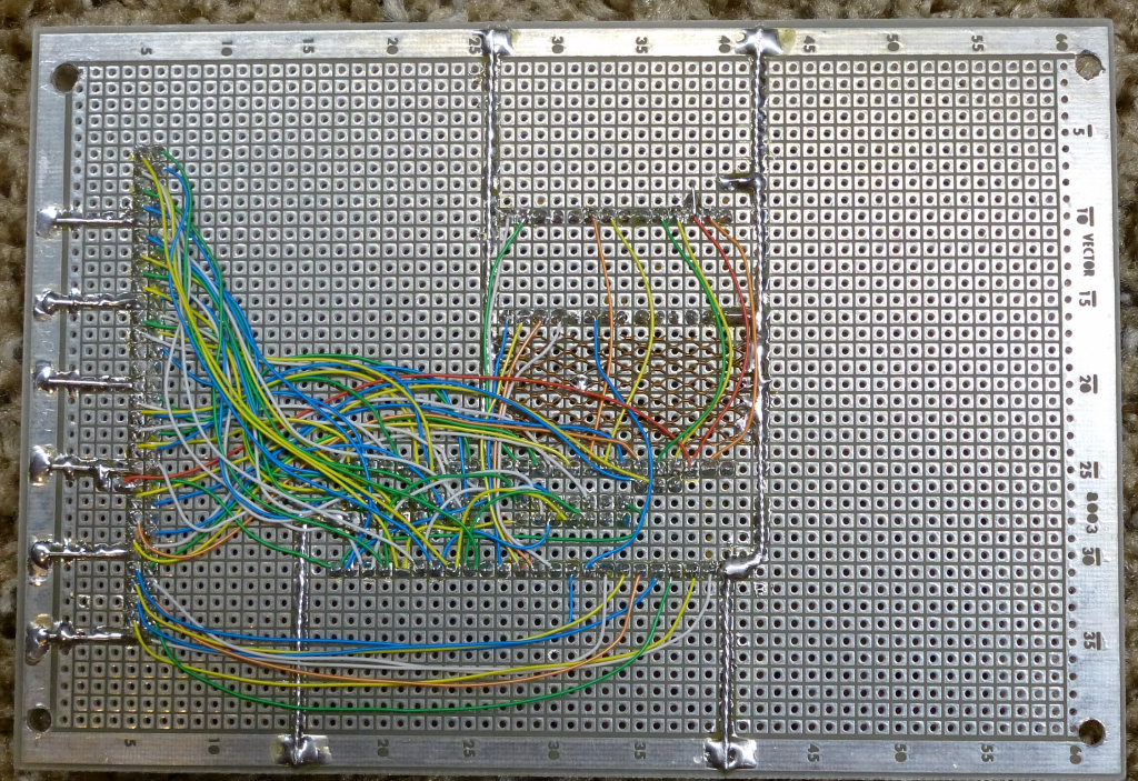

The 6th and 7th pictures are of a little digital music synthesizer I built a couple of years ago. As you can see the Vector board and wire wrap techniques haven't changed in nearly 30 years. That's because they work well for me.

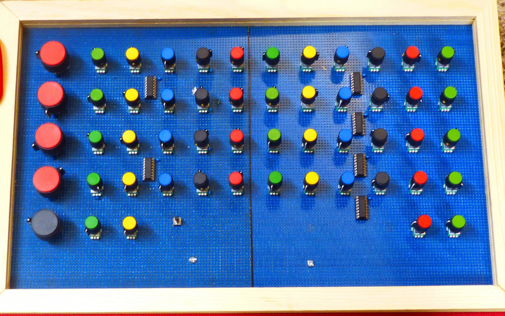

Pictures 8,9 and 10 are of a small "virtual analog music synthesizer I made using perf board. It can be seen in test here. There have been several software revisions since that video was made and there is now a music keyboard attached. A new video is in the works, but a software bug still eludes my capture and execution.

what is the recommend way to put a ground bus on a perfboard?
when i use a breadboard i usually use one of the "power" rails for ground and make all the ground connections to that one rail.
would it be good practise to have a bare wire running along the outer edge of the board as a ground rail? better to have a rail on each side (like on a breadboard)? any recommendations or ideas?
thanks!
sorry if that question sound silly but i'm only getting started working with perf boards.

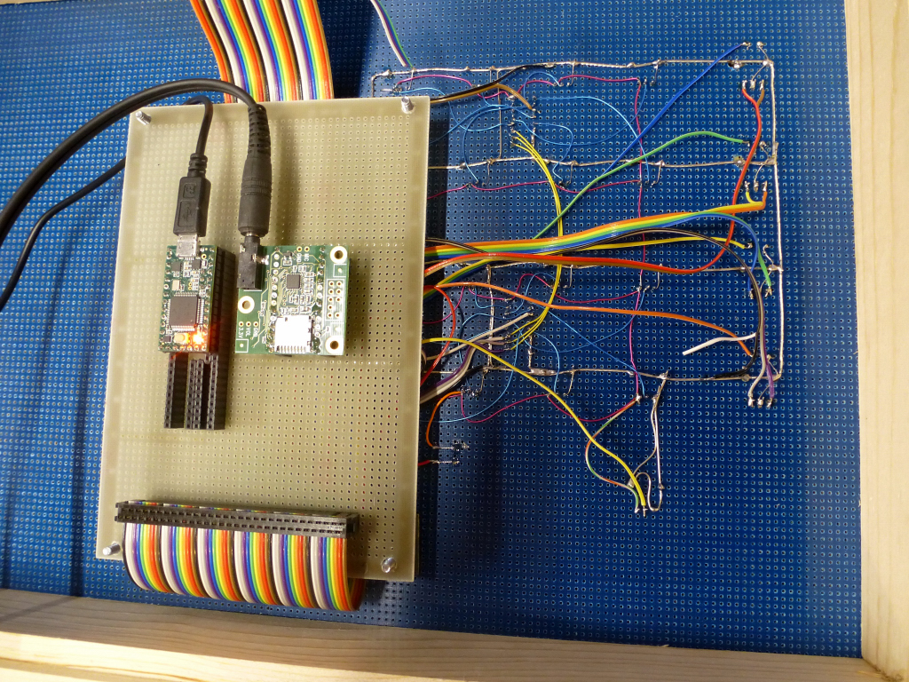

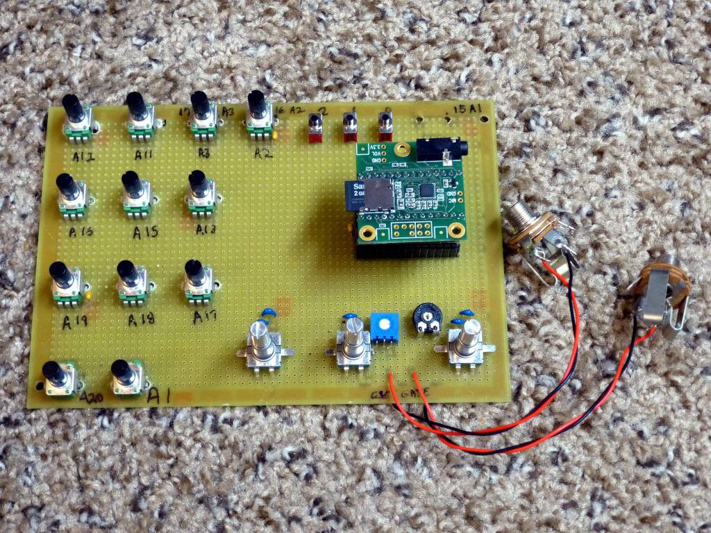

Look at the second and third picture in post 11, the side with the red and orange wire. I used some tinned flat strip that's 1/8 inch wide for the ground bus that feeds Eprom and Sram. Ground bounce was a problem withe these early chips and the flat stuff works great.
The music synthesizer in the last three pictures uses ordinary tinned wire for the ground bus. The blue board contains pots and rotary encoders so relatively thin wire in a 2 X 4 grid worked fine. The red wire wrap wire is the 3.3V B+.
The Vector board (middle picture) runs a Teensy 3.6 Arduino compatible micro computer and a 44/16 stereo interface, the two small plug in boards. There is a thick ground wire running from each board to the edge ground, and a small piece of copper screen connecting all the grounds together. This helps keep the digital noise out of the audio.
