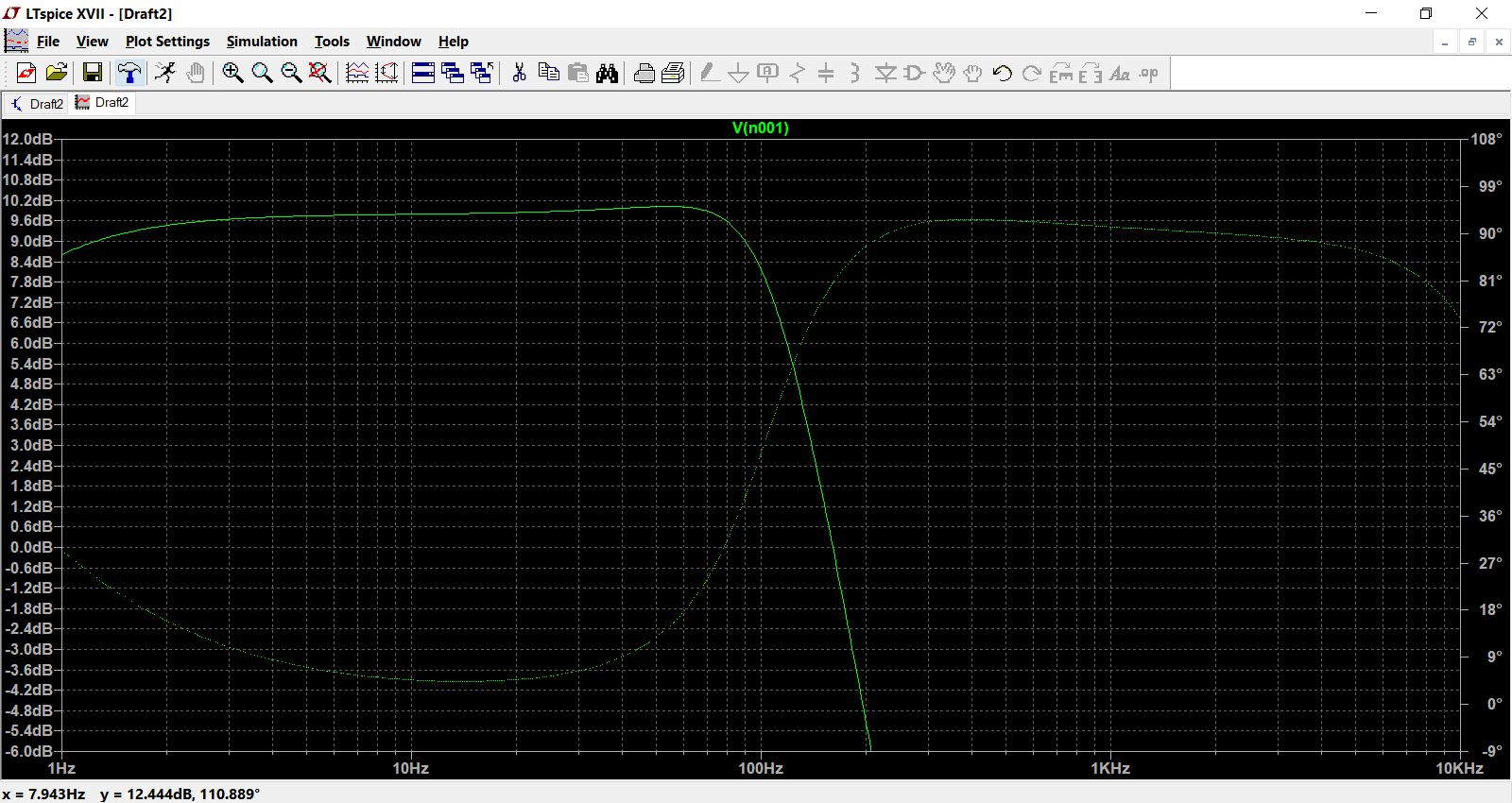

It's about time that I learn making simulations with LTspice.
They'll do the jobI used what I had at home. I won't be able to get new components till the end of holydays and I need crossover for new years party. It doesen't sound bad.
Just click my signature line to see how its done
Here is the file in case you want a play. It will run straight off in LTIV or LTXVII
Thank you I will start tomorrow.

You don't need to learn a simulator to determine whether a passive RC filter is working for you or against you.
Just use the standard formula to predict frequency F-3dB = 1 / { 2 Pi RC }
Or turn that around to find a suitable RC = 1 / { 2 Pi Freq }
