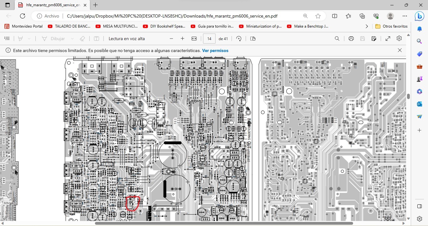

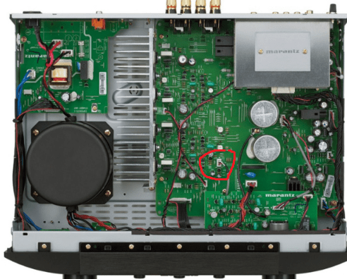

I show tab where the signal cable from the preamplifier to the power input arrives.

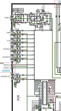

You will first need the schematic, to locate where the volume controlled, buffered line output is located. From there you can go out.
Going in: this is a direct input to the main amp. It will easily humm, buzz or worse.
It is also mandatory here, to get an idea of the input schematic. It should have a filter, to keep unwanted high frequency signals out, maybe also a capacitor in series to couple only AC.
Can you locate and identify these?
Easiest is indeed to :
Remove the cable that goes to the input of the main amplifier pcb N6001, from the volume pcb connector B1003.
Connect a coax cable to B1003 for output, the cable soldered to N6001 is the main input.
The input is muted, ac coupled as well as rf-filtered just as any ordinary amplifier does.
