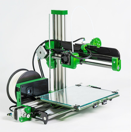

I wonder if it would be possible to use this to print a thin layer of plastic onto the board then etch it in the normal manner.
Buy 3D Printers RepRapPro Ormerod Full 3D Printer Kit RepRapPro Ormerod 384 online from RS for next day delivery.
*Maybe*.
Essentially the same as iron-on transfer from a Laser print, where you also transfer a thin molten plastic layer to the copper surface.
I fear the 3D printer molten plastic may not stick too well to a cold shiny bright copper surface.
Of course, in its original application it sticks well to itself.
Sticking molten plastic to more of it which was still molten 5 seconds ago is *much* easier.
