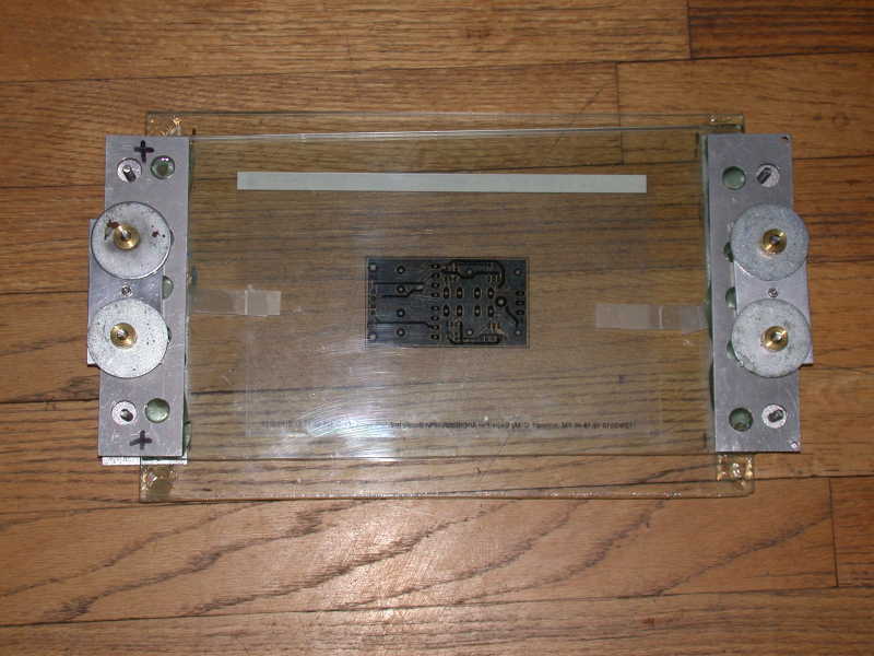

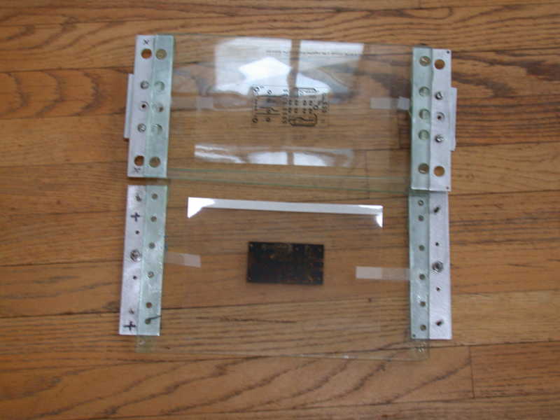

The system I've settled on is the photo sensitive board process, it makes the finest traces and best overall boards for me. I had a lot of trouble with the positive transparencies used to expose the boards. Originally I used a HP laser printer with transparency film but on double boards I had problems with alignment of the upper and lower traces because, out of the printer, they were not the same size and thus didn't match leaving the holes off from one layer to the next. It may have been my older HP 1100 laser printer but my hunch was that the heat required to etch the printing created dimensional problems in the final transparency. Worse was the drill file that went to my CNC, I could never get the dimensional accuracy for the CNC with laser and the boards would come out drill 'off hole' if the board was over 3 or 4 inches long.
Today I use a HP 8500 inkjet with inkjet transparency film from HP. This works perfectly with exact dimensional stability.
To align my layers I made a jig out of two pieces of 1/4" glass. Each layer is taped to one plate of glass and the two plates are aligned and tightened down. I've included pictures of the frame.
