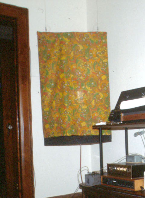

My ESL panels have sheets of lovely paisley fabric thrown over them. Happily, with REW test sweeps you can know exactly what effects a speaker cover has (zilch for my fabric).
Best stereo image I ever got was from a set-up with a curtain scrim hiding the entire wall of gear. Yes, we love to look at our handiwork but...
Here's a picture from 1979. About 30 x 48 inches. Same cloth today, on same panels, but floor standing.

Narkotic:
Finding a local person to do the manufacturing makes sense, but you’ll still need to decide what sorts of designs strike your fancy—and that process can be assisted by folks from around the globe. Even if you feel you can’t design from scratch, I’m guessing you know which designs do, and which designs don’t, suit you. Maybe sharing some photos of the good, bad, and ugly, as you see them, would help others contribute more costructively to your quest. Once it’s more clear what you’re after it’ll be easier to help you get there.
