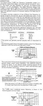

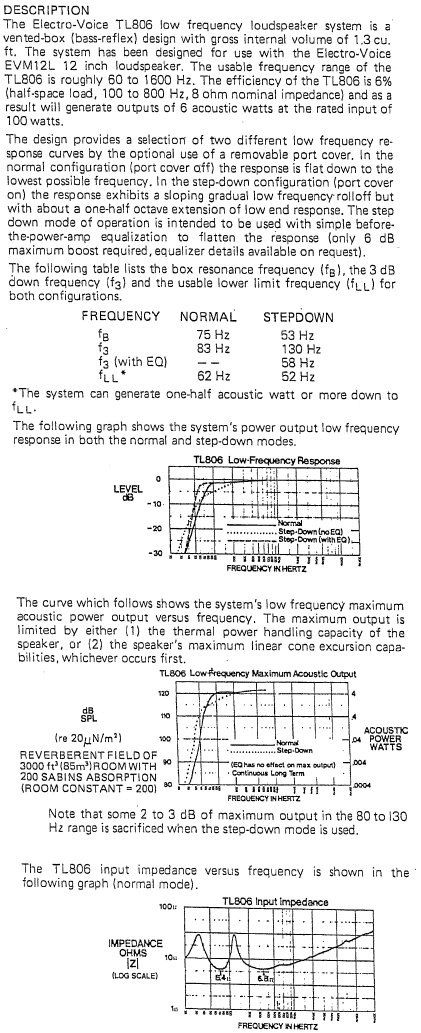

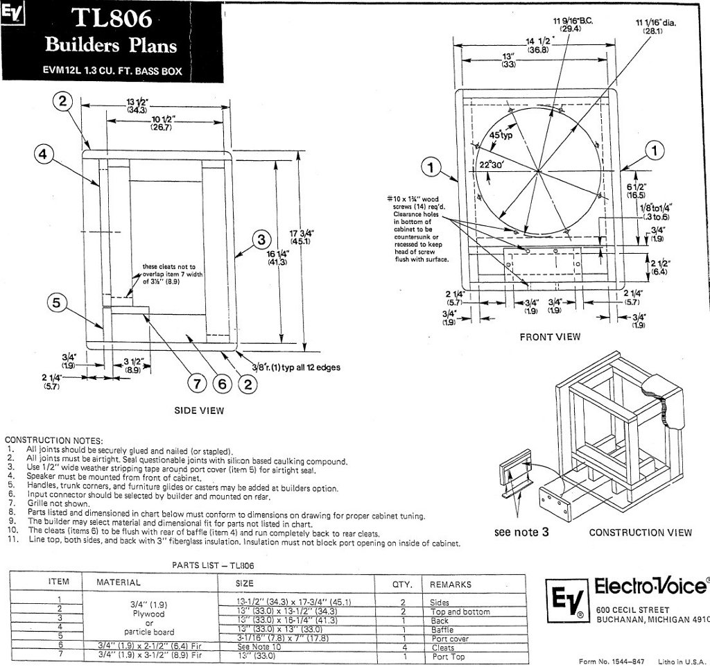

Here's one that I built earlier this year. It's the TL806 cabinet from an old Electrovoice data sheet (hope that I'm not violating anybody's copyright by adding it :innocent: ).
I used 21mm MDF and changed the external dimensions to keep the internal volume as in the plans. It came out quite nice. :eguitar:
So far I have only tested it with an external amp. I still have to complete the electronics to go with it. :eek:
