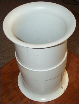

You might be interested in the work I've done on flared ports.
I only used a circular profile for the flares, but the writeup on using a heat gun over a mold could be useful, as could the test results.
Follow the links at
http://www.users.bigpond.com/bcolliso/port-flares.htm
For 6 inch PVC pipe I found that 30mm flare radius was the best I could obtain before splitting became a problem. Here's a photo of it....
Follow the links at

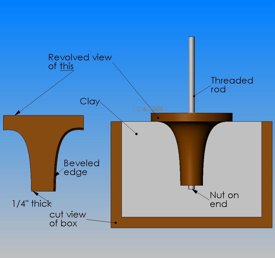

If I were to make flares I would make a flare cutter out of wood and fill a box with clay and after chucking the cutter into a drill press I would feed it in to get the desired shape. The design requires knowing the thickness of the material you want to lay in and oversizing the hole accordingly. You can attach sand paper to a smaller bit and use it for finishing/polishing.
EDIT: Typo, the cutter should be ~3/4", not 1/4" -oops
