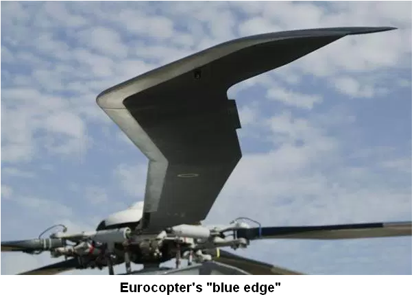

Ref propeller noise reduction, for chatting level, ducting the small diameter rotors would have been a good suggestion (uniform blade loading, efficiency increase), if ducting wouldn’t require rotor higher rpm to show it’s benefits, which generates other noise issues.
Fan rotor noise is a complex subject with many variables and a few decisions to be taken. Refined blade geometry is usually adopted, forward/backward swept blades, even adding winglets (no free lunch as always).
A lot of serious reading is required
Leading Edge: Quiet Please - Rotor & Wing International
http://drum.lib.umd.edu/bitstream/1903/8752/1/umi-umd-5771.pdf
https://dspace-erf.nlr.nl/xmlui/bitstream/handle/20.500.11881/1779/ERF 1981-04.pdf?sequence=1
https://ntrs.nasa.gov/archive/nasa/casi.ntrs.nasa.gov/19840010982.pdf
https://ntrs.nasa.gov/archive/nasa/casi.ntrs.nasa.gov/19810013374.pdf
https://ntrs.nasa.gov/archive/nasa/casi.ntrs.nasa.gov/19770012126.pdf
https://ntrs.nasa.gov/archive/nasa/casi.ntrs.nasa.gov/19960008053.pdf
George
