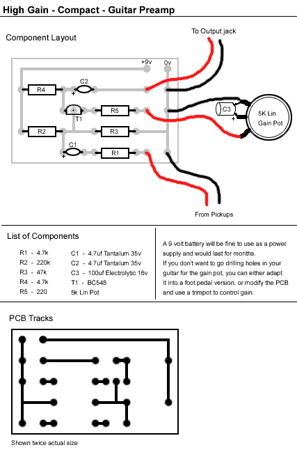

in my search for some circuits for help with my preamp design i came across the circuit shown below.
My preamp is going to have
Passive/Active DPDT switch
Tone (pasive and active)
Bass and treble stacked pot (Active)
Mid with mid sweep stacked pot (Active)
Volume
Blend
I plan on taking the pickups into the blend pot then to the input (im going to change out the boost switch in the circuit for a trim pot that will go on the board) then throught to the preamp and EQ.
Where would i add the tone pot and the passive/active switch in this circuit?
How would i alter the "Mid" section to include a mid sweep?

forgot to attatch the image DOH!
O.K. well I went to radio shack (doh!!) and bought the parts I need to build this. However the T1 calls for a BC548. the closest thing I could find was a PN2907. Do I have anything to consider before wiring this up ?
