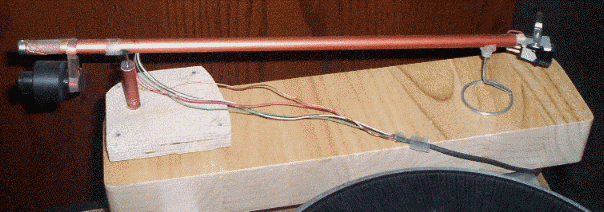

I use a unipivot arm made from a section of fishing rod.
A very stiff section from a beach caster which has a nice taper.
The cartridge end is a piece of 2mm Tufnol sheet Araldited to the arm.
The back end is an 8mm stainless steel rod Araldited into the arm.
To make the pivot I drilled a hole half way through the arm into the stainless & polished it to a cone.
The pivot is a tungten ball, ball bearing pen tip washed out & lubricated.
Then around the pivot point is a heavy collar which takes the point of balance below the pivot point.
The balance weight is also well below center.
Bias is a Lenco weight & spiral.

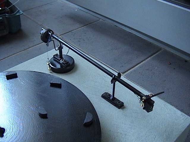

Since this thread has started up again, here's what I made from a section of carbon tent pole, and has been in service for over a year. It's a little heavier than an arrow, and perhaps a fishing rod, but as far as my deaf ears are concerned, it sounds good. Very clean. My next upgrade will be the platter bearing as the current one rumbles.
The azimuth is adjusted by rotating the counterweight 'washers'.

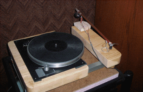

It sounds a great deal better executed than mine!
I stuck an old machine screw in an electric drill and vice and 'hand turned' the uni pivot with a file. I think the off-cut thread became the counter weight screw, epoxied in the corbon shaft.
About 6 washers drilled off centre is the counterweight. Anti skate is a bit of bent wire and a piece of thread with a weight on it.
Talk about rough... I drilled one side of the carbon tube for the unipivot to enter, and the point of the pivot sits in the divot the drill made on the opposite wall of the tube. No proper bush.
I roughly filed flats on opposing sides of the tube end for the cartidge and clamp/handle.
Still... it works.
Still... it works.
