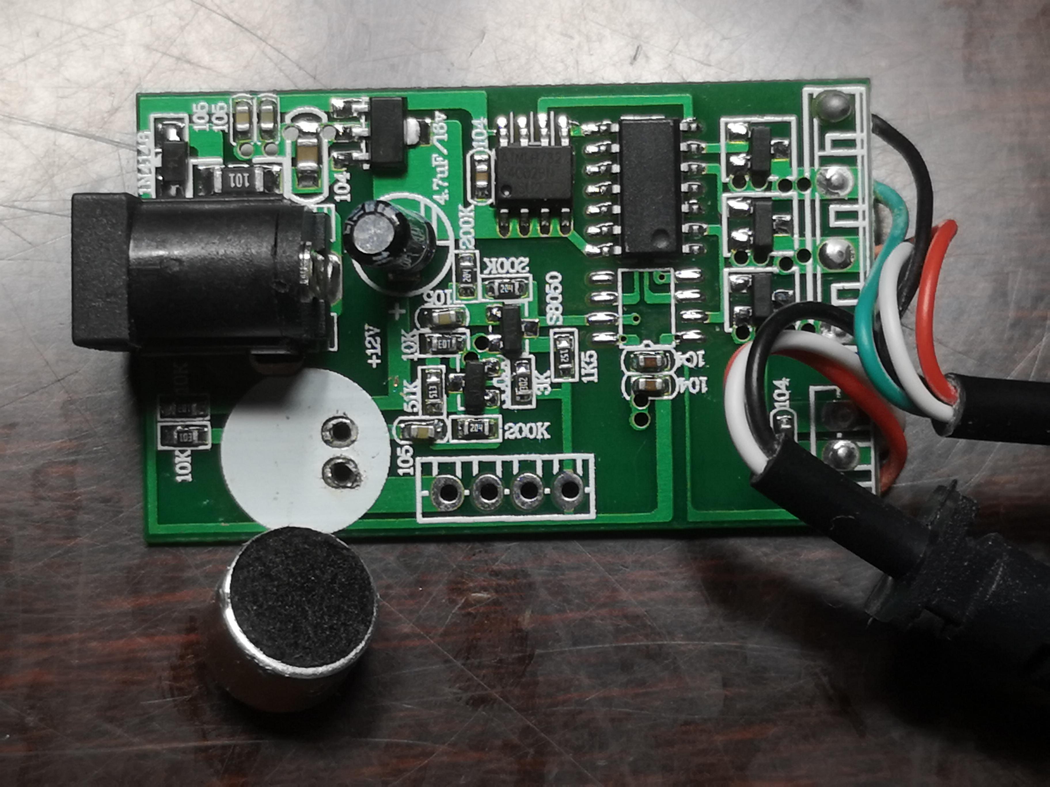

So I went and bought the LED music controller I mentioned above. I was thinking that maybe I could take off the built-in mic, and wire the terminals to the sound output of my PC.
Well, it didn't work, lol. I tested the thingy before I opened it up, and everything was working as it should. So I de-soldered the mic, and got 2 terminals on the pcb. Now the strange part was, even if I only touched one of the terminals with an open wire (not connected to anything), the LED started blinking randomly. I have recorded a video showing what I meant: YouTube
I'm guessing I'm missing a component in between the wire to the terminal? A transistor or something, maybe?

Meanwhile, I'm thinking of doing 2 version, this version (because it's simple), and modifying the LED music controller with the built-in mic.
Anybody have any idea on how to replace the built-in mic with an AUX input? As of now, even if I just touch one of the terminal with a blank wire, it will light up the LED, blinking randomly. I don't know if it's too sensitive or something.

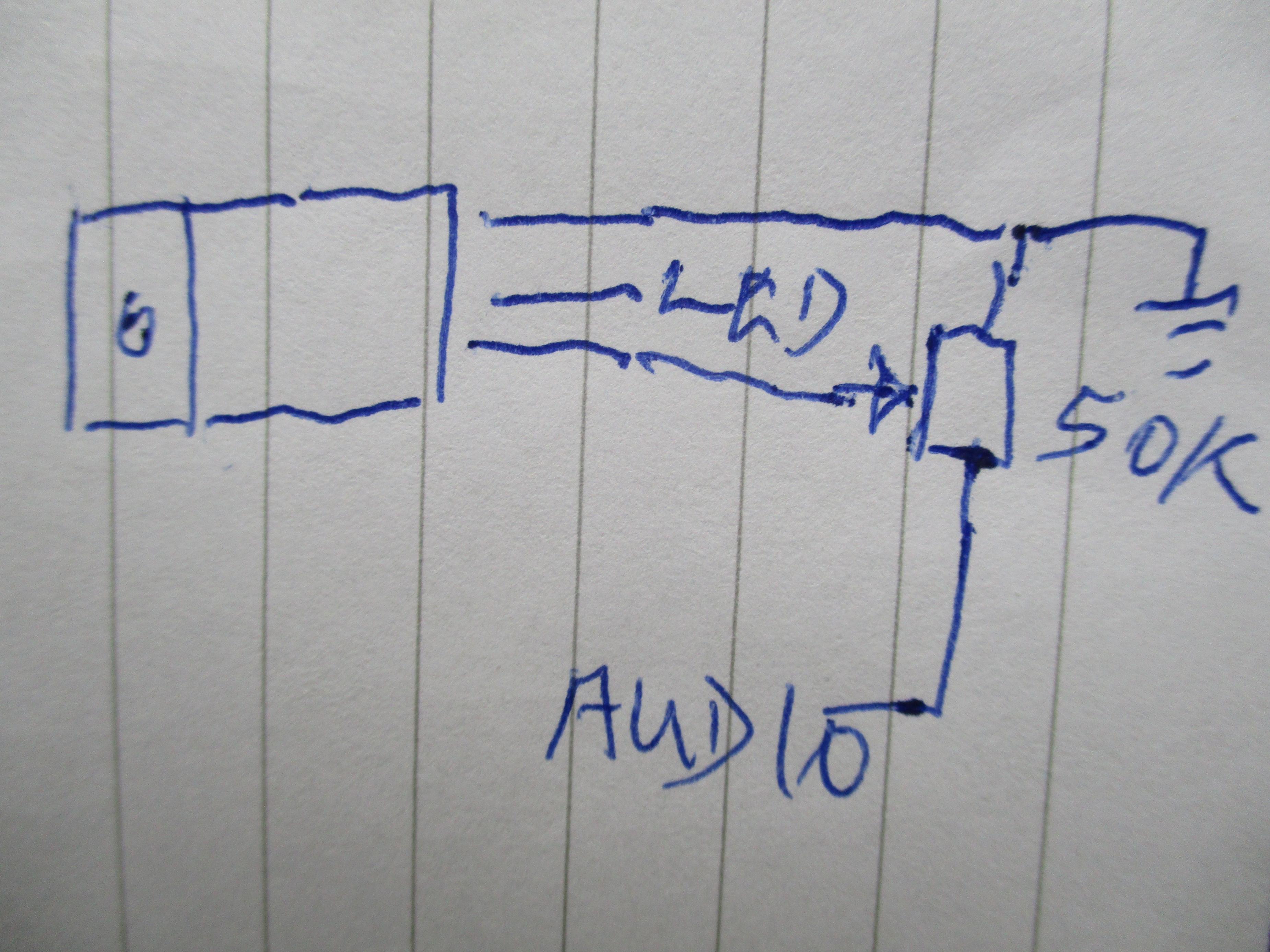

The components arrived, and I tried assembling to the best of my understanding. Well, it didn't work though. I must be wrong somewhere.
I used an IRF840, and a 50k variable resistor. I didn't use any diode, because you said it may be able to work without a diode. I also don't have a breadboard, so I just soldered the stuffs with some jumper wires.
Tried using an aux cable, plugged to my phone, didn't work. Tried using an earphone amplifier in between, still didn't work. So where did I go wrong?

The audio should go to the third terminal on the pot.
While you have got the wires off the gate try touching between the tab on the IRF840 and the gate with a wet finger. The LEDs should light up and then dim slowly. 12 volts will not bight you.
You can also drive the gate with a meter on diode test range.
Once the pot is connected correctly the LED will dim quickly.

Hi, not sure if I follow. If I connect the wires on the pot to the 2 furthermost posts, wouldn't the resistor value be constant (in this case, 50k)? Let's say the terminals are labeled A-B-C, which terminals should I connect the wires and the gate and drain to?
As of now (without changing anything from the picture above):
- when I plug in power, the LED lights up. I can't dim it by adjusting the pot
- when I plug in the audio jack, the LED dims. I can control the brightness a bit by adjusting the pot
- when I set the pot to barely dim light, and I play music, the LED lights up, but stays that way. When I pause the music, the LED stays that way for about 2-3 seconds, then go back dim

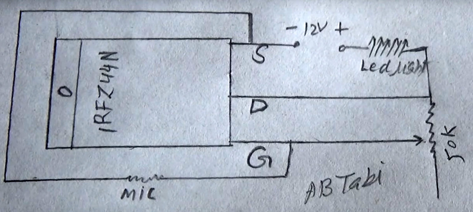

I built (soldered) it based on this schematic I found on youtube, with AUX input in place of the mic.

Try a 10K pot and find out the resistor ratio needed for making an attenuator pad.
Remove also the Mic Bias resistor. (10K on the left perhaps, It should be connected to the supply).
Hi, thank you for the reply. I tried using a 50k pot, and the LED still blink randomly, even without anything connecting to it but the pot's terminal. Havent tried removing the 10K resistor on the PCB yet. I tried to find the route leading to the power supply, but I just couldn't. I just can't see which goes where on the PCB....
