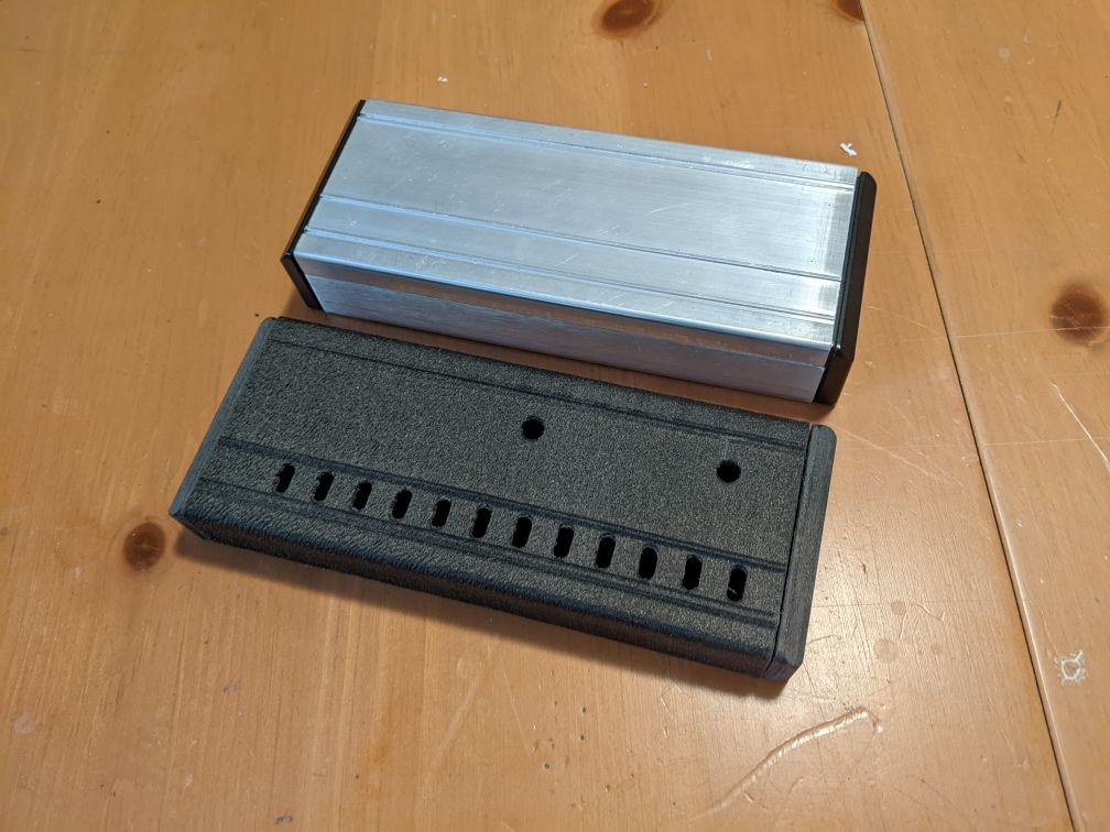

AcoustatAnswerMan, et al. I have received your IRIS remote case and I have finished a reversed engineered 3d model of the case.
Thankyou for providing this.
I've made two models. One is the original dimensions, the other is a slimmer and more contemporary design.
The original design would be for those who wish to reproduce exactly the original IRIS remote and are using original electronics.
The slim design is a reduced thickness version that is just able to accommodate the diameter of a 18650 lithium ion battery.
I don't intend to utilize the original case I have received from AcoustatAnswerMan, other than to use it to create these 3d models. The case I received does not have all the holes bored for the switches and potentiometers. Since the case is aluminum, I don't feel like machining all these holes required for the potentiometers and push buttons.
It is far easier to 3d print a duplicate with the holes already part of the 3d model.
I am 3d printing the case as I write this and I will post the model on thingiverse.com shortly. I will provide a link to these files.

Getting there... Top is original Hafler and below is the 3d printed "slim version". I used a glass reinforced ABS but the finish is kind of rough. I think I might print another print in plain ABS. Takes a while to print - 12 hours. I think there may be some things I can do to the model to make it print faster.

The slim case looks exceptionally good. Do you have a plan for reproducing the shiny plastic function overlay? I've seen those come up on the bay from time to time as hidden parts caches get liquidated, but I think it would be better to have a new one to go with the new case.Getting there... Top is original Hafler and below is the 3d printed "slim version". I used a glass reinforced ABS but the finish is kind of rough. I think I might print another print in plain ABS. Takes a while to print - 12 hours. I think there may be some things I can do to the model to make it print faster.
