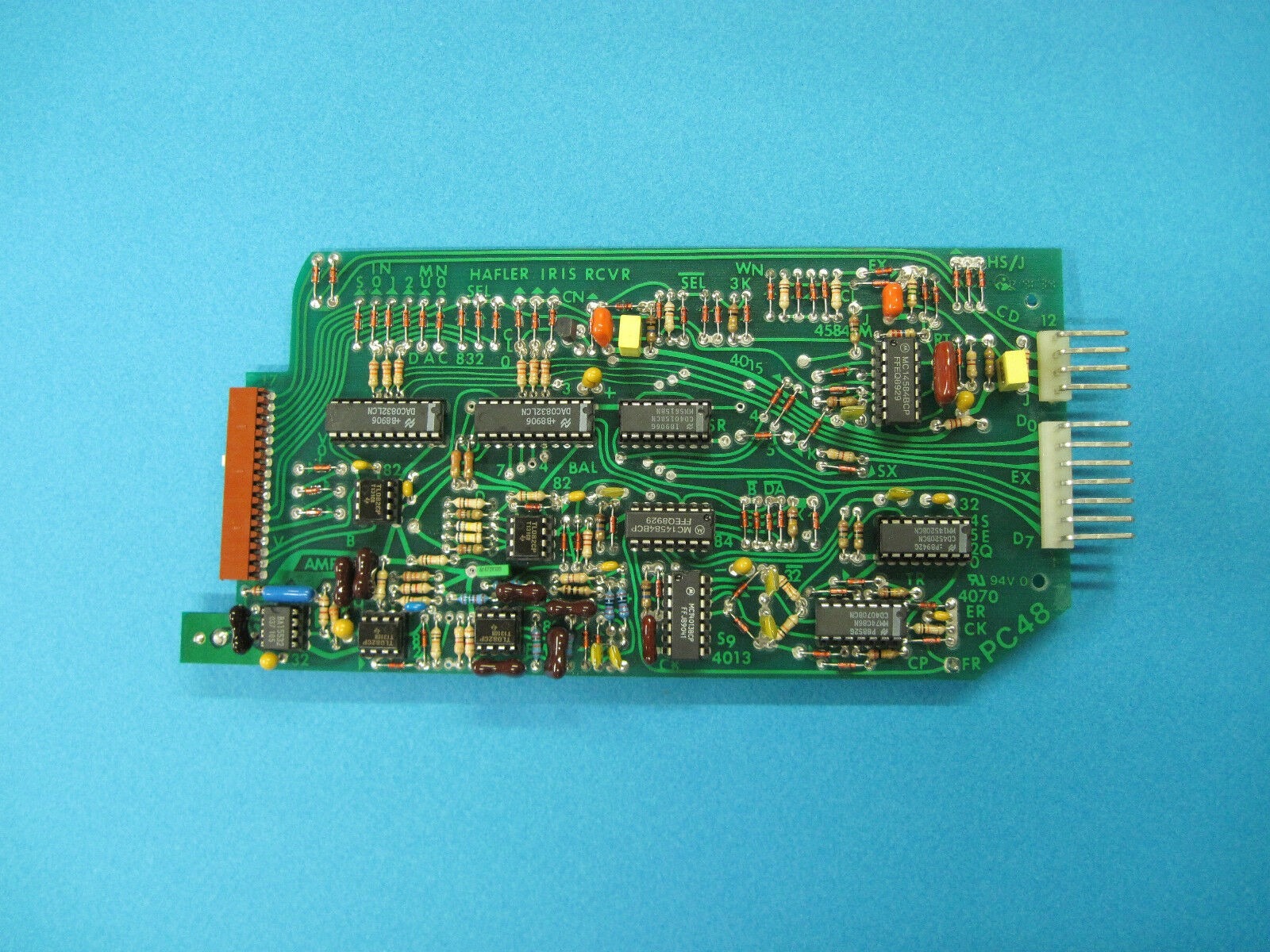

I was recently gifted a Hafler IRIS pre-amp (along with a DH-200 amp). Unfortunately it does not have a remote control.
Remotes are rare and expensive. In addition one requires the internal receiver board. Cost could be $120 or more if I could find them.
I have studied the IRIS schematic and have decided to roll my own IR remote control.

Below is what I have figured out so far regarding the interface from the IR receiver board to the pre-amp. This connector is on the back of the display panel of the unit.
In addition there is a transparent window where the receiver phototransistor would mount near the connector.

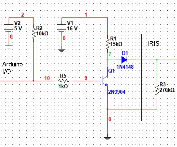

All the lines on the "MUX bus" are all pulled low via 270k resistors. My plan for interfacing the MUX was to drive some 2n3904 with the 5v logic of the Arduino output pins and these would all have 16v on the high side. Just need to make sure the rest of the IRIS circuit will still work with this arrangement when I turn off the transistors. I think I will run this in the circuit simulator to make sure.

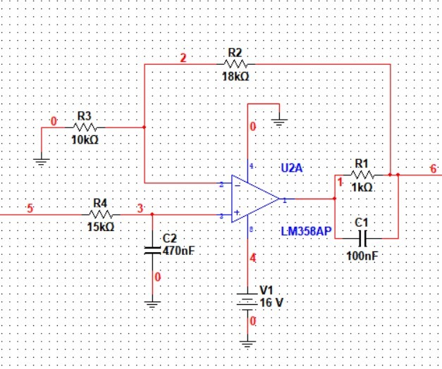

Again this is a very interesting circuit that latches state as to whether the Pre-amp volume and balance potentiometer voltages are utilized versus the remote voltages.
What is interesting is the dv/dt opamp circuit that is attached to the volume and balance pots. As soon as you turn either on the pre-amp the remote volume/balance voltages are de-selected.
It is pretty cool to see how things were done when an embedded CPU was not utilized. Everything was done with a combination of analog computing with a good dose of diode logic. The CMOS parts used are not really logic parts so much as they are latches and switches. You almost get the feeling that everything could have been implemented with relays if that was all available to Hafler at the time!

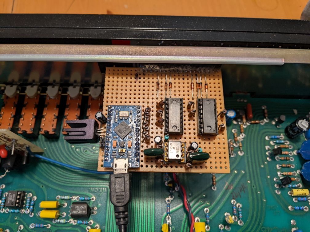

Prototype is almost done. I won't have the IR hardware for a while, but I don't need that to develop the board and the code.
Presently I have it so I can control the i/o lines through the Arduino terminal through the USB port
I will post schematics, code, and pictures shortly.

Progress and almost there...
There were a few issues and some remain.
When you turn on a Hafler IRIS it will default MUTE and then a moment later it will UNMUTE and then select TUNER as the input. It must do this with an RC time delay circuit somewhere. But I have not yet located this in the schematic. If anyone out there can see it let me know.
When I plugged in my first iteration this functionality was not occurring. I did a lot of head scratching and I finally saw a picture of an original Hafler Remote board up on ebay. From that picture I could see that they were using isolation diodes between the logic. So I installed the diodes and that fixed things.
The other problem has to do with voltage regulators. The Arduino Pro Micro has an on board voltage regulator. There is a lot of confusion regarding this regulator and bypassing it online. You can read about it but most info is wrong.
It is a low dropout regulator. When you plug it into to your PC you can power the board. I think it takes the USB 5v and drops it down to around 4.8 volts to power the Arduino.
However, when plugged into the IRIS I only have +16 v to work with. You can feed into the Arduino RAW input pin unregulated DC, but only up to 12V.
In my experience they don't even work at 12V as I have blown them in other cases.
I need to run an external regulator. So I wired in a LM78L05ACZ (TO-92 package) to the Arduino Vcc pin But now the problem arises if I want to connect my USB cable to debug while I have the board installed in the Hafler. If I did that I would have two regulators fighting each other. It took a bit of head scratching and I finally realized I just needed a jumper between my external regulator and the Vcc pin. So when I want to connect my USB cable I just disconnect my external regulator.
The other problem is that when running on 16v my little external regulator gets hot. I hooked up my DMM in milliamp mode and with 16v the board is drawing 96 milliamps. This is right on the edge of the 100ma current limit the LM78L05ACZ can handle. It is a little strange because the when running off of the USB power the board only draws about 45 milliamps (as measured with one of those USB voltage/current dongles)
As a temporary measure I drilled a hole in a section of aluminum heatsink and epoxied that onto the regulator.
What I plan to do is switch away from the Pro Micro (which is kind of overkill for this project anyway) and instead use a DigiSpark Pro.
https://www.aliexpress.com/item/32617756621.html
According to the specs the DigiSPark Pro can run off of 16v out of the box. It is also much less expensive.

On the original Hafler remote there were two potentiometers for volume and balance. The voltages across these would get converted a 0-255 digital code and sent across the IR link to the pre-amp. On the receiver board these would get converted back to voltages using a DAC.
We don't have a DAC on the Arduino. All we have is PWM output on an I/O pin. So - if we filter this PWM output we can a smoothed voltage that we can manipulate from 0-5 volts.
But 0-5 volts is insufficient for the Hafler. It wants 0-16 volts for volume and balance.
I used the following opamp circuit to convert to convert 0-5v to 0-16v. The circuit is done twice for volume and balance, A dual LM358 is utilized.
In addition, the default PWM frequency is very low on the arduino, I think it is around 960 hz. I tweaked some registers and cranked up the pwm frequency to 20khz.
In this implementation we will have 0-800 steps in the resolution of control. We only have arrow buttons for control. Supposedly there is a repeat code set when you press and hold an arrow button down. So I will probably have some special code to advance the step quickly when you hold an arrow button down and just bump it a single step when you tap the button for fine control.

Converted over to 2n3904's to interface and now overall current consumption is now down to 60 ma. So my regulator now runs at body temperature..
Below shows how I'm doing it. The 270k resistor on the right resides on the IRIS and is present just for simulation purposes. This circuit is repeated for each of the seven control lines. Note that the default state is with the arduino i/o line pulled up to 5v. This means the transistors are turned on in the default state and the logic level is low behind the isolation diode.

I was looking further at the photo of the IRIS original IR receiver board (attached below) and I notice two things that I have not implemented.
1) They have 22k resistors in series and before the diodes for the MUX lines.
2) They diode OR'd the MUX lines into the SELECT line. So if any MUX line goes High the select line goes High.
I will add the 22k resistors as an experiment.
But I don't believe the diode ORing is needed since I am activating this line correctly in software (not to mention I can select all other inputs correctly). In addition, I don't how this handles the case when TUNER is selected and and all MUX lines are low. If you look at the PCB you can see the select line is also routed elsewhere on the board so maybe this is how they handle that case.
The only thing I could think of is that since I am activating each I/O line separately in the code (and hence a tiny delay between each activation) that there is a fast race condition occurring somehow. In this case maybe the OR'ing with diodes may help. I guess I can try that.
